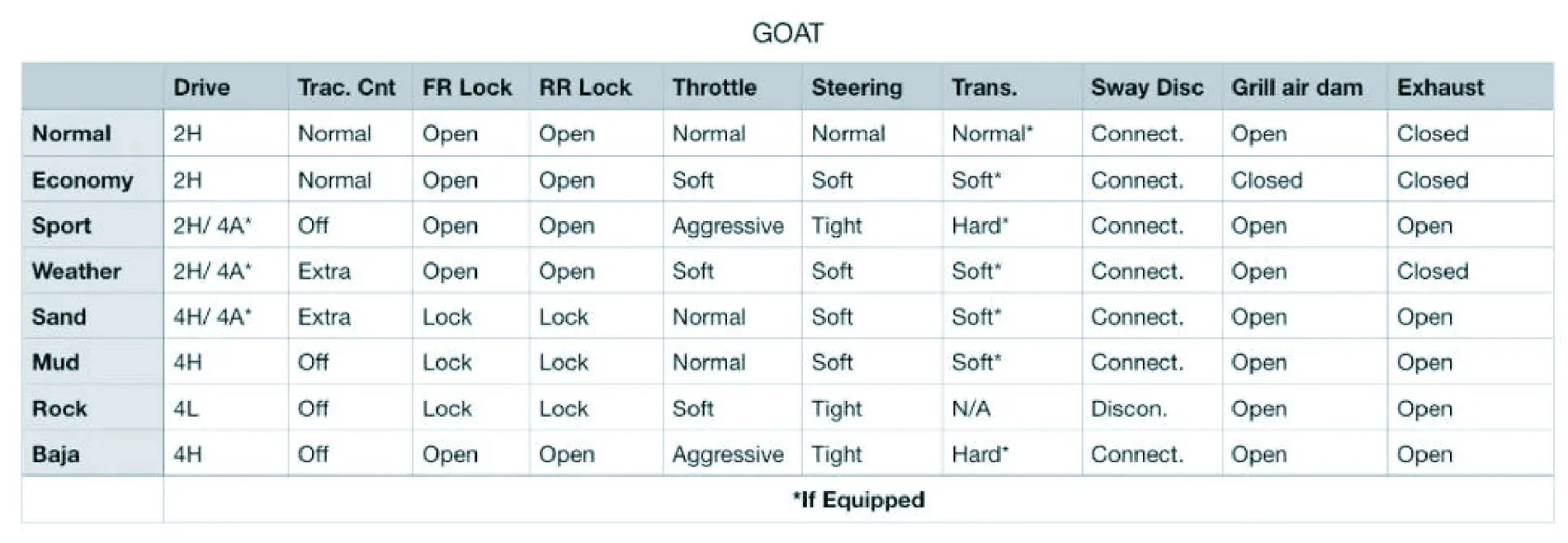

I think Sierra may be looking for this:
Ford Bronco How often do you use electronic stabilizer bar disconnect goat modes
Thanks. Not sure where that chart comes from, but looks reasonable.
Per the chart, MUD = similar throttle response as NORMAL, softer steering, and softer trans (delayed upshifts). That seems to be what I experienced between MUD and NORMAL.
Also per the chart, ROCK has softer throttle response than MUD, but ROCK actually has MORE responsive steering ("Tight" vs "Soft") - maybe makes sense since you're typically moving slower?
Features like 4H vs 4L, lockers, tract control, and sway disc can all be separately changed once in a GOAT mode. Even trans can be set to manually shift. When I go to MUD mode I'm typically switching it to 4L, disconnecting sway bar, and turning off lockers until needed. So, compared to ROCK, I'm getting slightly less soft throttle response, and much softer steering. Meh

One more thing not in the chart... "Brake Over Accelerator" is disabled in all off-road GOAT modes (Sand, Mud/Ruts, Rock, Baja)...important if you're doing left-foot braking to help control throttle response when crawling.

My understanding of “Tight” is that the rack isn’t giving all the available power, whereas with “soft” you get everything it’s got. Saves the rack from breaking when in the rocks.

Ah ok...I just noticed that Sport and Baja are also 'Tight' to offer similar slower response ('tightness') at speed, which makes sense. I apologize for my confusion :crazy:.
I'll just have to be gentle with the steering in MUD mode on the rocks, or finally cave in and get Forscan.

As usual, lots of great info. Even a chart on goat mode settings (y)
