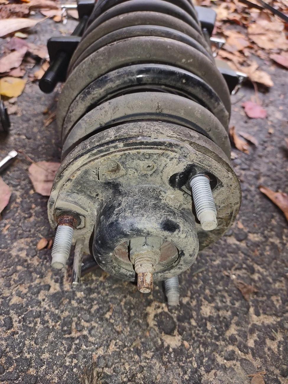

How do I remove the strut top hat?
Techun
Jul 28, 2020
1,500
3,242
Pa
BD, 2.7, MIC, 4dr
The nut is recessed in the top hat...what tool do I need to hold the strut piston and loosen that top nut at the same time?
(I have a spring compressor to remove tension)
Techun
Jul 28, 2020
1,500
3,242
Pa
BD, 2.7, MIC, 4dr
Ford Bronco How do I remove the strut top hat? IMG_20251020_123532811

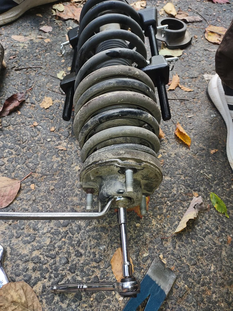

No luck yet today. That earlier pic offset wrench was slightly too big. Had to order an 18mm offset wrench, don't seem to exist in my local stores. What a PITA this is becoming.
Also removed the rear lower shock bolt by hand 💪. That was... difficult.

A vice grips holding the shaft with a rag to protect the shaft is what I had to do. If you have the right tools (offset wrench) you should be able to key an allen to hold the shaft

You are probably going to need some heat on that nut. Be careful not to ruin the rubber in the hat.
It's not an allen like many others are. It's a 5/16ths post and the nut is recessed. I hate it :)
Thinking back your right. Still the same though, had to use a vice as I didn't have an offset wrench
