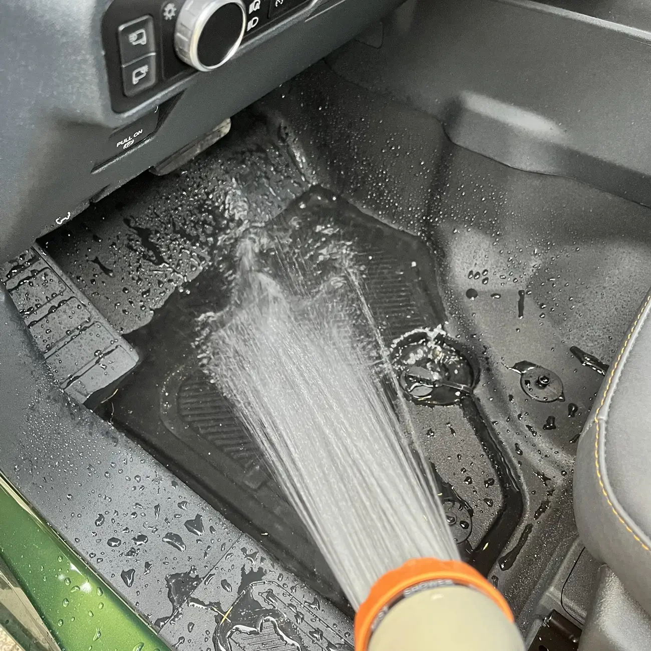

Well...
Even if you have the washout interior, I wouldn't just go hosing it down.
The door sills on the side have a lot of wires running through them. The seats have seat belt indicator wiring and air bags/air bag sensors and maybe even heat. And it's pretty easy to get a bit too wild and get up around the dash, or under the steering wheel where the BCM/OBD stuff lives.
Apart from wiring, which ~should~ be ok even if it gets a bit wet - water will get down under the liner if you are going crazy with the hose.
My dogs barf and crap in mine too.. it's annoying. And I have had to pull the seats on a couple of occasions. I did put a washout in mine (after the fact) and vinyl seat covers. I have no problem getting a bucket of soapy water and a brush and going to town and letting what accumulates go down the drain, but I wouldn't just go grab the water hose. It's still orders of magnitude better and easier to clean than the carpet was.
Same thing applies if you decided to try to ford the Pacific Ocean or something - if it gets flooded out, I would still want to pull everything to let it dry out, even with the washout interior.
