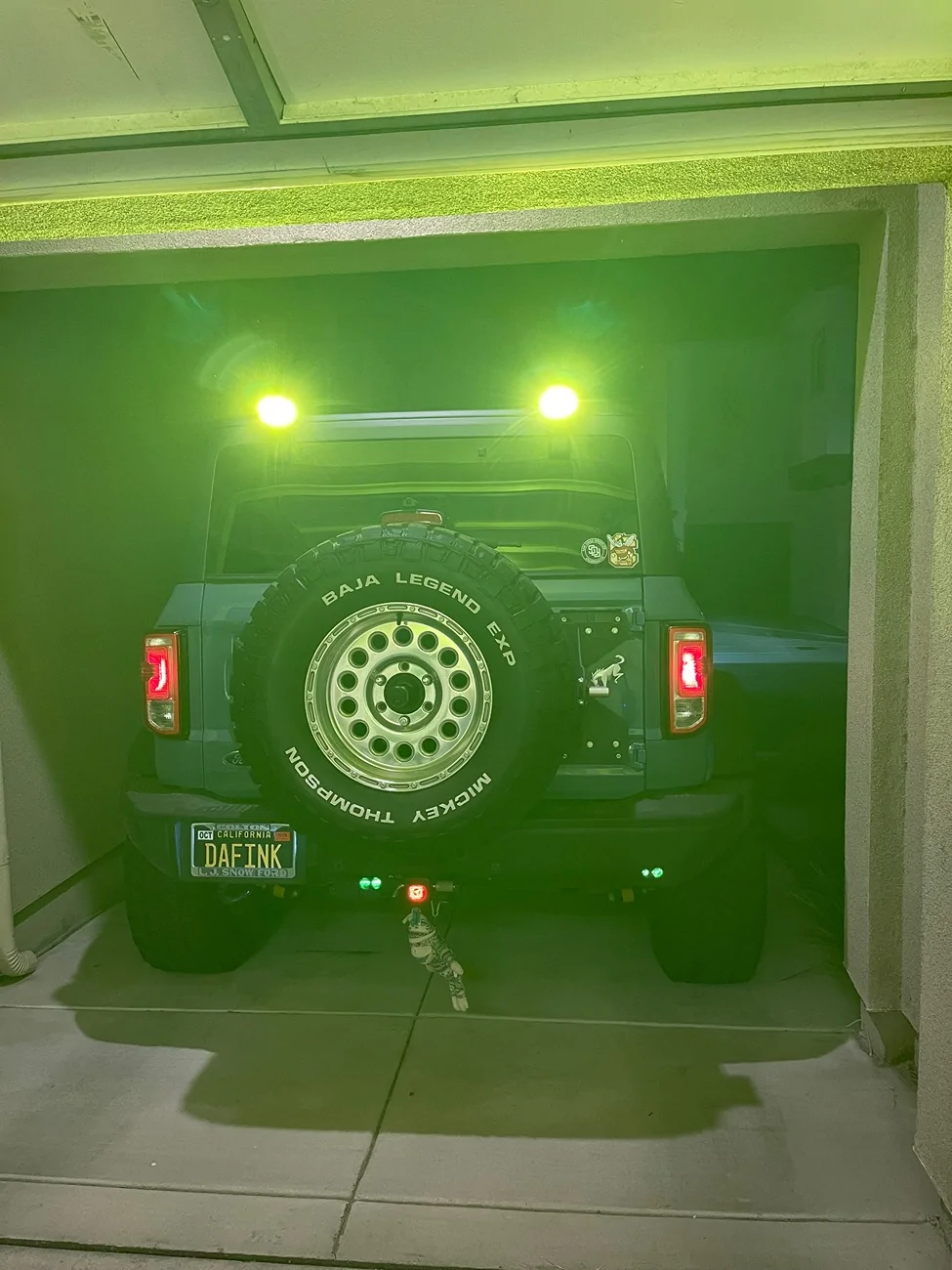

Has anyone installed any S2 lights on their hardtop hinges. I'm looking at this set from Turn Off Road (https://turnoffroad.com/products/2021-ford-bronco-oem-hard-top-hinge-light-bracket) and will probably use some Diode Dynamics lights. I'm curious to know how people have installed them. Where are you wiring them to, and how are you unplugging them when removing the roof.

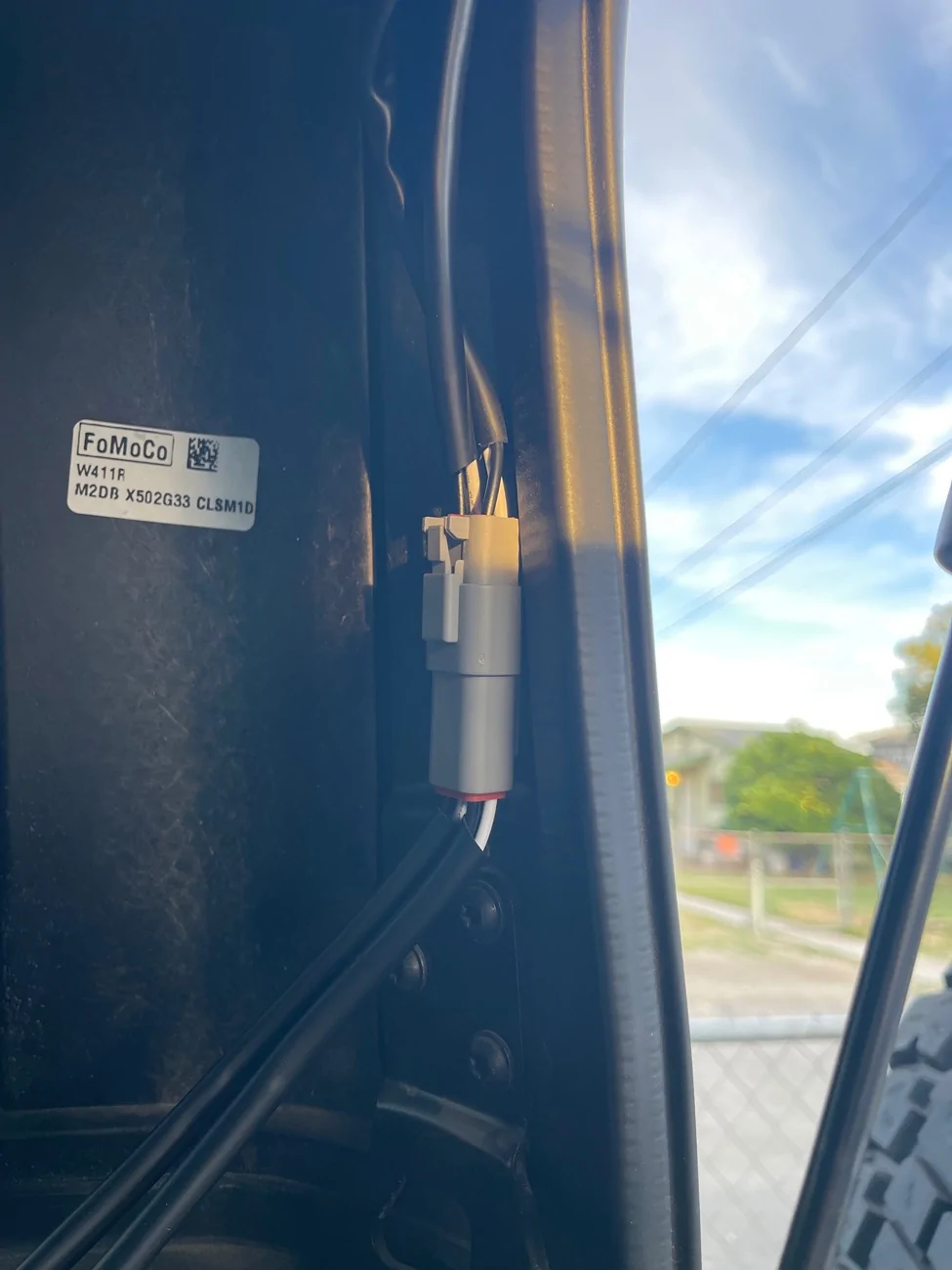

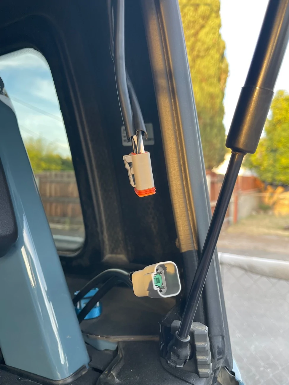

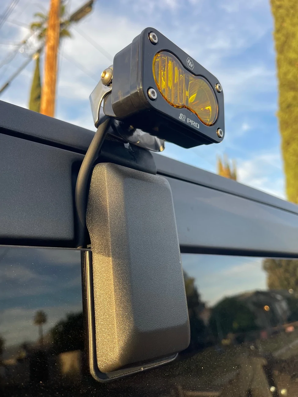

Hi OP. I did this very mod a couple of weeks ago. Used S2 lights mounted on @Turnoffroad hinge brackets.

I opted to route the wire down the outer side of each hinge and went under the weatherstripping. Joined both light pigtails into one connector and used the ground behind the passenger side panel. Used a Deustch connector to be able to disconnect lights and remove the top.

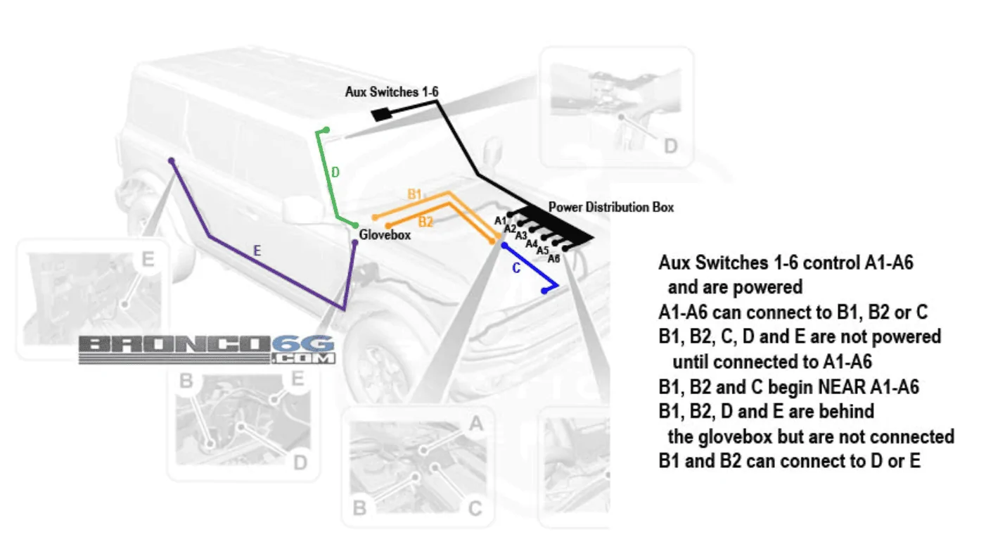

This wiring diagram was extremely helpful. Pic of my Bronco with lights freshly installed.

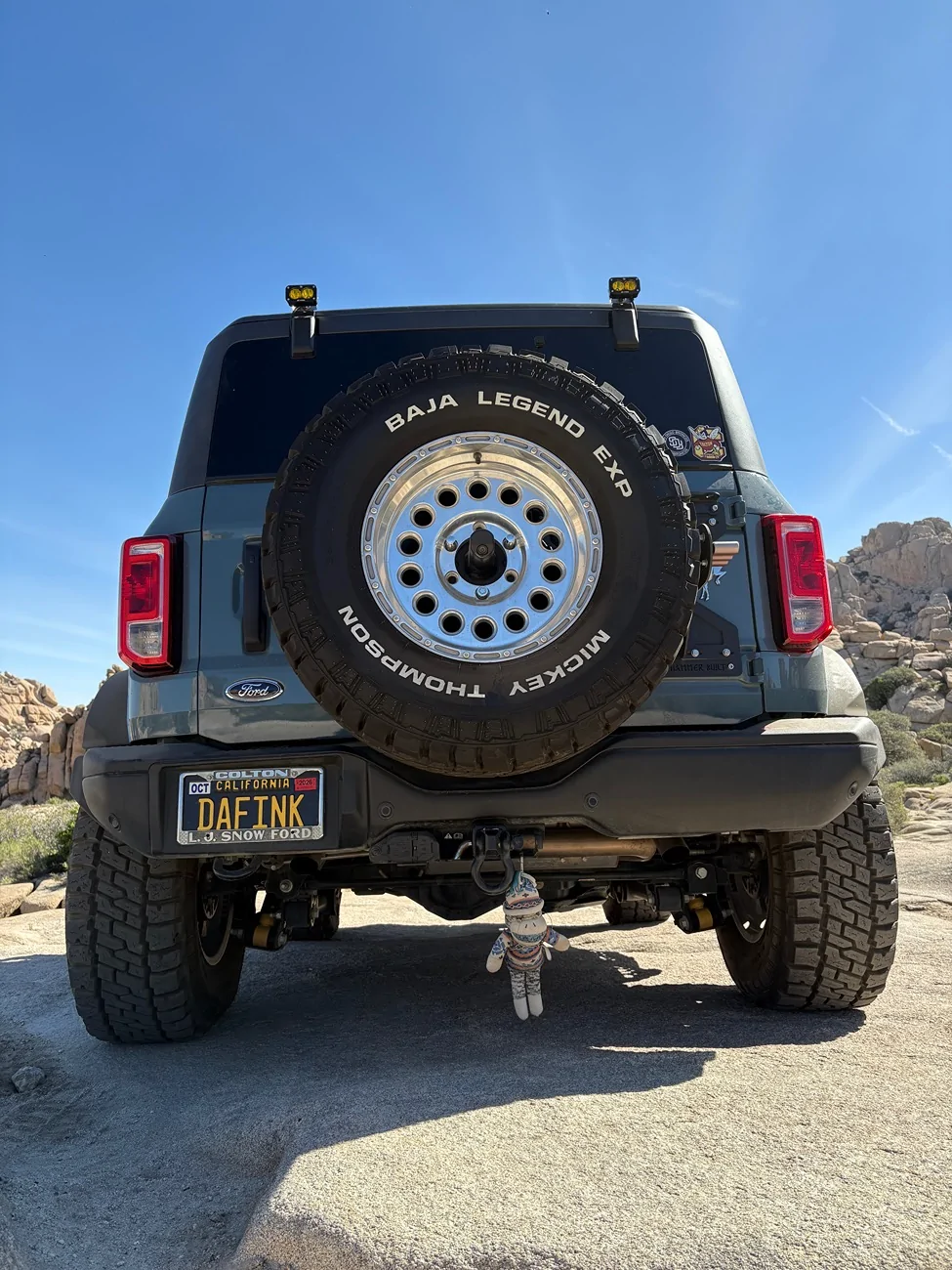

Here’s my Bronco during a wheeling trip last weekend. Lights held up just fine and did not loosen up at all.
FYI you won’t be able to use the hardware provided with the S2s (bolt is too thick), but the hardware provided by turn works just fine. I had to add a washer because like a dum dum I tried to use the thicker bolt and drilled out the slot on the bracket.
Ford Bronco Hinge Lights IMG_1223
