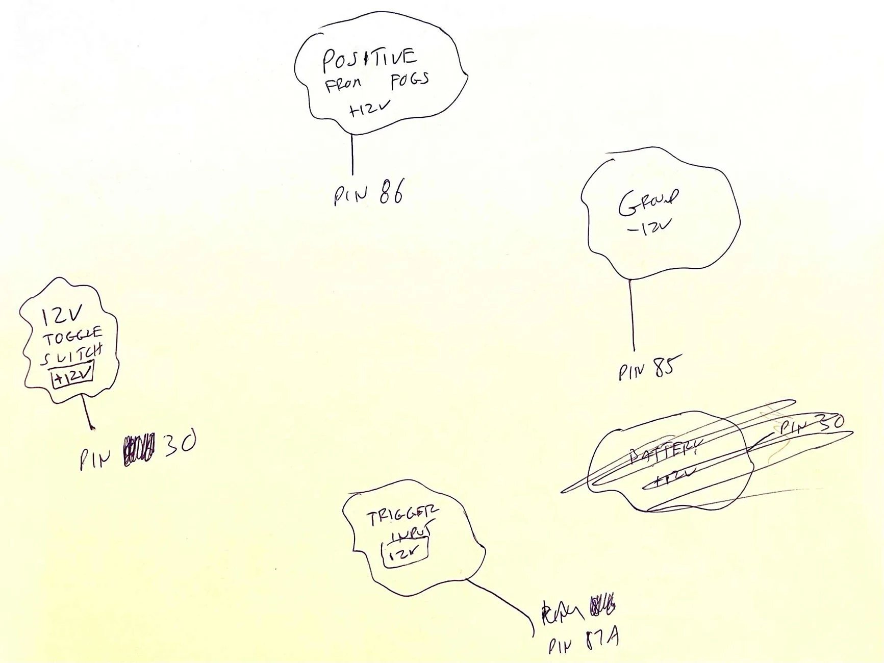

here is my back of the napkin math... i THINK this will work. I'll test it tomorrow at the shop
PIN 30 on the relay for me is going to an UPFITTER for you guys (in my case, an actual d-switch button)
PIN 87A on the relay for me is going to a LIGHT for you guys (in my case, it's going to the D-Switch INPUT which listens for 12V signals and then it'll turn on whatever lights i want)
UPDATE:I also did not see sierra's post earlier. I read the last post and responded to the last post, not having read any previous posts

As i wrote it I said "no dont' do that" but then as i was writing Im like "well ya know what that gives me an idea" only because I have a D-Switch sooo I don't actually need to power my lights from the relay. I can just send power to the D-Switch's INPUT and then the "logic" built into the d-switch will turn on whatever i want.
I just didn’t want to deal with any kind of modules and stick with 12V to keep things simple. Using the fogs as a trigger has worked out really well (as long as I have the master power off during the day)

SUCCESES! Works great.
I have a Diode Dynamics D-Switch installed on my truck but these same instructions can work for you using the upfitter switches as your "arm/disarm" and instead of the TRIGGER wire I used (D-Switch trigger) you'd just connect your off-road light. You will either need existing fog lights OR have enabled the fog light circuit (mod bumpers), as you need the +12VDC trigger from the fog light circuit to activate the system.
Using a SPDT Relay (5 posts)
#30 goes to D-Switch Output (OR an upfitter OR a switch, this activates/deactivates the entier system)
#85 goes to Ground (-12VDC)
#86 goes to Fog Light +12VDC line (I tapped into this)
#87A goes to D-Switch Trigger Input (OR your off-road light)
So essentially when the high beams are turned on, the fog lights turn off automatically. The relay (when activated via my D-Switch button) will see this and sends power over to the D-Switch input trigger. The D-Switch sees the trigger activated and turns on the off-road lights.
However, if the relay is not activated (via the D-Switch button) then turning high beams on normally just turns fog lights off and nothing else happens.
This will prevent "false" activations (driving under a bridge and the low beams turn on but fogs don't OR the windshield wipers activate the lows without fogs) as sometimes that can happen (where lows turn on but fogs are not).
It also allows me to (why I'd ever do this) turn my fogs off without activating the off-road lights.
However I can enable the system by pressing the D-Switch button which essentially "arms" the system. Now if the fog lights turn off, the off-road lights turn on.
This works out well, as I normally don't use high beams in my daily travels (or at least to the point I need the off-road lighting). But if I plan to be on a backroad somewhere and will be turning high beams on/off I can simply arm the system once and now I don't have to think about it or worry about blinding someone. As it was annoying to keep reaching up to my buttons to turn off-road lights on/off as I drove down a road.
