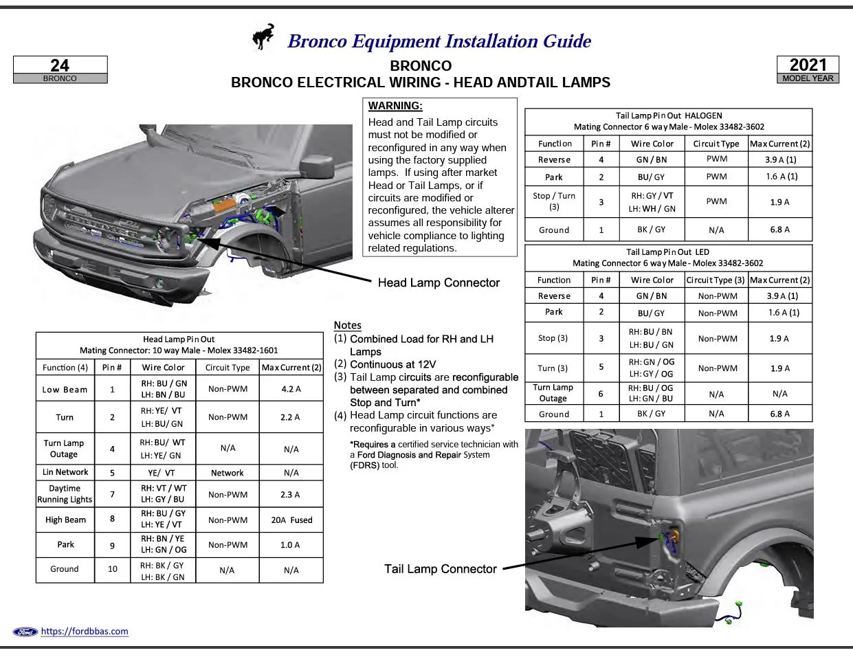

Taken from the SEMA install guide book for a 2021. Probably the same through ‘23. Can use park or drl wire as a signal for a relay if needed. If you want the easy way, probably some adapter harness's out there as stated above.

As for the harness option, the red wires for your grill lights will need to be bundled together and all tied to the end of that harness. That's the power circuit. Then all the black wires for your grill lights need to be bundled together and tied to a vehicle ground screw or terminal. That's your ground circuit.
With either of these options, your grill lights would only run when your headlights or parking lamps are on (so basically automatically at night). They would not be "always on" and running during the day along with your DRLs.
