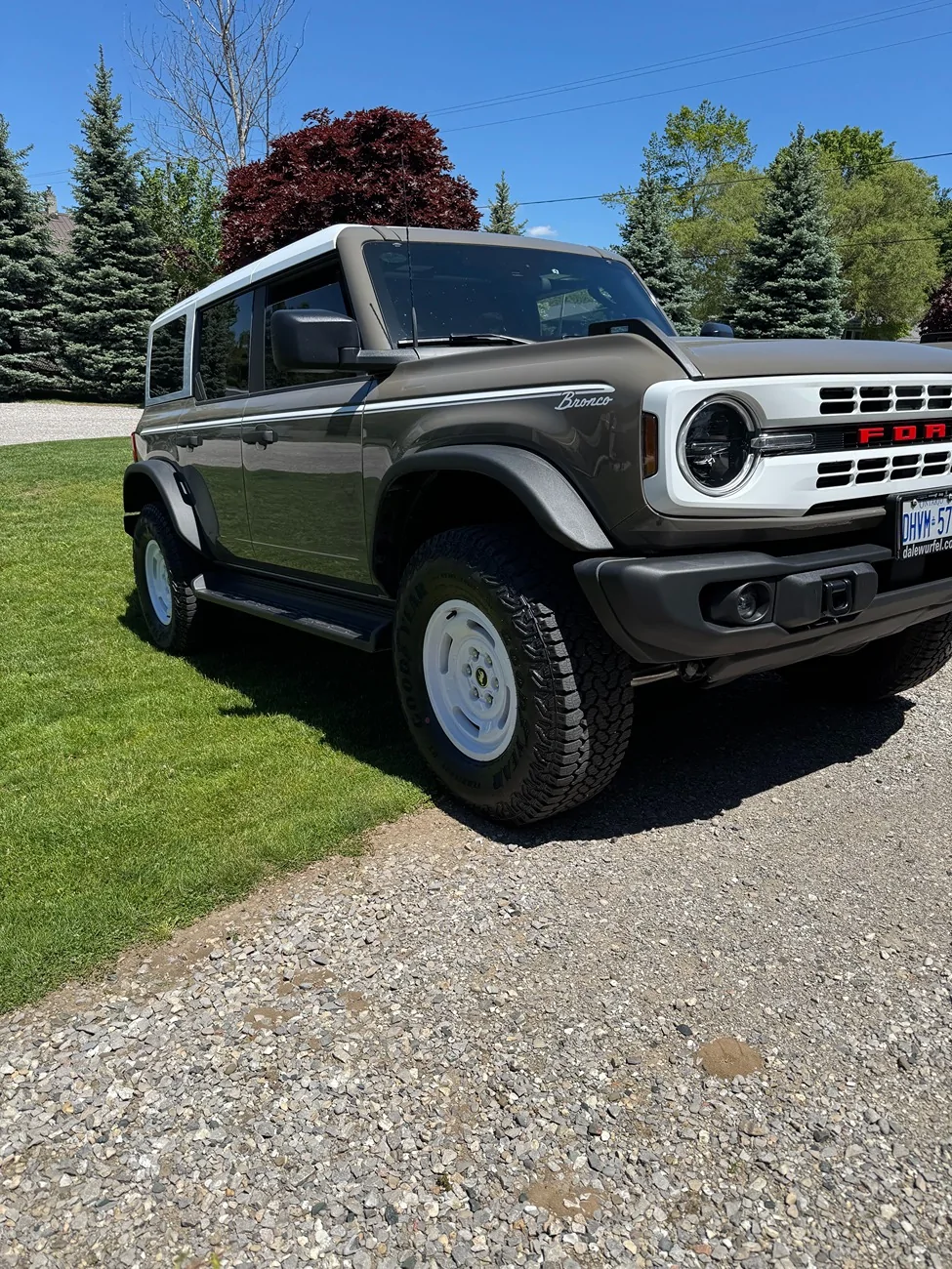

Hi, I know there has been many threads on tire sizes on different trims, just curious if anyone knows if you can replace the stock 35's with 37's on a completely stock heritage model, just not certain if the wider wheel openings and non modular bumper plays a factor on this.
I'm not against a mild lift but I feel like the stock sasquatch package it came with was fairly stout to start with and don't want to add any more height than what's necessary for mild off-roading in Ontario.
After owning it for a week a feel like a leveling kit might be a good idea regardless...
Also! Be sure to notice the giant rock chip in the windshield of my new Bronco! I mean it's basically a formal welcome to Bronco ownership I believe...lol
Ford Bronco Heritage on 37's? IMG_5021
