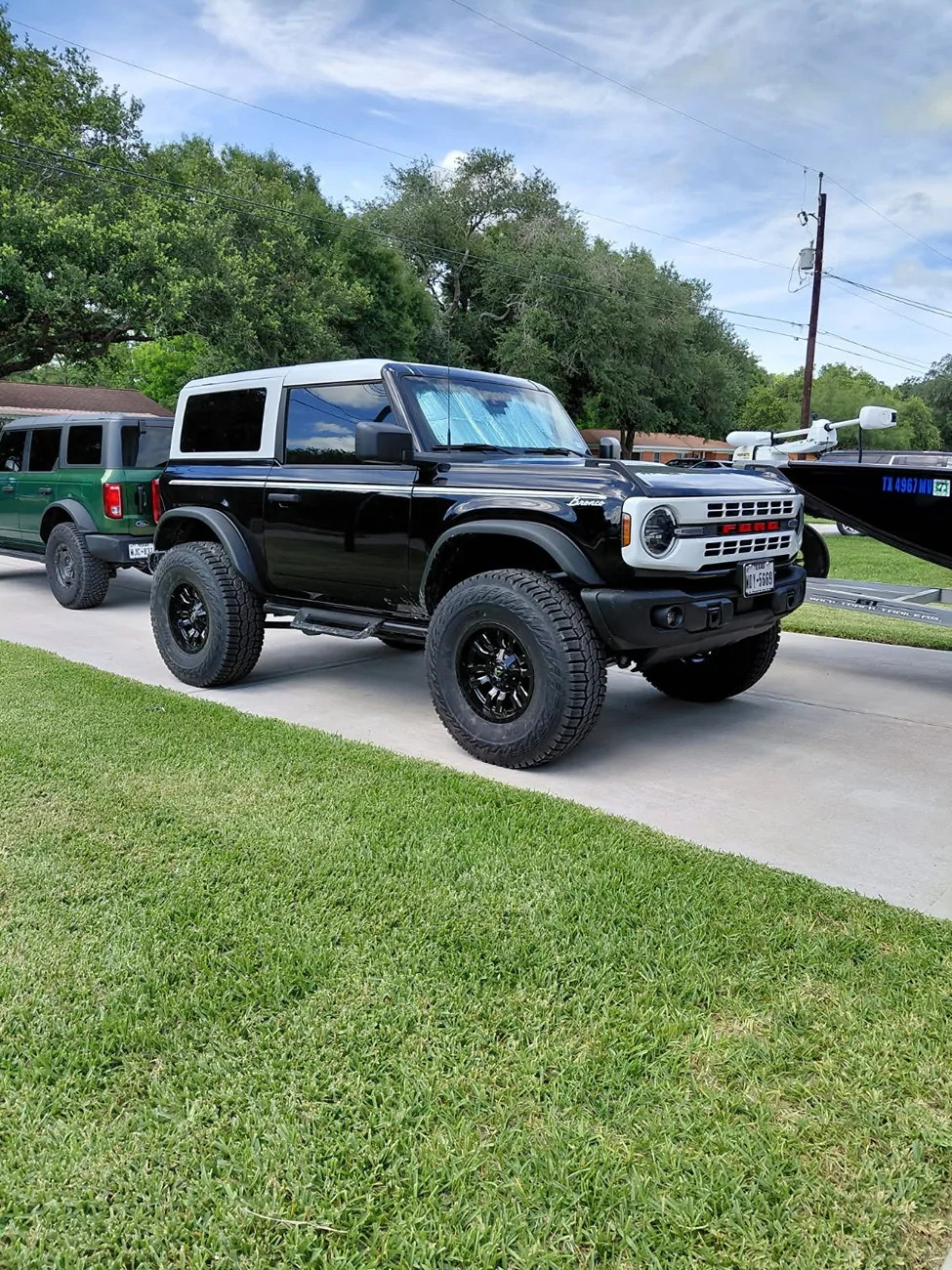

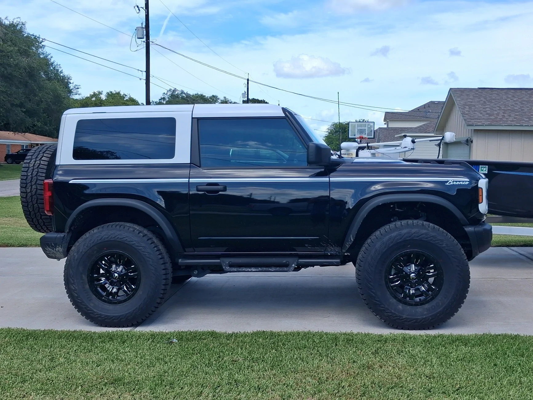

Just put 37s on my wife's Heritage Edition. You will definitely need at least 2 inches to clear them. Even then certain 37s are going to rub.
We went with Zone 2 inch level kit (2 inch front and 1 inch rear),
Ford Bronco Heritage on 37's? 224
Ford Bronco Heritage on 37's? 229
Hankook Dynapro XTs which are a smaller 37 on Fuel Sledge 17x9 with -12offset. The plastic block behind the fender liner had to be removed. The tires also rub the plastic trim on the capable bumper. Very close to rubbing the crash bar mounts as well. Not concerned about trimming the crash bar mount since we do not go offroad. Attached are some pictures.
