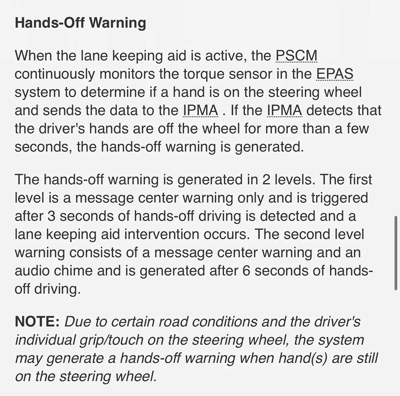

Yes normal. It senses steering input, doesn’t have a sensor on the steering wheel.
If I touch the wheel at 10 or 2 o'clock it halts the message. I usually catch it even before the chime goes off. There are definitely sensors at those positions.
But there aren’t.

"The 2025 Ford Bronco (and Bronco Sport) uses various sensors, including touch/capacitive types, integrated into its driver-assist systems for features like Blind Spot Monitoring (BLIS) (which can tug the wheel) and potentially for hands-free driving (BlueCruise), though BlueCruise is on specific models/packages, requiring hands on the wheel in hands-free zones and often using cameras/radar for lane centering rather than just steering wheel touch. Expect digital displays showing sensor activity, especially for park aids or off-road obstacle detection, depending on your trim."
I can literally change my hand position on the wheel without turning or moving the wheel and turn off the sensor by touch at the 10 and 2 o'clock positions.

Don’t know what to tell you, these vehicles dont have it. If you look at any of the aftermarket wheels available they dont have sensors.

There are no sensors in the steering wheel, nor does the Bronco have blue cruise.
Ford Bronco Hands on Steering Wheel Message IMG_9404
Oh man. I’ve always thought maybe I had a bum steering sensor. I’ll try shaking the wheel from now on. It’s super annoying.
Then I have no idea why doing what I do fixes it. I drive at 9 o'clock usually just with a few fingers. If the warning appears on the screen, I place my hand at 10 o'clock and it stops. Are you saying the wheel detects the adjustment without having to move it and without having sensors in it?

The wheel doesn’t detect anything. The torque sensor in the PSCM does. You may not think it’s detecting anything from a small hand adjustment, but it can and in your case likely is.
Ok cool. I appreciate the info. I'm going to disable it just the same. Its annoying.
