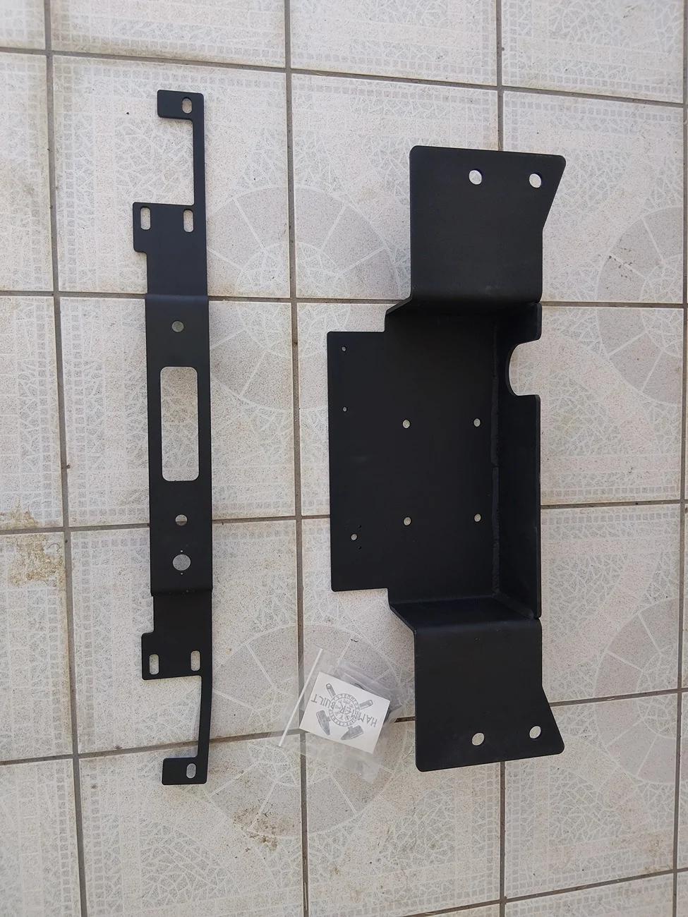

Over the next few days I'm going to install a Hammer Built winch mount. That also includes a Milemarker winch, and Mishimoto high intercooler and charge pipes. This is going on my 25 Badsas with 2.7 and lux package.

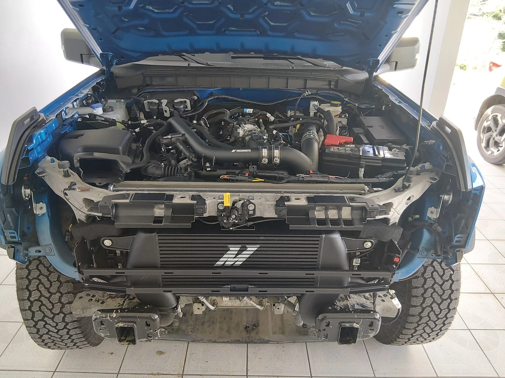

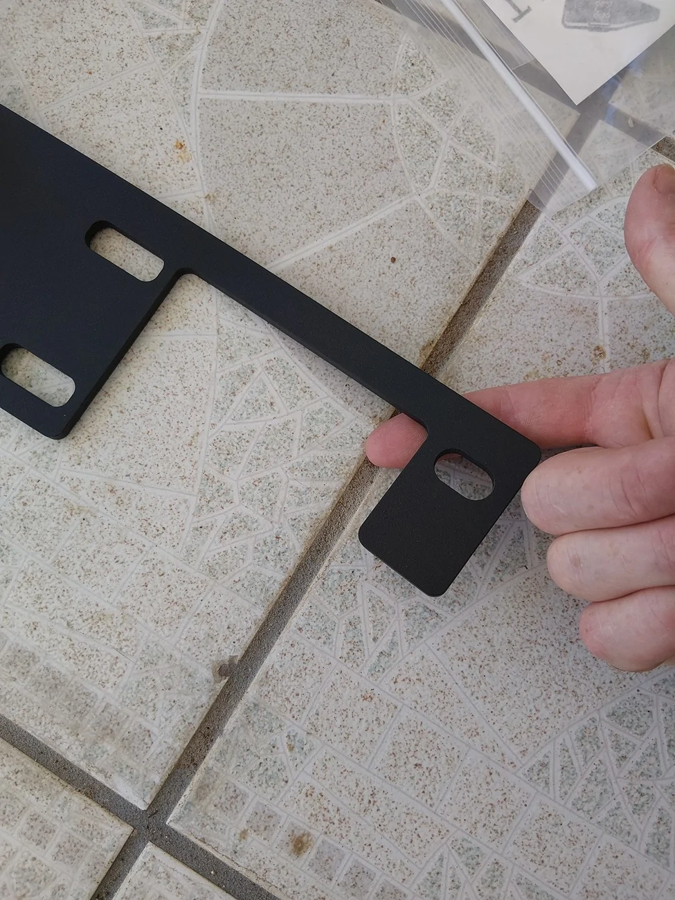

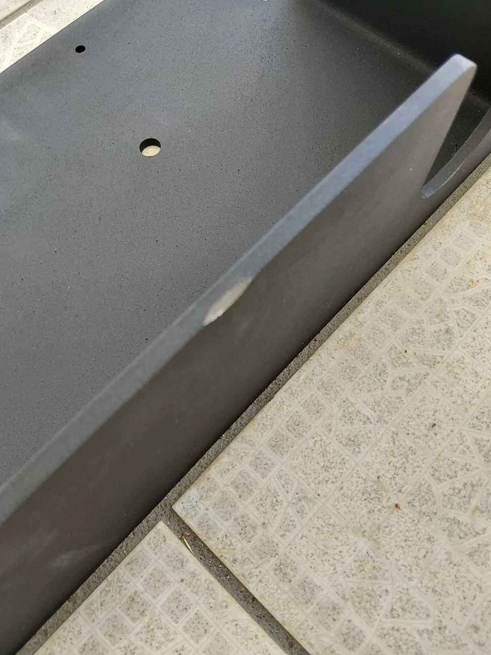

I just unboxed everything and was preparing to paint the Hammer Built brackets. I was surprised to find they are powder coated. I was not surprised to find they were damaged in shipping. They were wrapped well and put in a box that was very big with some brown paper as packing. I placed the bent part in my trailer hitch and straightened it easily and I will touch up the other damage with black paint.

Yes. I'm sick with a sinus infection so taking many breaks. So far I removed the radiator cover which required me to remove the air cleaner cover.
I removed the grill which sounded like it was breaking, but was fine. Same thing with the fender flares.

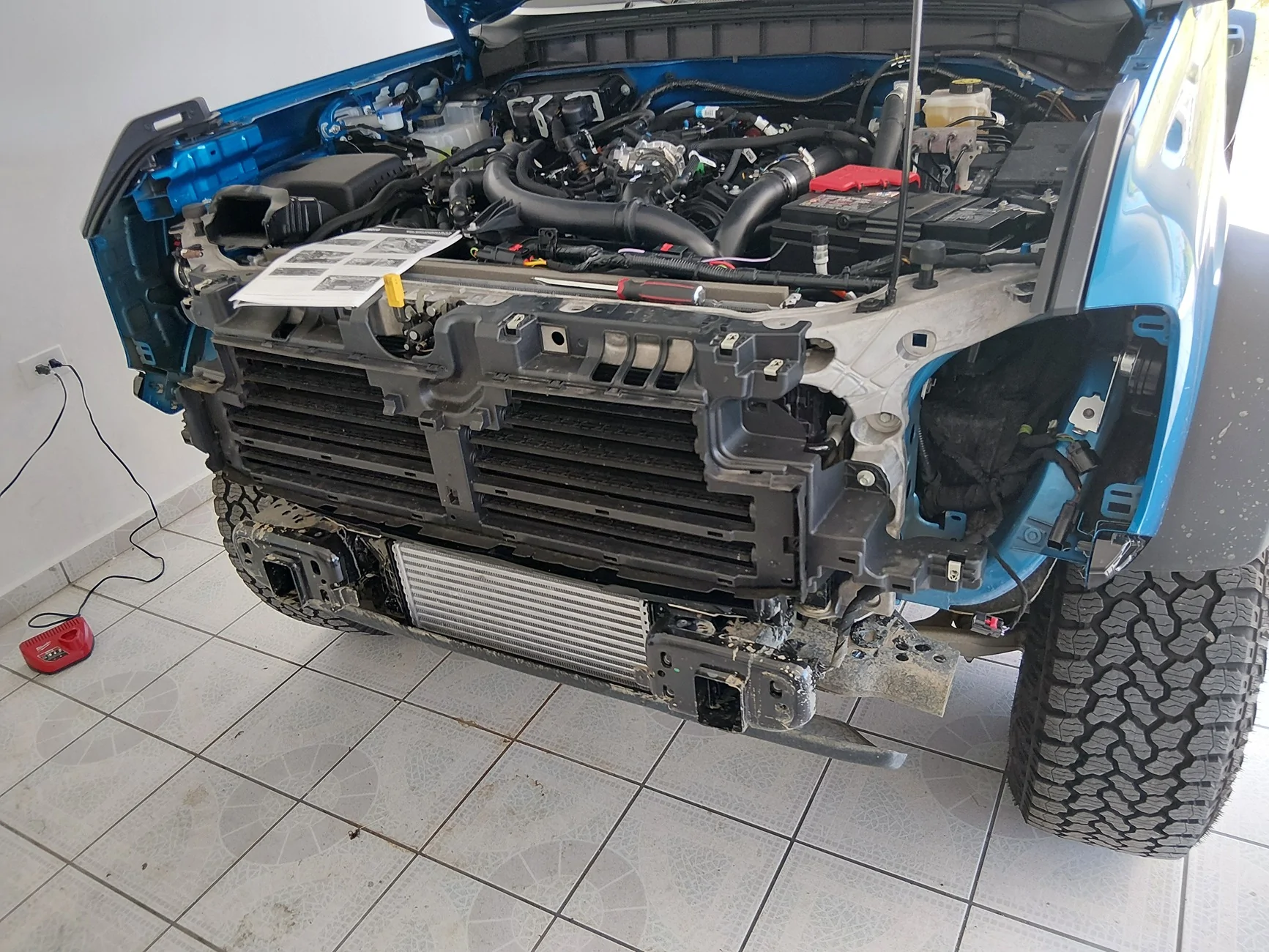

So far so good. It was difficult to get the plastic caps off the bumper. There was nowhere to get my fingers in. I used a big flat head screwdriver just under the edge and yanked and it popped off.

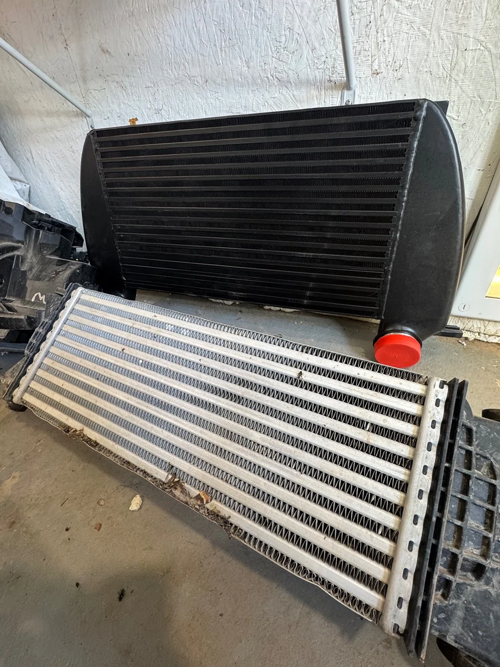

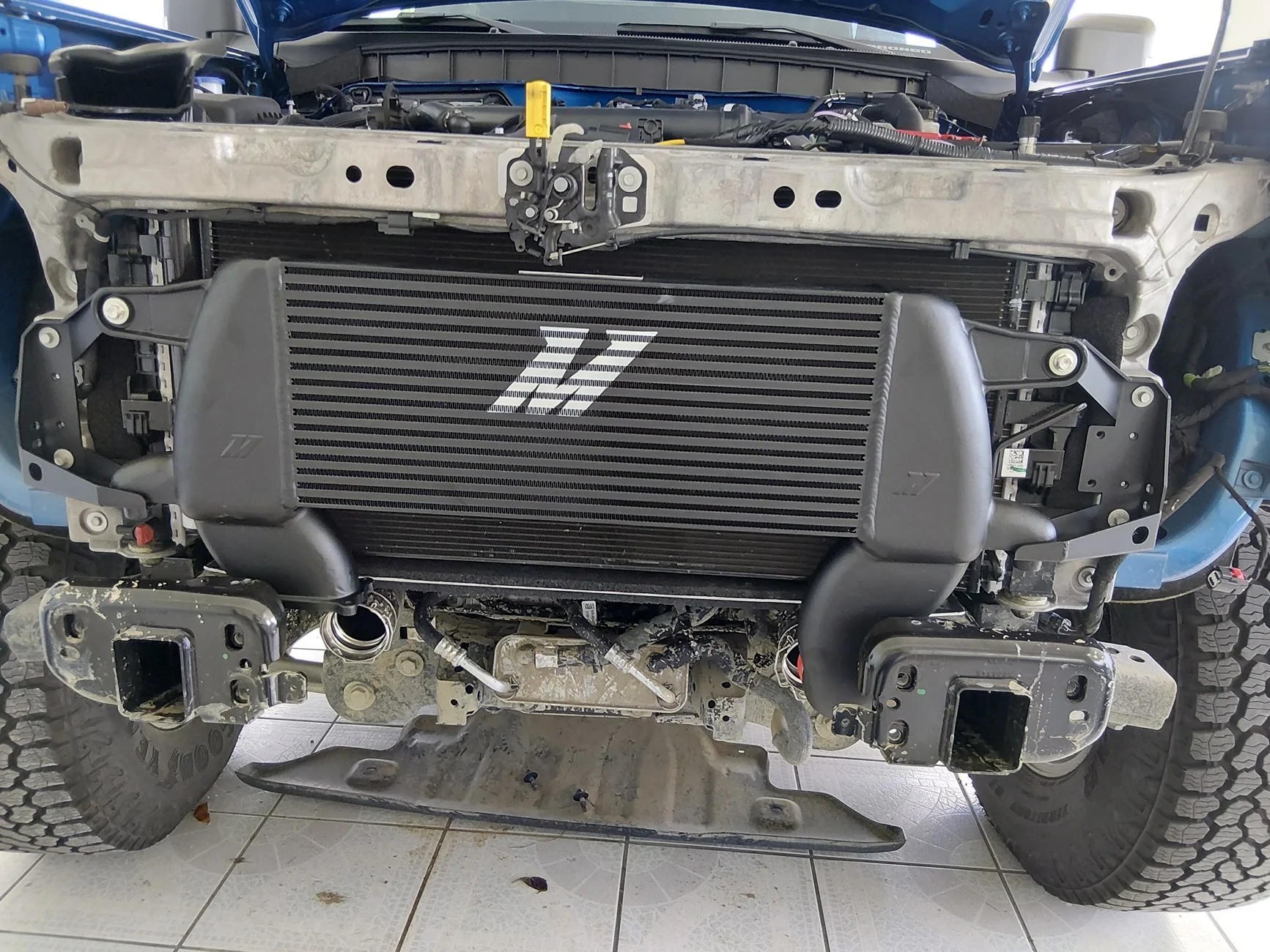

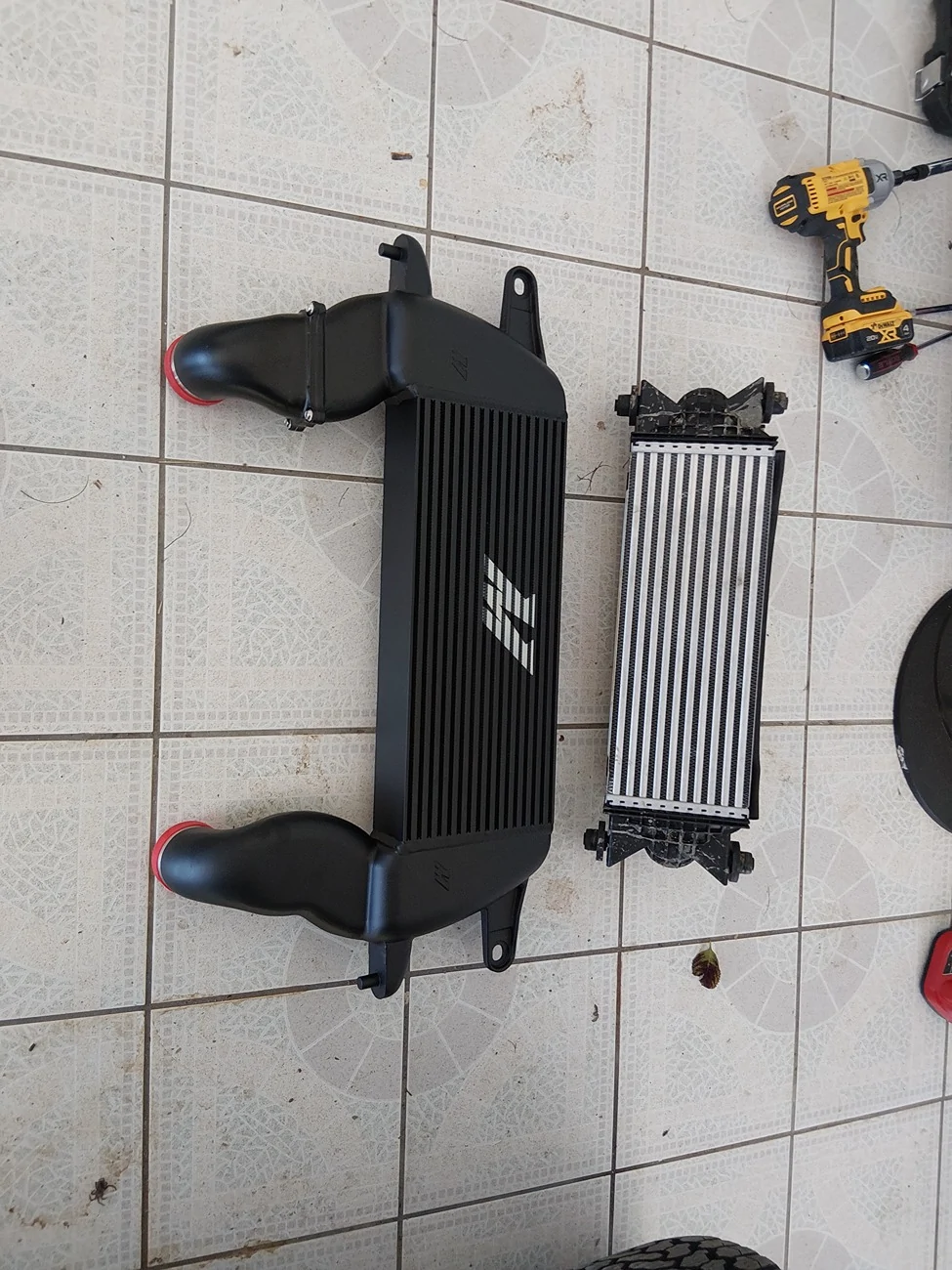

The difference in the intercoolers is pretty significant. I will say the Ford is thicker though.
Ford Bronco Hammer built winch mount 20260502_124627

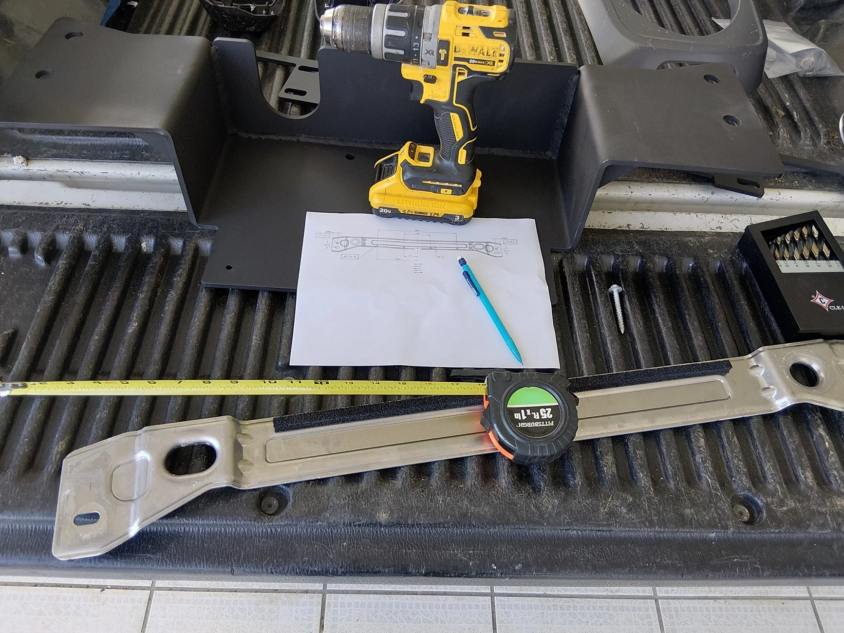

Drilling these holes is pretty annoying. They want me to be accurate to 24.8mm and my eyes and tape measure aren't that good. I was able to remove the foam strip without a heatgun.

The directions say not to put the two bolts for the original upper intercooler mount in until after you mount the new intercooler. That makes it much more difficult. I would recommend to install them before mounting the intercooler. Also the 6 holes you drill are not super critical on the precise location.

This only matters if you are installing the charge pipes also. I had to get creative. The instructions said to loosen the 7mm hose clamp.

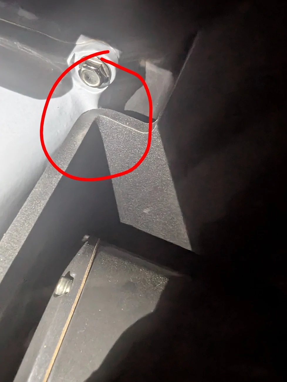

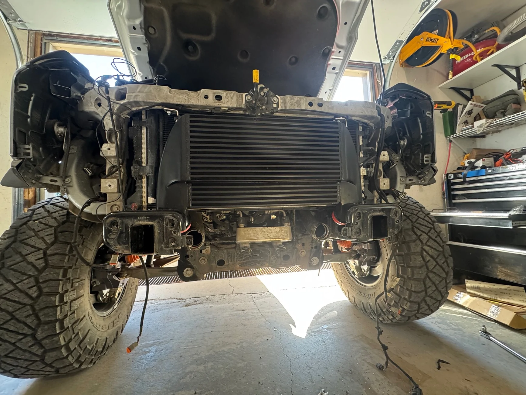

having done this recently, I'll be wondering if you run into the winch mount rubbing against the inner cooler like I did. I left it as is as it doesn't seem to cause any issues thus far
I did a quick test fit and it looks like it will interfere slightly. I'll cut it or use spacers if needed.

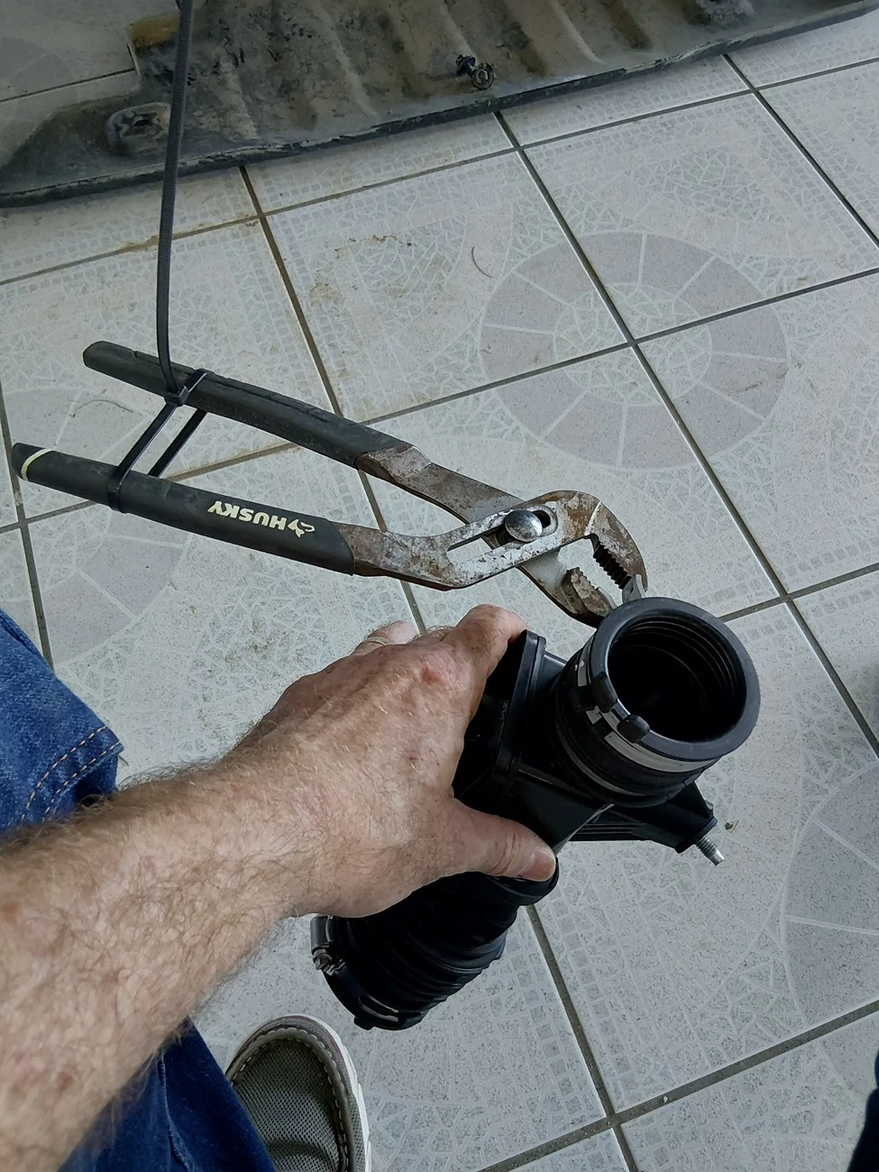

One note, the charge pipe kit does not include pipes from the air filter to the turbos. That one I had to zip tie channel locks on didn't even need to come off.
Also I am very surprised how many extra parts I have. The instructions said to skip several steps since I don't have the modular bumper, so I'm guessing some of those parts are related and some are because I ordered two kits instead of just the one.
