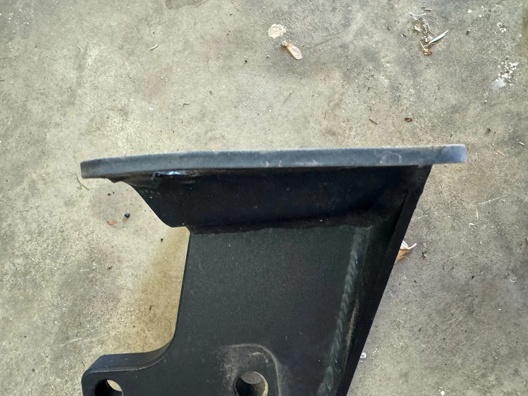

100% you will bend the mounts if you winch anything at a downward angle. I have this winch mount sitting in my garage for this very reason. The much cheaper Rough Country mount has been amazing.

Yes I have changed my mind. I bent the hell out mine to the point it blocked my front sensor.if anyone is near north Alabama and wants a great deal on winch plate let me know.

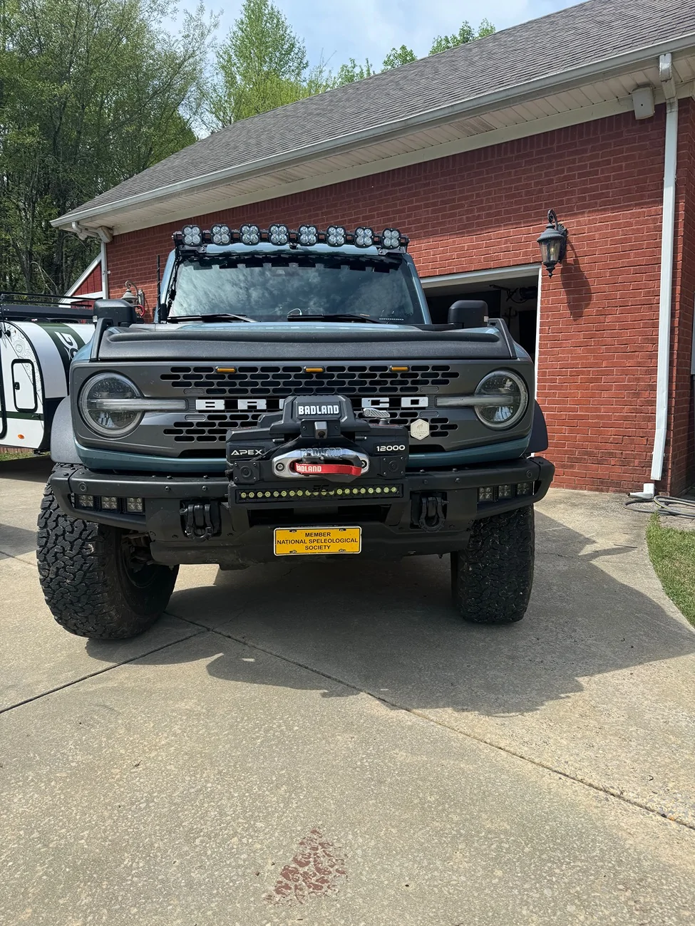

I don’t have the horn braces. Nothing on the RC winch or the Bronco has bent and I have used my winch 30 times at least since I changed mounts. I off-road a lot all over the country. I have 97k miles on my bronco. We use it and need reliable equipment.

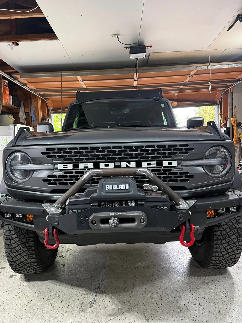

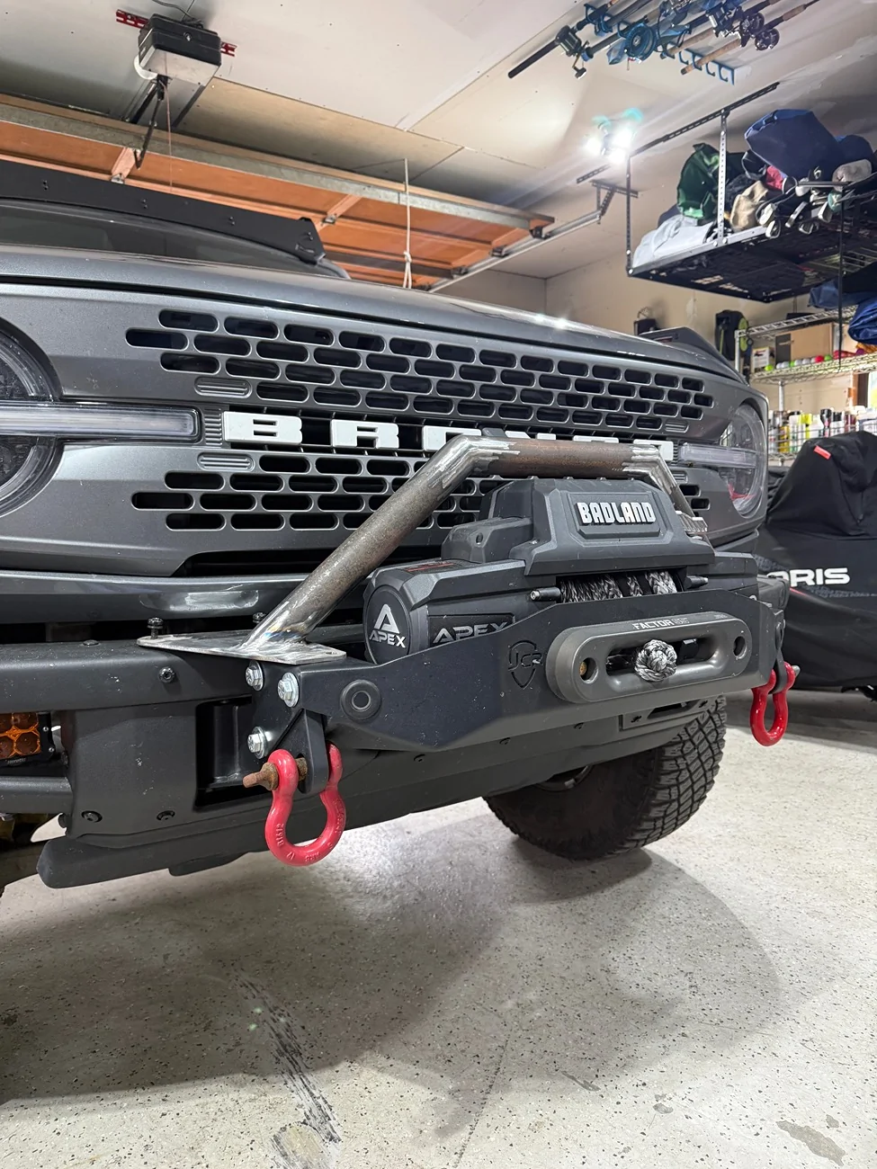

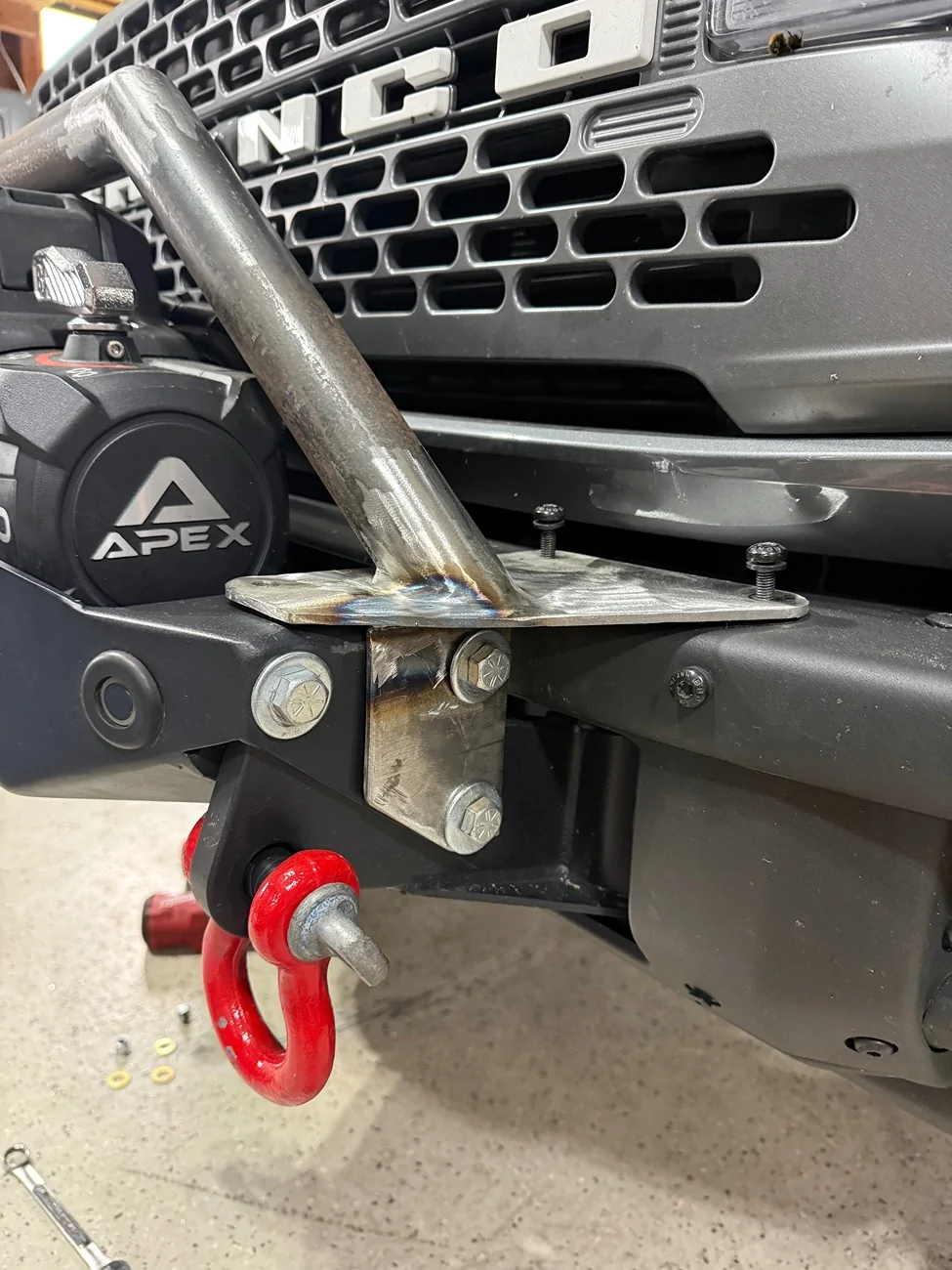

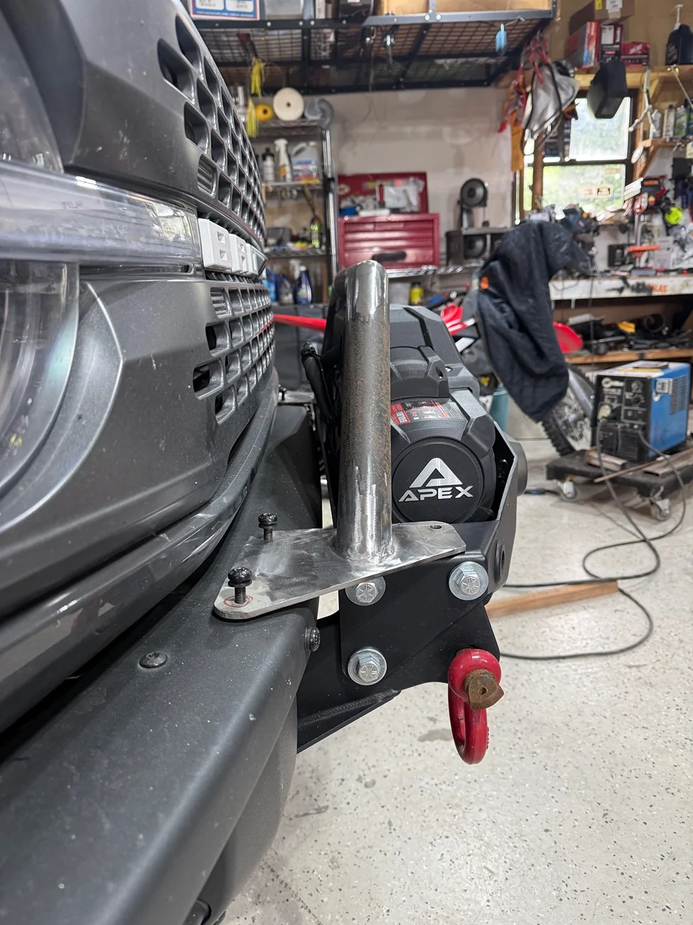

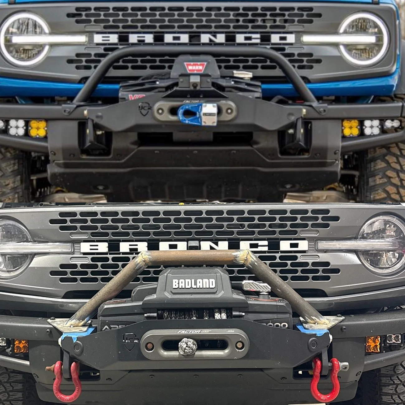

So far I’ve been very happy with the JCR winch mount And the Maximus braces. I just fabbed up a “Baja” bar if you want to call it that, I wasn’t super happy with the look of the JCR and way overpriced. I’m going to add a tab on the bottom, tying it to the rearward two bolts on the JCR mount also. Not that this is meant as a recovery point, but I don’t like anything not super strong. If anything this adds more rigidity to the winch plate and honest just a meaner look to the front end in my opinion.

Fab completed👍🏻
