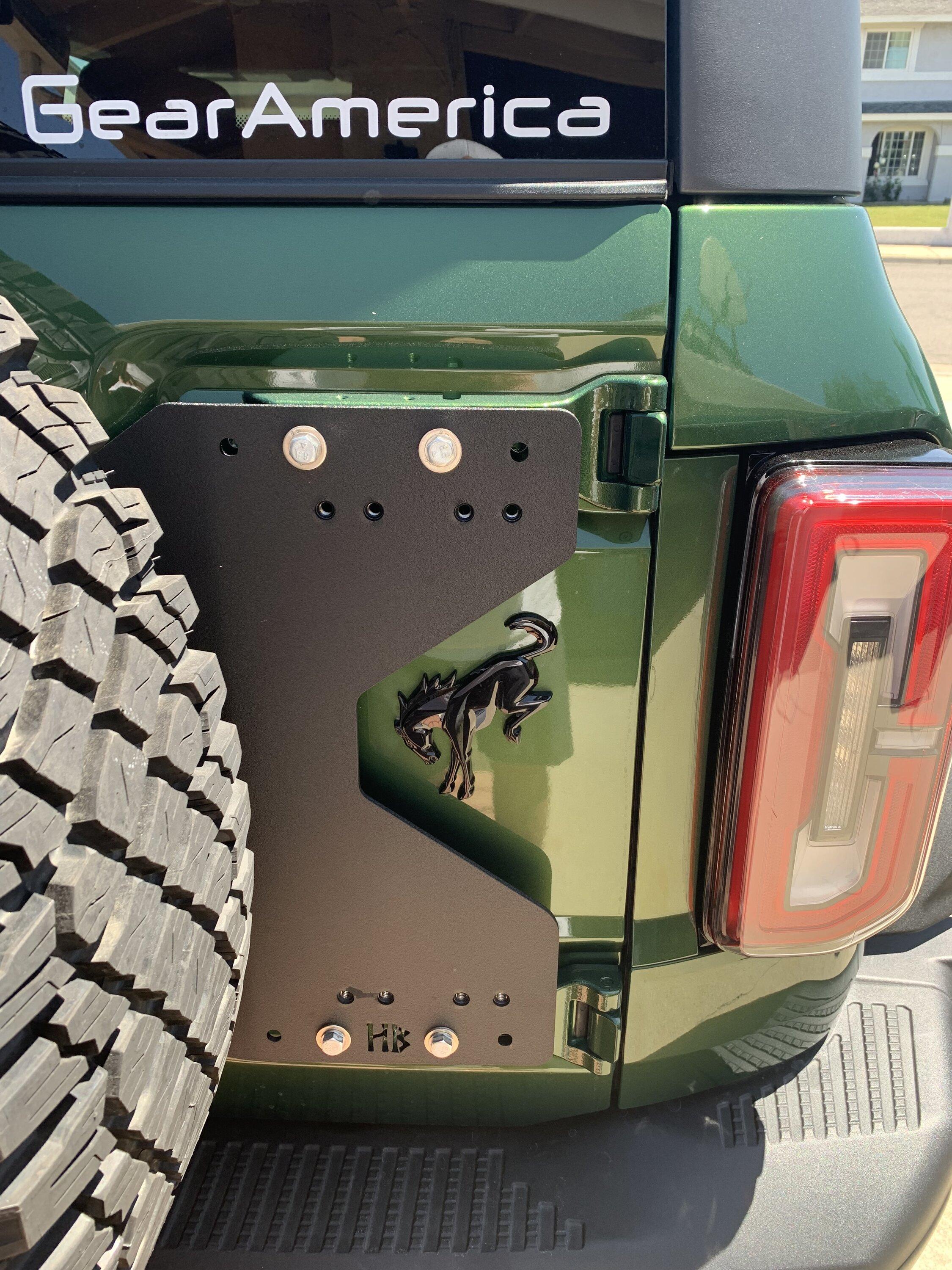

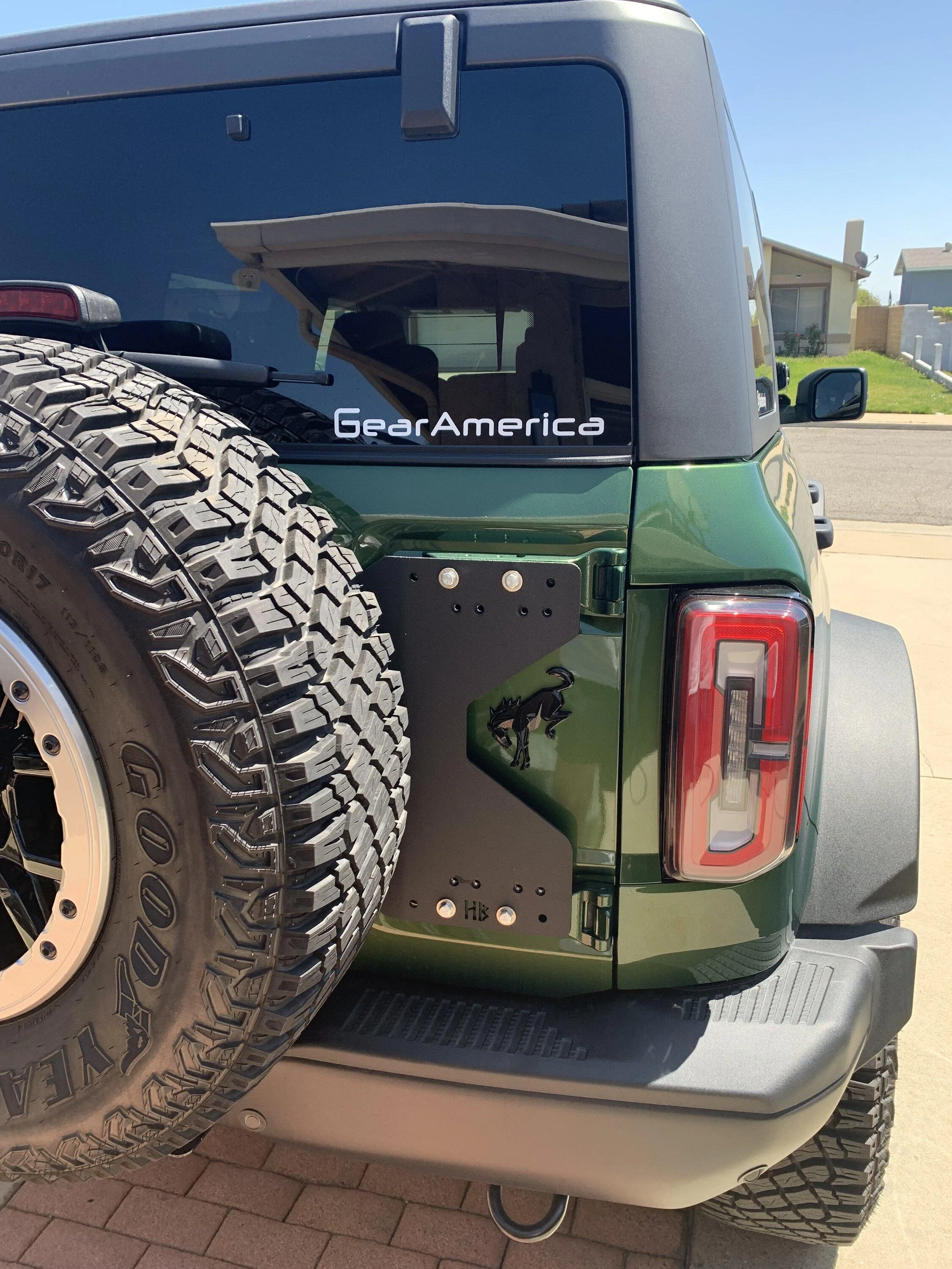

Finally My Raptor Hinges are painted and installed with The Hammer Tailgate system. Such a great Modification and I’m sure glad I did this. Thanks Tyson and the Hammer Built team for such a great product.

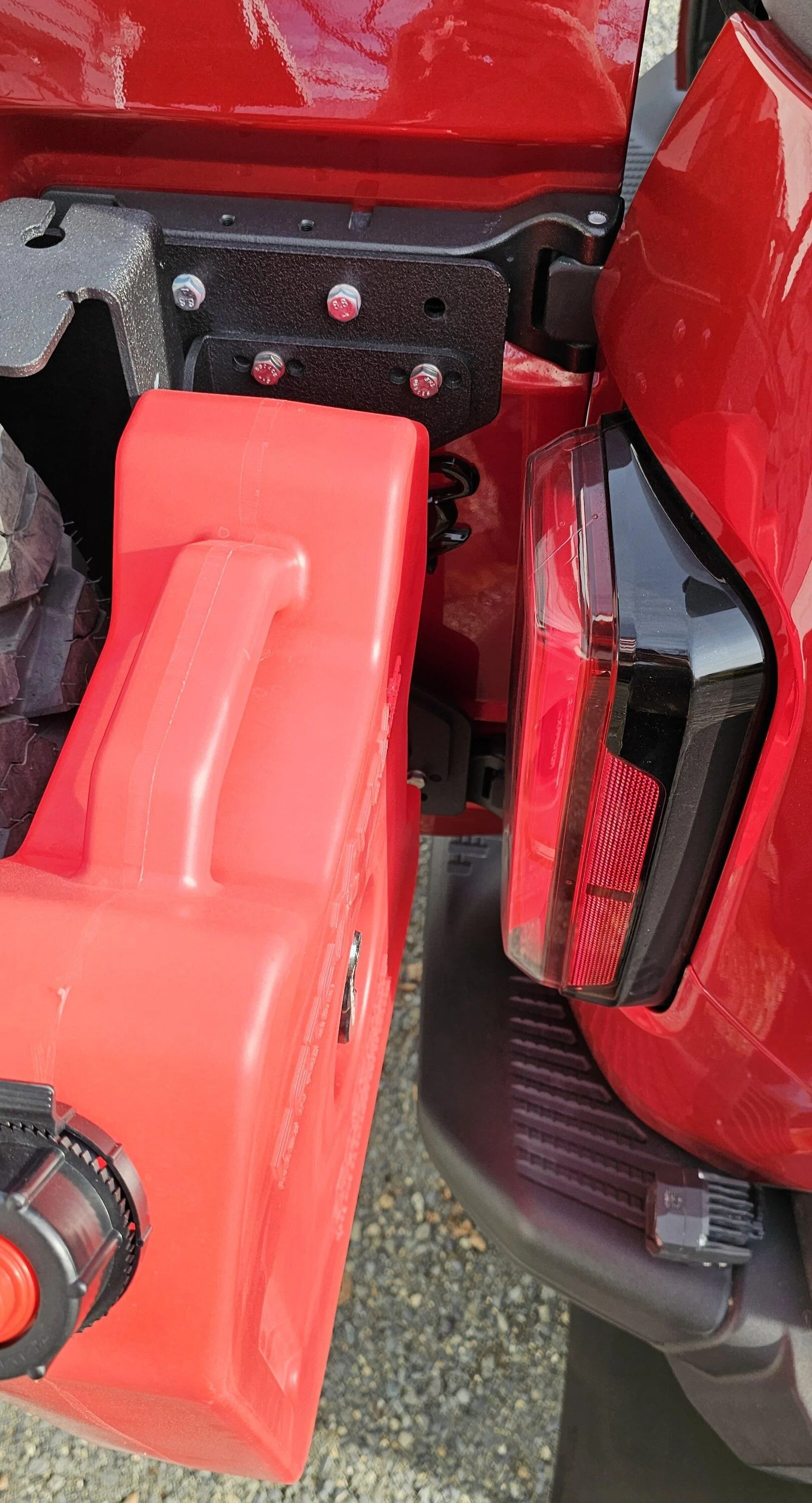

I'll preface this by saying I have Raptor hinges, not sure if this would change with the stock hinges.
With a 2 gallon can you can fully open the tailgate as long as you open it carefully. It touches the stops *just* before contacting the light - but, if you wing it open or otherwise let it get away from you, things flex enough to where it will smack the light.
With a 3 gallon can you can go to 90° with this amount of room to spare:
Ford Bronco Hammer Built - Built to Hammer On: Modular Tailgate Reinforcement System 20231004_142742
With the 2 gallon can I felt comfortable not using a limiter. Now with a 3 gal I will need to get something

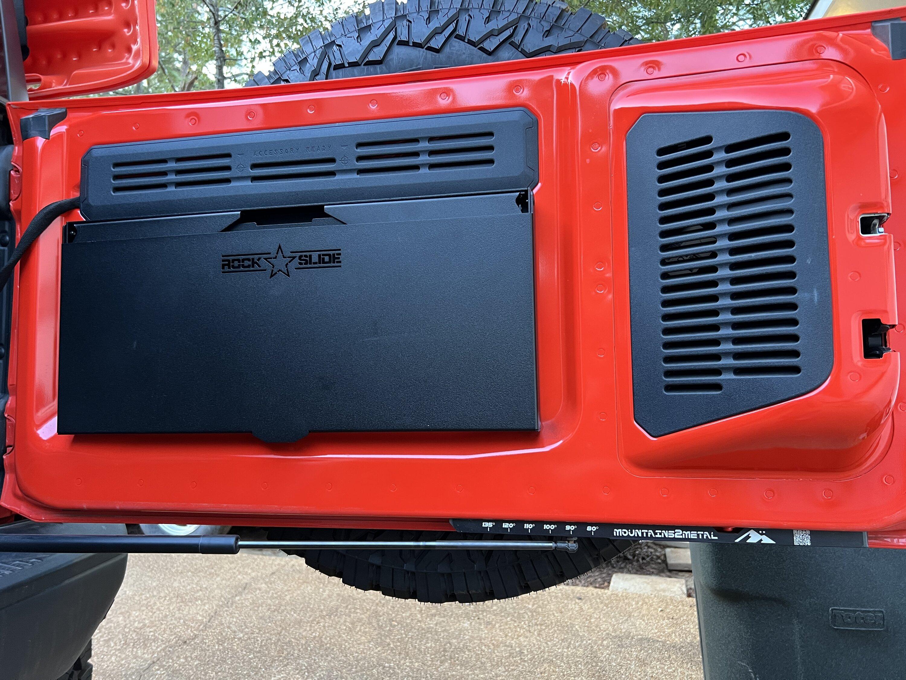

I put the Mountains 2 Metal limiter on mine.

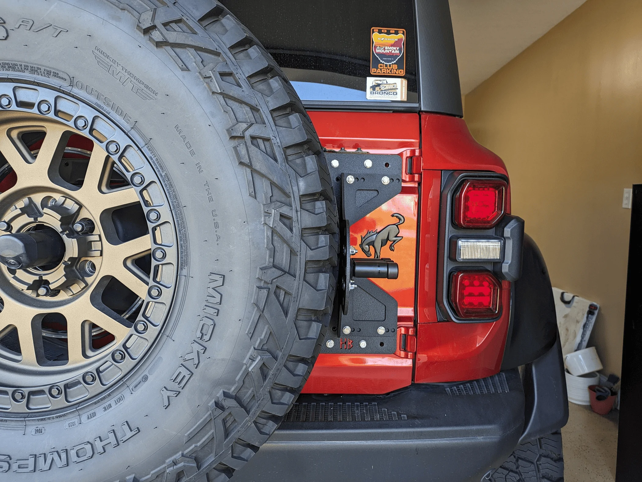

Adding this for reference. True 37s" with the accessory mount clears on my braptor. I think a 38" tire or larger and your're going to need a different custom solution. @DoYouBronco
