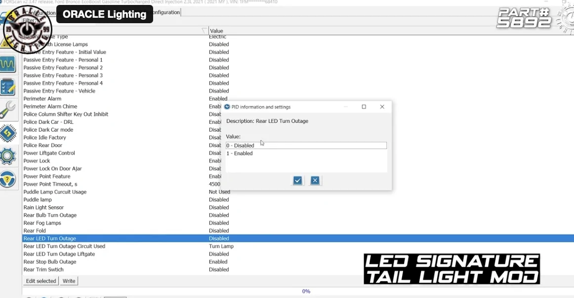

OEM Halogen lights that are replaced by Oracle Tail Light should use the included resistor and not require FORSCAN adaptation.

I installed the Oracle LED flush fit tail lights in place of the OEM halogens. Instead of using the resistors I made a change via Forscan. So far so good the lights work fine.

Not everyone wants to make Forscan changes, if you have Forscan already then this is a great option for you.
Just wish it was suggested. I didn't realize the correlation. I thought the Forscan changes were just for those with factory LEDs.
