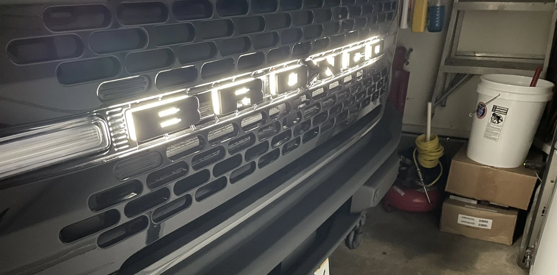

Look at the @ORACLE Lighting back-lit lights - they also offer a neat startup sequencer. There were very few options when I got mine. They install individually and do not interfere with the Camera.
Ford Bronco Grill letter lights Oracle Grill
also available in white (as well as white or amber backlit)

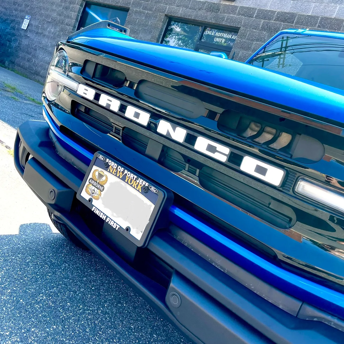

I looked at Oracle and Putco. Went with the Putco. Easy install and can change from white light to amber in less than a minute. Bought mine through 4x4TrucksLEDS. Included an add a fuse. Installed over a year ago. You do have to remove the grill and drill out current letters.

Heads up. The letters Ford sells do NOT have 2 brightness levels. They also connect to the upfitters. AND they don't have the animation startup sequence.
They are made by Putco but they are a different model. Putco is officially licensed by Ford and makes 2 versions of this kit. The BETTER kit I linked down below which has all the extra features.
If you want the full kit that works on all Broncos (except Raptors) and connects so it works automatically when you start your truck with all the extra features, get these: https://www.4x4truckleds.com/putco-luminix-ford-bronco-led-grille-emblem-for-2021-ford-bronco/
We have them for trucks with Front Cameras and Without Front Cameras
