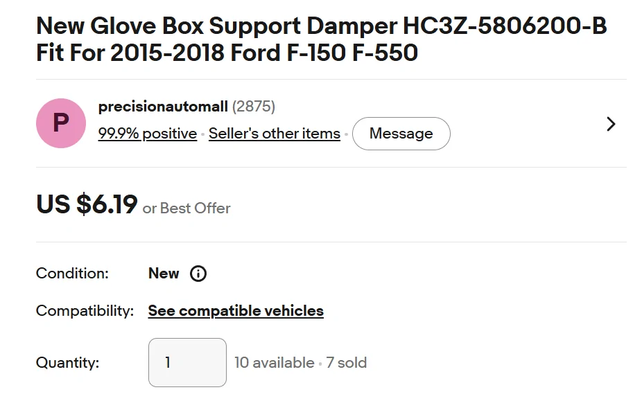

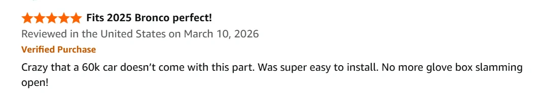

wow way better - that part is on Amazon and has a review that says it was used in a 24 Bronco with no issues.
No kidding:
Ford Bronco Glove Box Damper Replacement MY25+ 1786115585992-8c
And its actually only $6 on eBay:
Ford Bronco Glove Box Damper Replacement MY25+ 1786115678350-
I'll update the thread with whether or not it is actually a drop-in install, but either way this seems like a great resolution for anyone with a 2025+ bronco. $50+ is definitely crazy, but $6 with free shipping and I'm ending this annoyance in a heartbeat...

Hey so I just came across this video on getting behind the glove box, and theres a step where he unhooks the damper. However, when I went to do the same, I found that my glovebox does not have this at all! The mounting cutout/slot is there for it, but no actual damper:
Did they stop putting these on the glove box at some point? If I want one can I buy one somewhere?
Edit:
The dampers no longer come in Broncos (seriously Ford?), but you can get an F series damper for about $5-10 online and it should drop right in. For those who want to eliminate the bounce.
