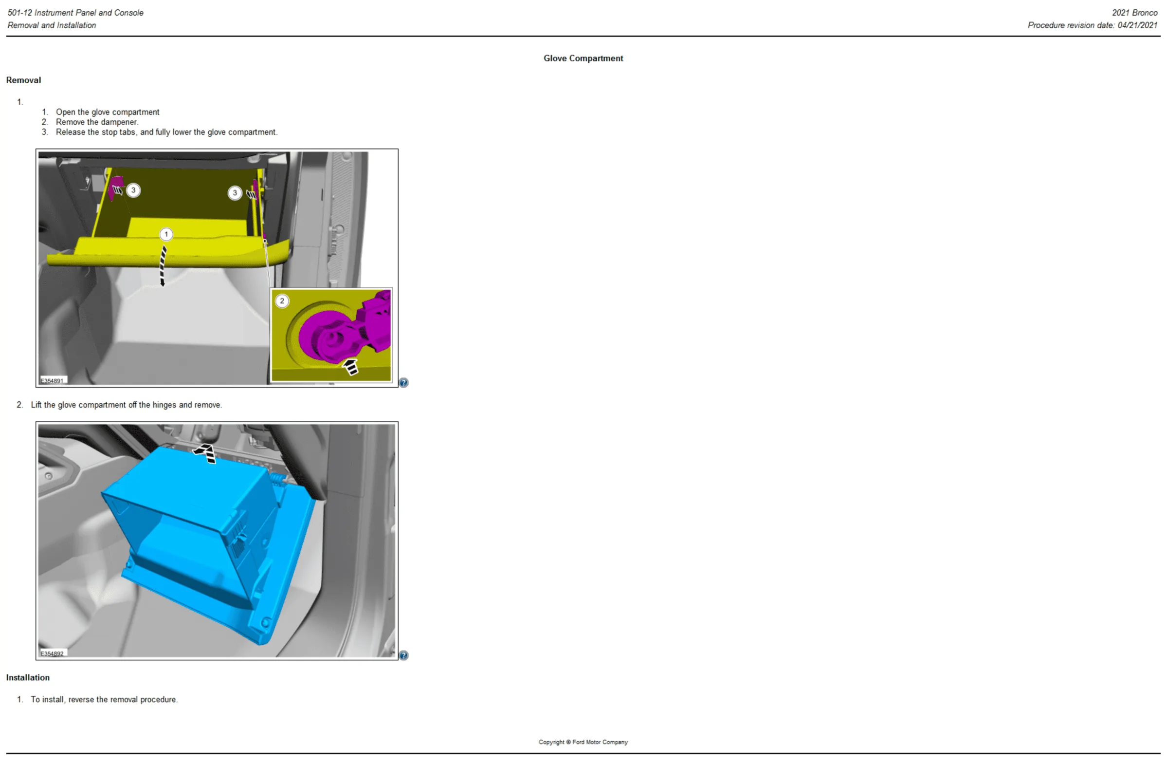

I've successfully mounted by roof lights, drilled the hole into the pre-wired area... attached all that...etc
Does anyone know how to remove the glove box to gain access to the aux wires that are behind it? I know you can press in on the clips to allow it to drop about 4 more inches... but really that isn't enough

once it drops and swings open the hinges should align and pull free. Don't forget to line up the soft close track on the right when you put it back in.
Ford Bronco Glove Box Removal? Gloveboxremoval
Ksjrb03
4,212
11,163
Tx
F250
Can’t believe there’s a shop procedure for this.

I appreciate this a lot, thanks!
