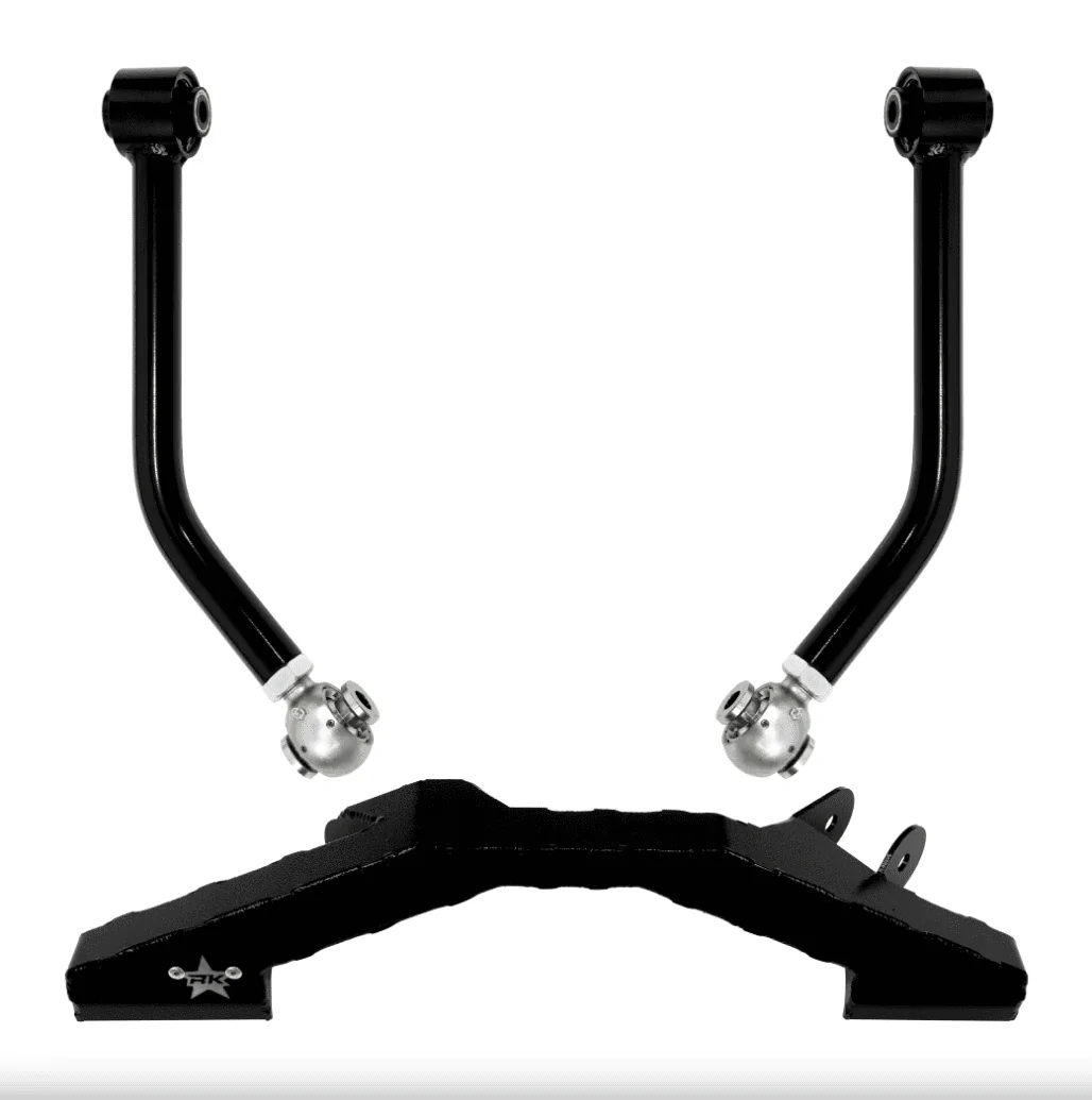

I assumed the arm was threaded and the only nut on the arm is the jam nut. Are you saying that's not the case?
Edit: meant jam nut, not lock nut

Looks like the nuts on the Johnny Joint ends are the jam nuts, for the RockJock arms.

Yes that's how it is.
I think the issue, because I had the same issue, was no flats on the Core 4x4 arms themselves to put a wrench on. You would either have to put the arm in a vise to tighten up the jam nut or use a pipe wrench thus marring the surface. I ended up pulling them and putting them in the vice to tighten the jam nuts. Looks like their current offerings have the flats for a wrench. Also, I ended up taking the hardware that Core 4x4 provided out and using the stock nuts and bolts. The washers were too big and just grabbed the outside of the dimpled area the stock hardware recessed into causing the bolts to slip while flexing. And yes I torqued the bolts but they still slipped.

My issue exactly! I used a vice, and pipe wrench and loctite, and had issues. I thought of tack welding them, then decided just to go back to stock. I also used the stock hardware when I did run them.
