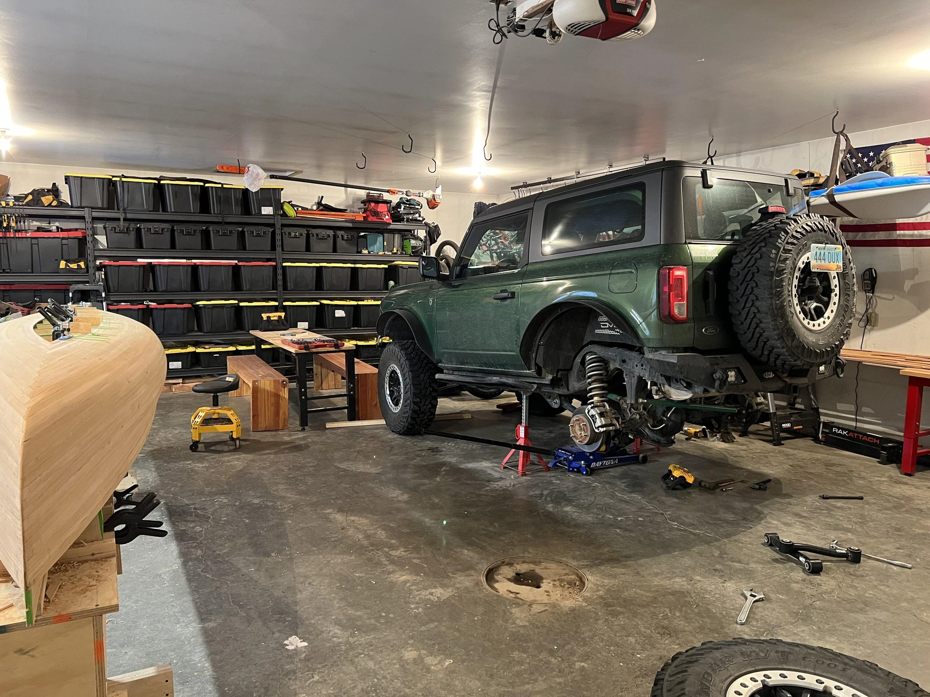

Yep, clunk when getting the suspension to flex on the road, like when pulling into a parking lot.
I could also hear a rattling over rough pavement and feel the rear being "more sloppy" and harsher impacts over rough roads.
You can easily get to most/all of the bolts, except the passenger, upper, forward mount. It's behind the gas tank. :(
When I finally tracked down the bolt, it was the upper-forward mount on the drivers side. I could easily spin the bolt.

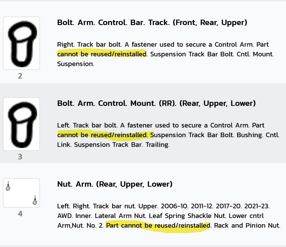

Ford Parts sites show nuts and bolts are one-time use. That is why I'm thinking they might have been stretched a bit and couldn't hold torque.
Or, it could be a symptom of these straight and/or solid-joint aftermarket arms.
https://parts.lakelandford.com/a/Fo...suspension-Suspension-components/ML21865.html
