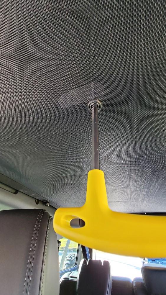

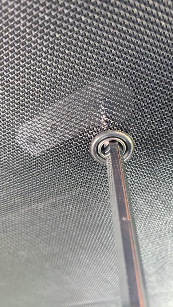

Accessing the knobs for the hard top
No zippers to access the latches. The zippers are wth the front two corners for storage. All latches are accessible except the 2 center ones where there is a grommet and you will need an Allen to twist. Gearshade made a plate for those two latches so you can use an Allen key..
Ford Bronco GearShade Mesh Top HARDTOP VERSION! 271F2DB7-13C7-43FD-AE91-4F2764B4214D
Ford Bronco GearShade Mesh Top HARDTOP VERSION! 20319F16-FBB8-416D-BA1B-2FBC4C5D8101

Y'all asked for it, so here is our offering for a solution to use the hardtop and the mesh at the same time! Will work for the 4 Door and 2 Door! 😉
NOTICE: This will require drilling into two of your hardtop twist locks.
Installation is very easy. Basically, you will remove the 2 centermost twist locks and install our stainless steel plate add-on. The mesh will have two grommet holes for an 8mm T-handle Allen wrench to pass through. You will use the Allen wrench as a "key" to twist the locks to open and close.
Your top warranty is most likely void now. :eek:
Kit contents:
  • Left stainless plate
  • RIght stainless plate
  • 2x M4 nut and bolt set
*Long 8MM t-handle wrench will be available separately, still sourcing them....
Installation:
Time 10mins
-Remove front panels
-Remove twist lock from the panel with your Bronco OEM tool kit.
-Please plate over the twist lock (clamp it in place) and drill two 4mm (3/16") holes through the holes in the plate
-Install provided M4 nut and bolt through the plate into the handle
-Reinstall the twist lock into the panel
Operation:
Full instructions will be added to our site soon.
*Removal of the front center bungee and clips is necessary while the hardtop is on. When you remove the panels, reinstall the bungee and clips.
The remaining twist locks and latches will be accessible from the edge of the mesh.
This product will go live next week! Visit www.gearshade.com for updates.
If you already have a soft-top version, we will be making a kit to retrofit it. 😉
