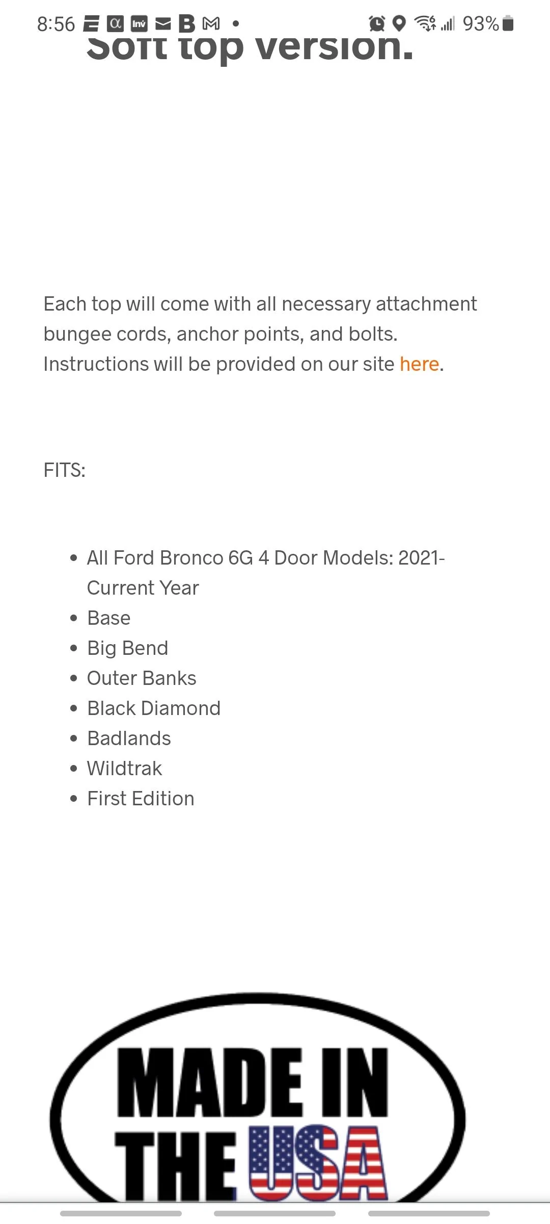

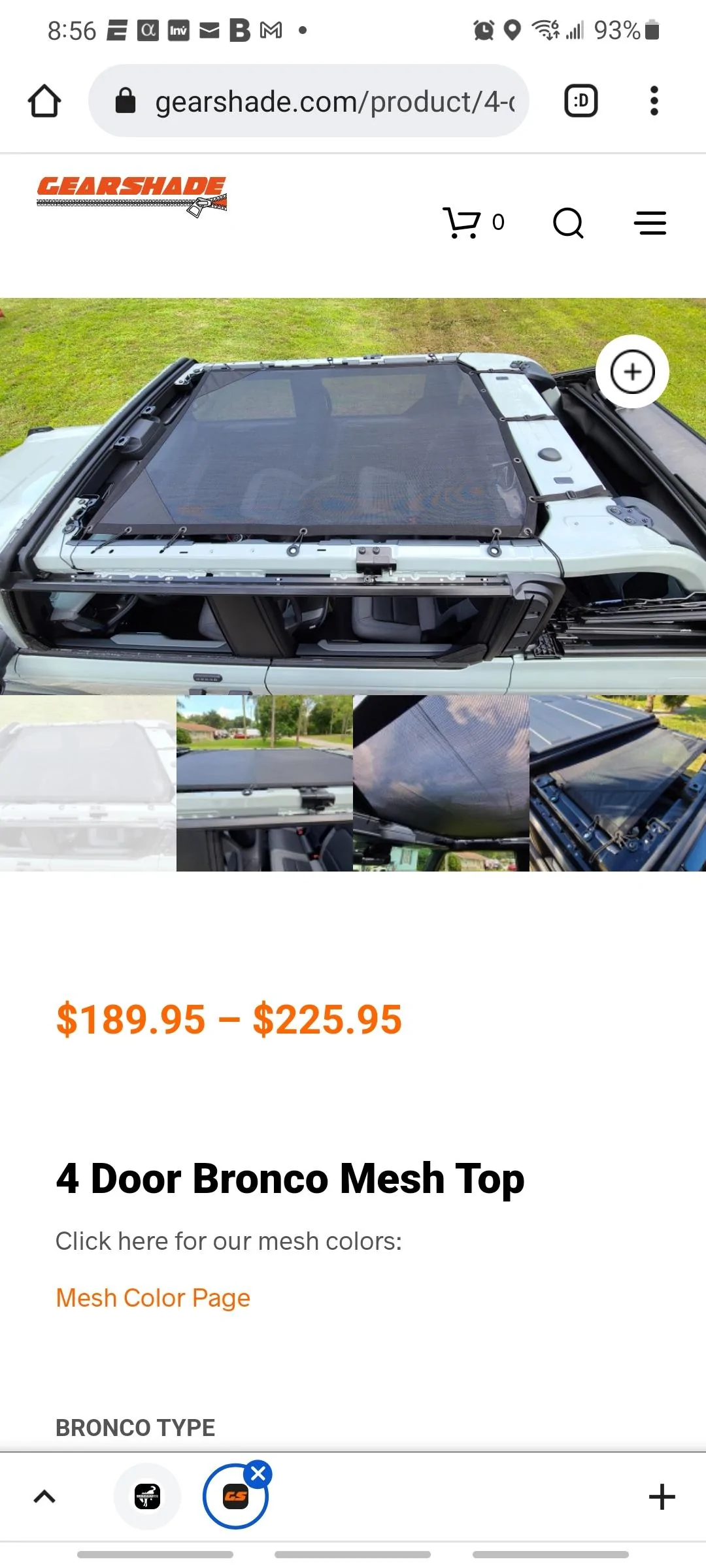

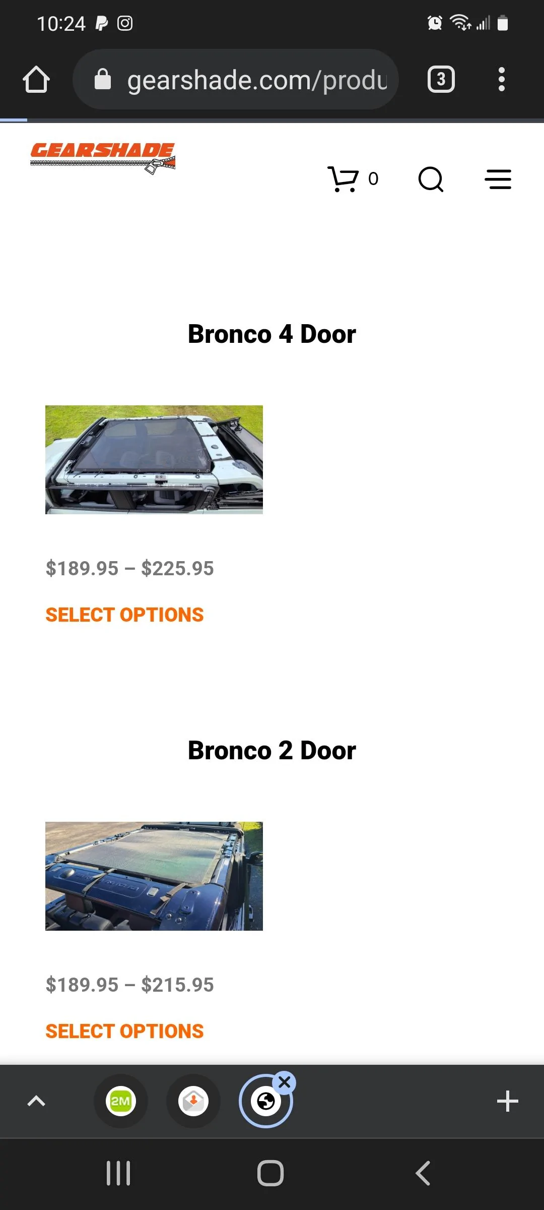

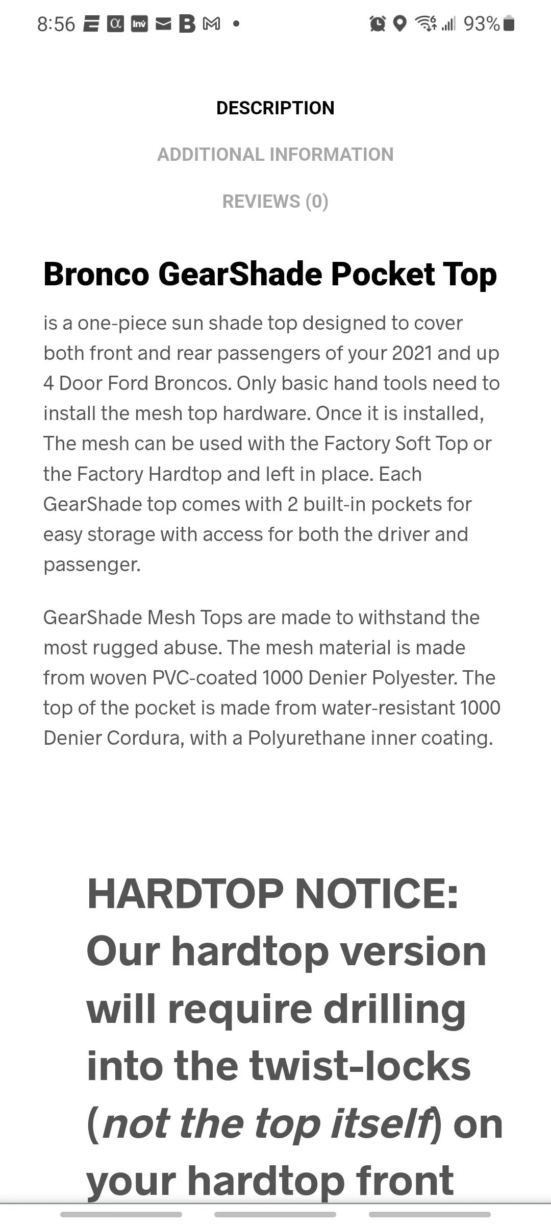

@GearShade this is what they are referring to:
Ford Bronco GearShade Mesh Top HARDTOP VERSION! Screenshot_20220304-085628_Chrom
Ford Bronco GearShade Mesh Top HARDTOP VERSION! Screenshot_20220304-085642_Chrom
Ford Bronco GearShade Mesh Top HARDTOP VERSION! Screenshot_20220304-085650_Chrom
On the basic gearshade page it only references the 4 door. The 2 door is listed on the custom print version.

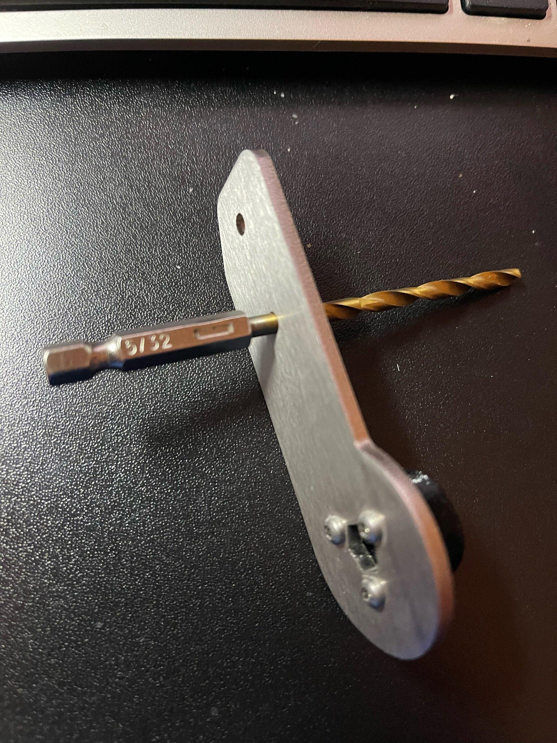

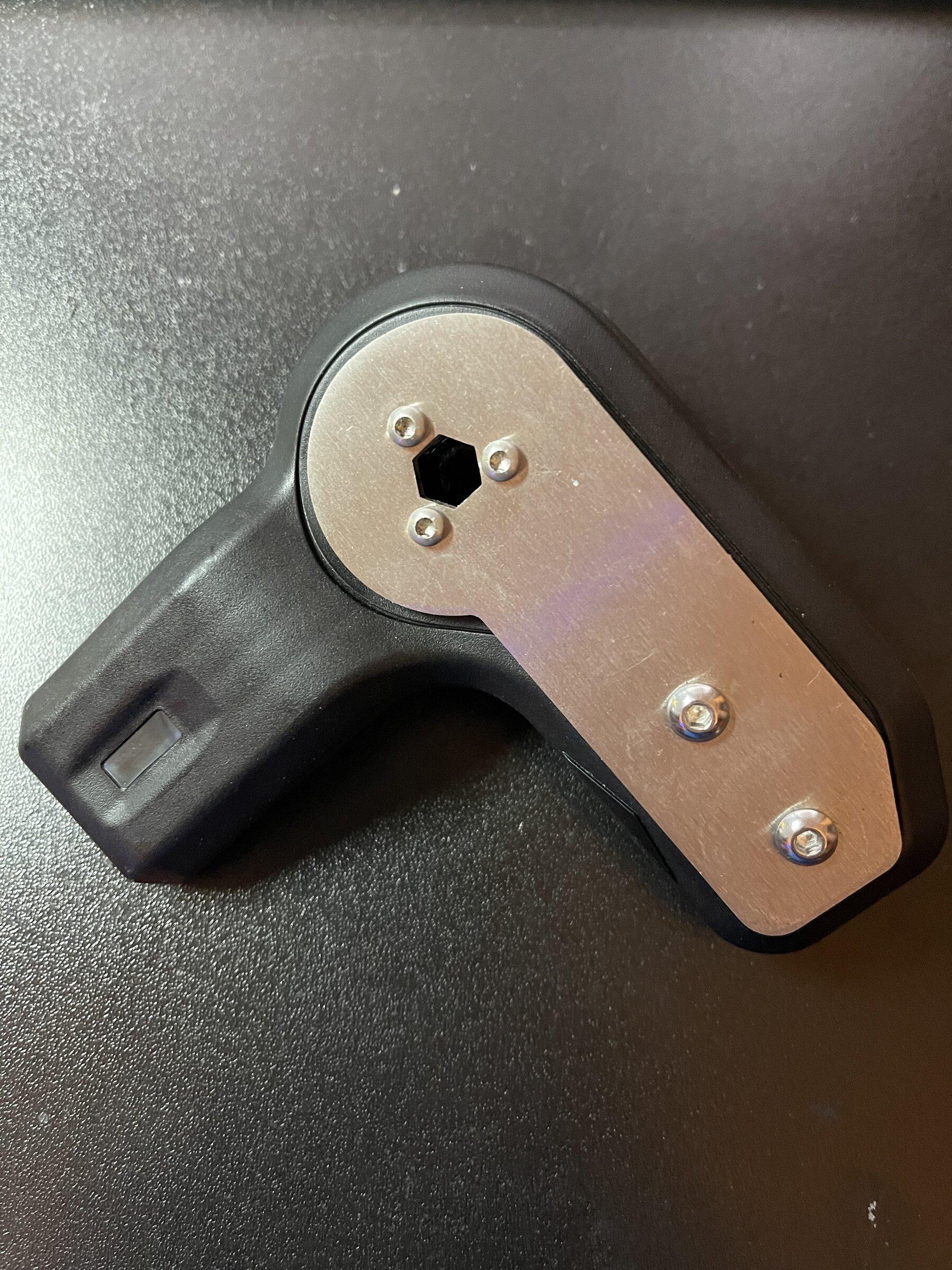

I just received the top. I noticed it’s mentioned that two M4(3/16) holes that need drilling. I believe it should be 5/32 as 3/16 is too big and won’t go through pre drilled holes. Here’s a picture with the 5/32 bit fitted.
Ford Bronco GearShade Mesh Top HARDTOP VERSION! 252693D6-6B46-48C6-8147-4AA397C573AC
5/32 bit is perfect.
