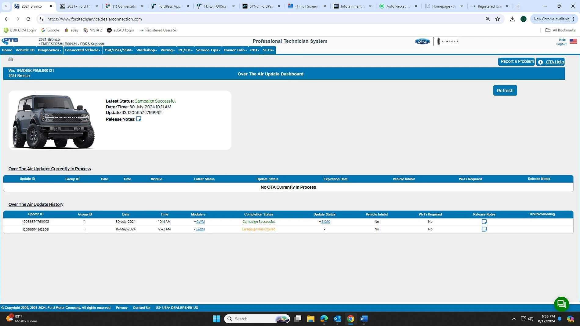

1FMDE5CP5MLB00121
Modem is working fine and the truck is talking to the cloud fine. OTA dashboard shows you got an update 2 weeks ago. That same update was sent in May and it timed out and failed because the truck was not being driven. It took 2.5 months for it to be resent. The OTA was 2.1.2 which is (as expected) an old update. Your truck is very behind, but it seems fine to me. It will be a long time before the OTA process gets you caught up, though.
