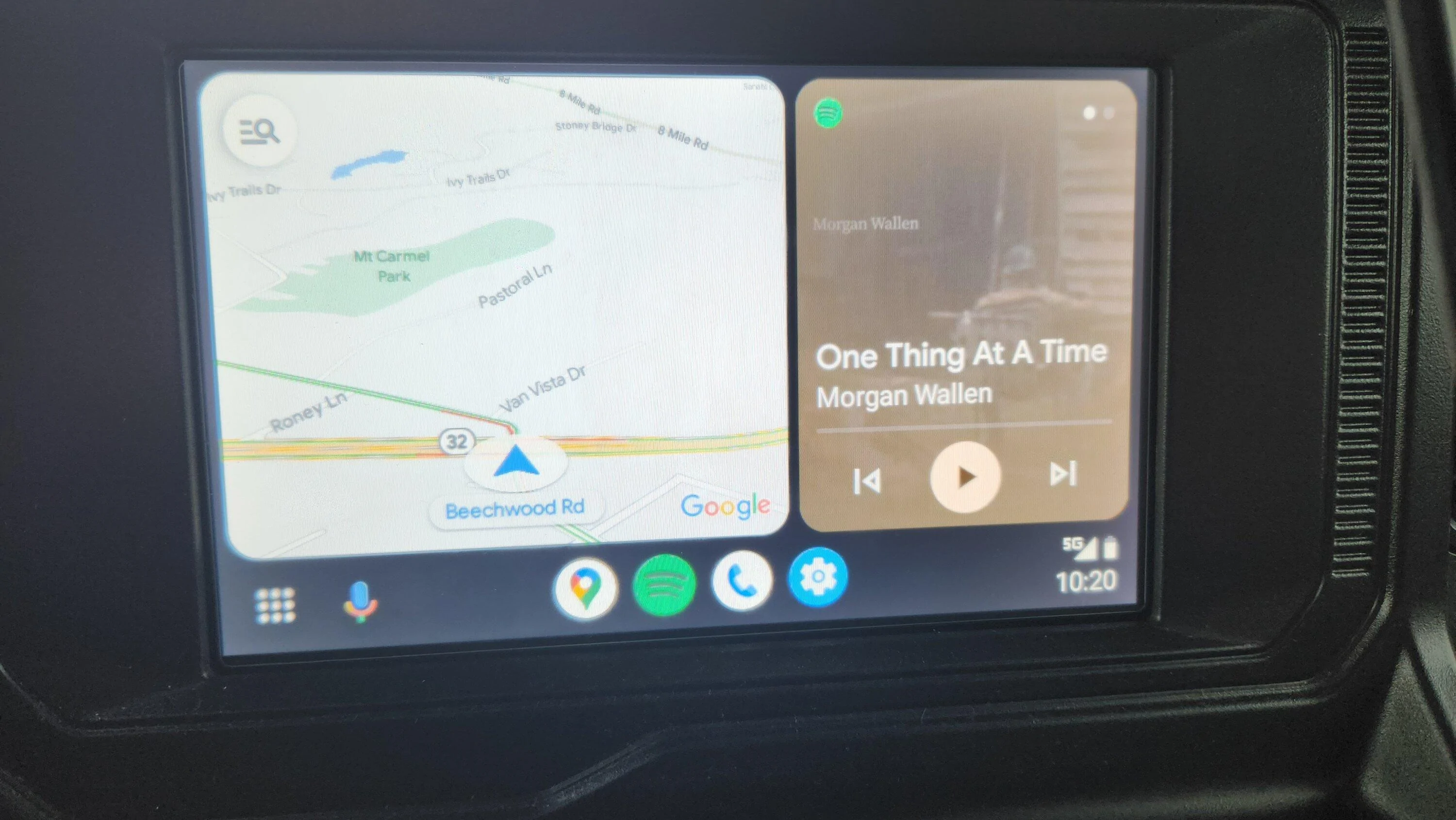

8" screen: Is there anyway to change or add icons to the bottom of the screen where it shows: Map, Spotify, Phone, Settings? I actually listen to the AM/FM radio and it takes several clicks to get to the Ford Sync icon in the app drawer to change radio station while using maps. Be great if there was some way to have the Ford Sync Icon appear at the bottom next to the other icons.
Ford Bronco Android Auto Coolwalk w/ Full Split Screen (Public Stable Release) Now Working in Bronco! 20230210_102024

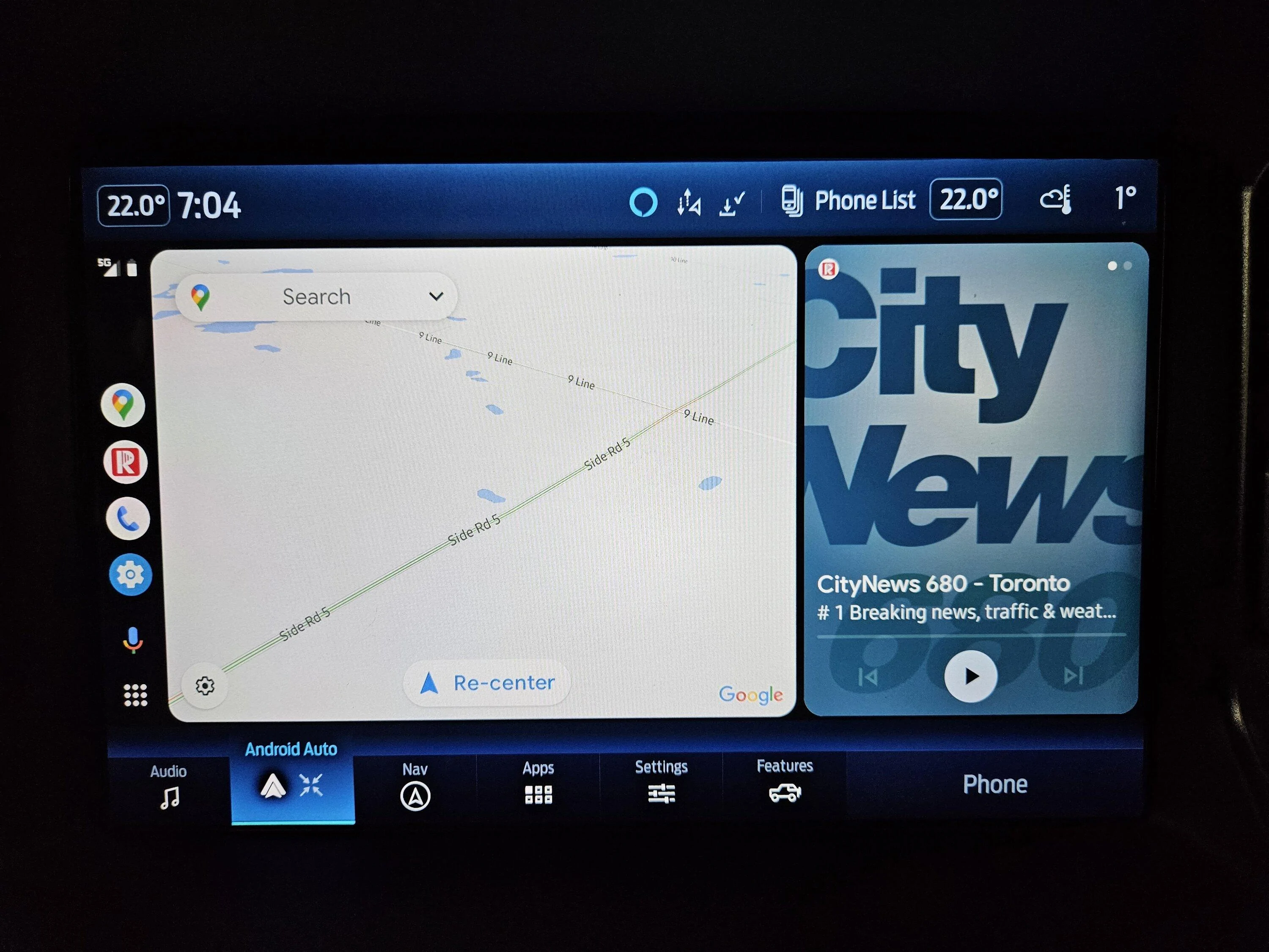

See attached screen pic. How can I tell if I have cool walk or not? Thanks for your help
Ford Bronco Android Auto Coolwalk w/ Full Split Screen (Public Stable Release) Now Working in Bronco! 27788DAB-A52A-43AE-A132-1D9E4834BD43

Sounds like you don't have coolwalk yet. There's an intermediate update between factory and the latest coolwalk (which is rolling out in waves). You're in that intermediate stage.
Looks like you have it. From there you should just press the maps button again for full screen maps
That’s what I thought but there’s no way to expand maps full screen. Very odd.

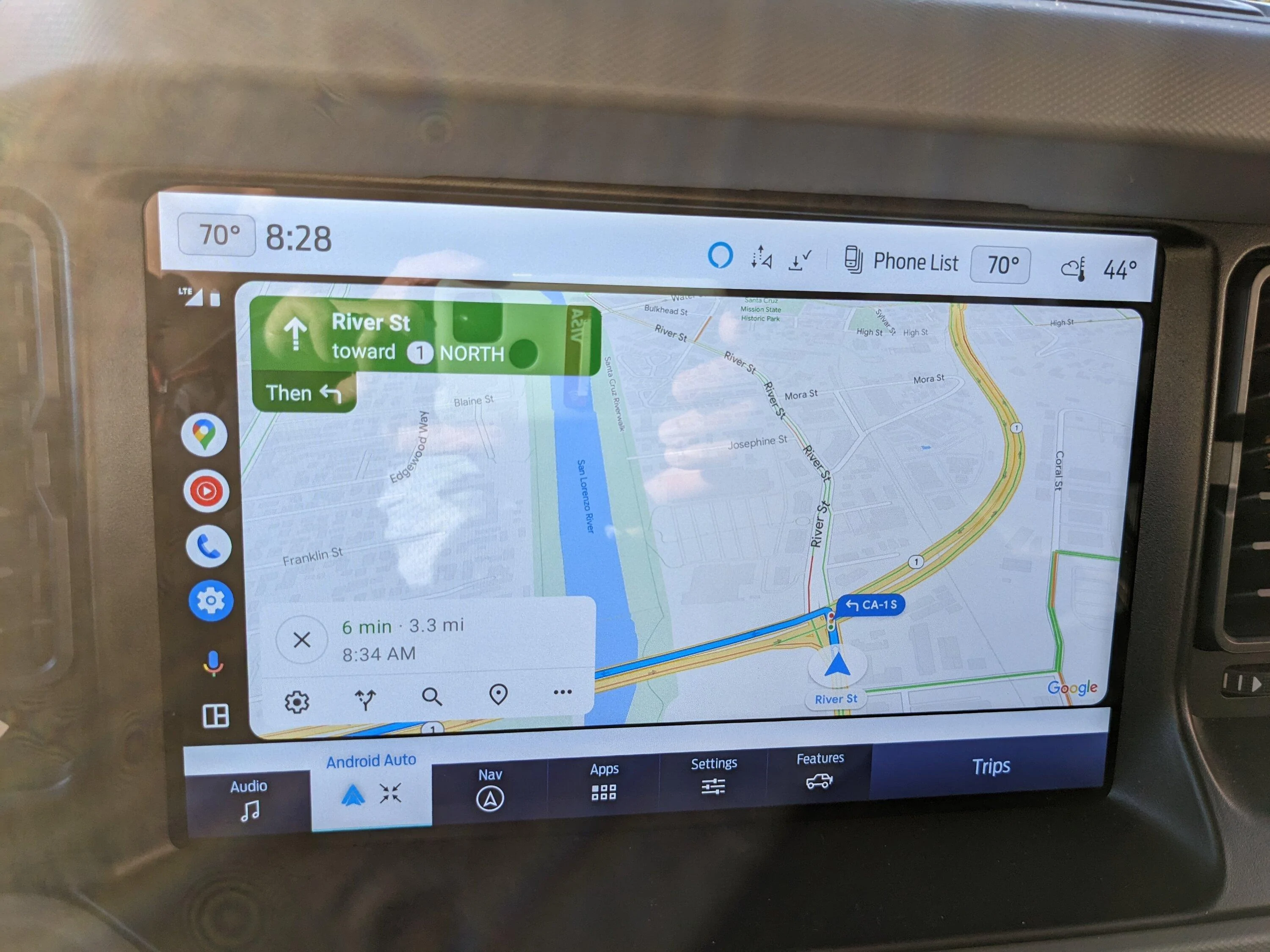

Just discovered that I now have Coolwalk - not sure since when, but definitely within the last week or so. Sync vers. 4.0.22294
Ford Bronco Android Auto Coolwalk w/ Full Split Screen (Public Stable Release) Now Working in Bronco! PXL_20230210_162822344

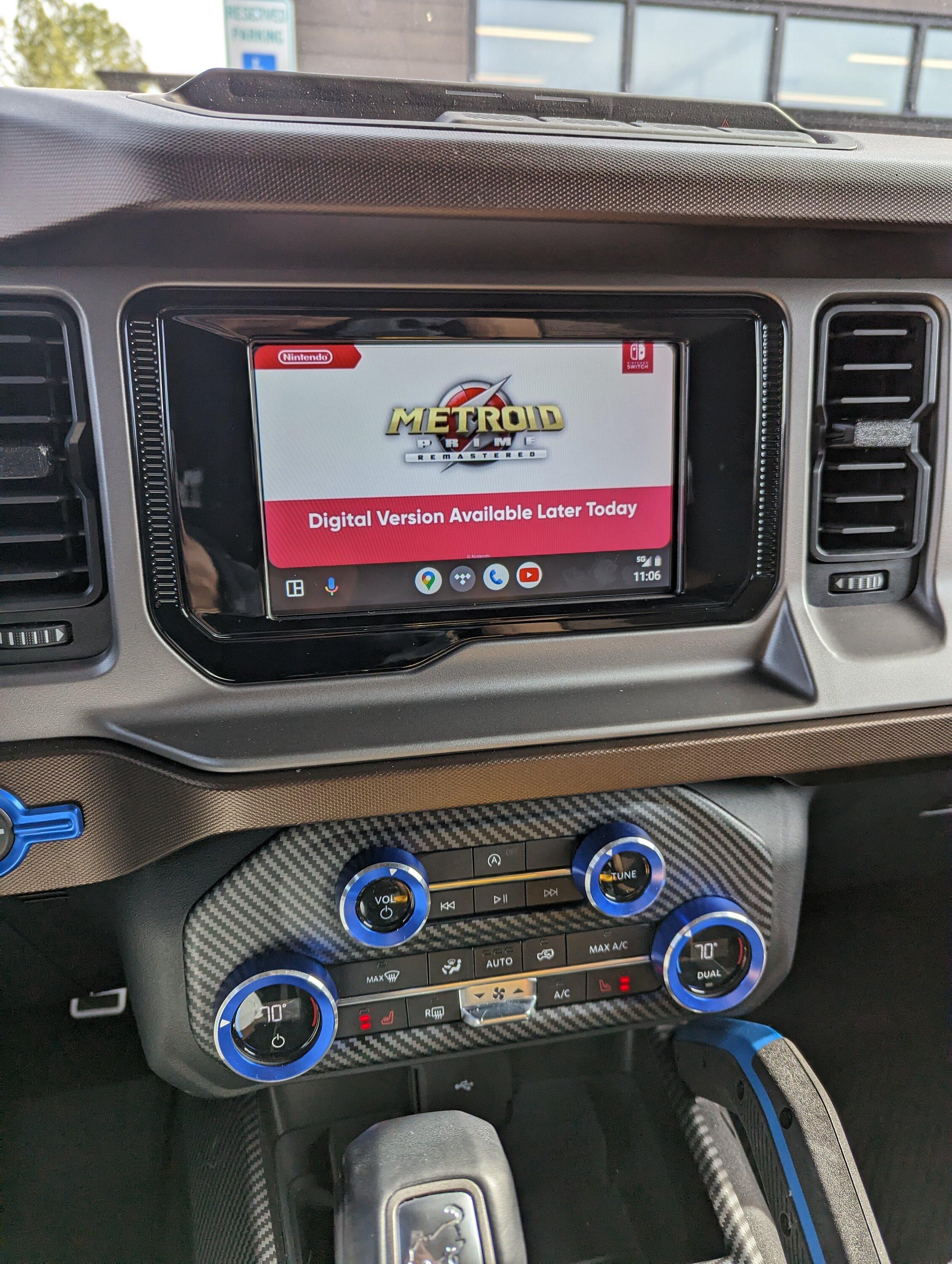

For those who know, AAAD carstream works with this update, for those who don't, it's an app that allows you to have YouTube on AA
Ford Bronco Android Auto Coolwalk w/ Full Split Screen (Public Stable Release) Now Working in Bronco! PXL_20230211_160623406

There is a way to do full screen maps, I think when I turned on the XM and used the maps it did go full screen the other day.
Thanks to all for your responses. I got full screen with your helpful comments. I didn’t realize both the blue android auto symbol and the expand icon next to it are both actual buttons that change the view. I had no idea pressing on the blue Android Auto logo did anything. Thank you again!
