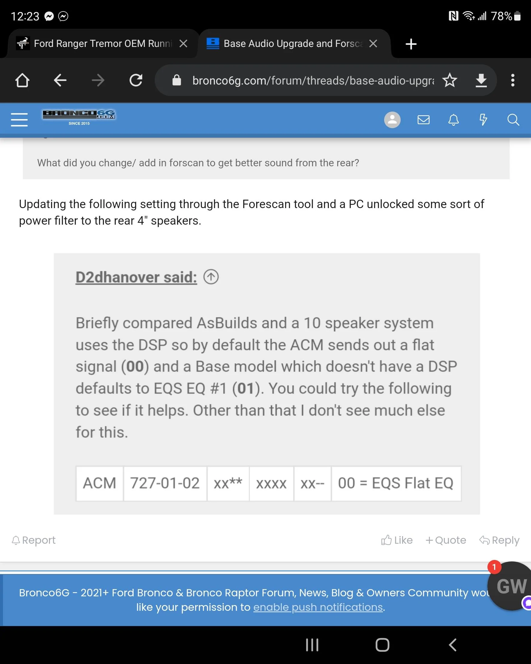

Which forscan changes did you make?
Updating you guys, as my buddy finished my audio install last night.
The Forscan update to give full range to the rear speakers, does in fact, give full range. Also increases volume quite a bit (went from listening on 17~ down to like 12~ after the change).
He brought the oscilator over to verify signal to the rear speakers before pulling the signal for my amp from them and they're definitely giving a full range.

The speakers suck in general, but it is receiving more bass with the mod( sounds better ). The unit is putting out more power than the speaker can handle. But if you are not a big audio person it will sound pretty decent.
Ok, that makes sense. They even have the kick panel speakers filtered as well! So the Forscan mod makes all 6 channels full range!

Yeah please clarify, D2dhanover's initial suggest was to change the value from 3801 to 3800, but other folks have referenced changing it to 382B
You're thinking of line 2 mod that was discussed earlier which did duck all for me.
This 382B is for the first line. Go back a page and look at the screenshot 👍🏻

I did mess with the line 2 settings and it went all haywire.. moved it back to factory. Then i found that link with all the ACM codes. I stuck with line 1 only.. this seems to do most of your speaker modifications. If you break it down i get what its doing but it gets complicated if you dont understand it. Shitty way to pass it on the consumers though.
