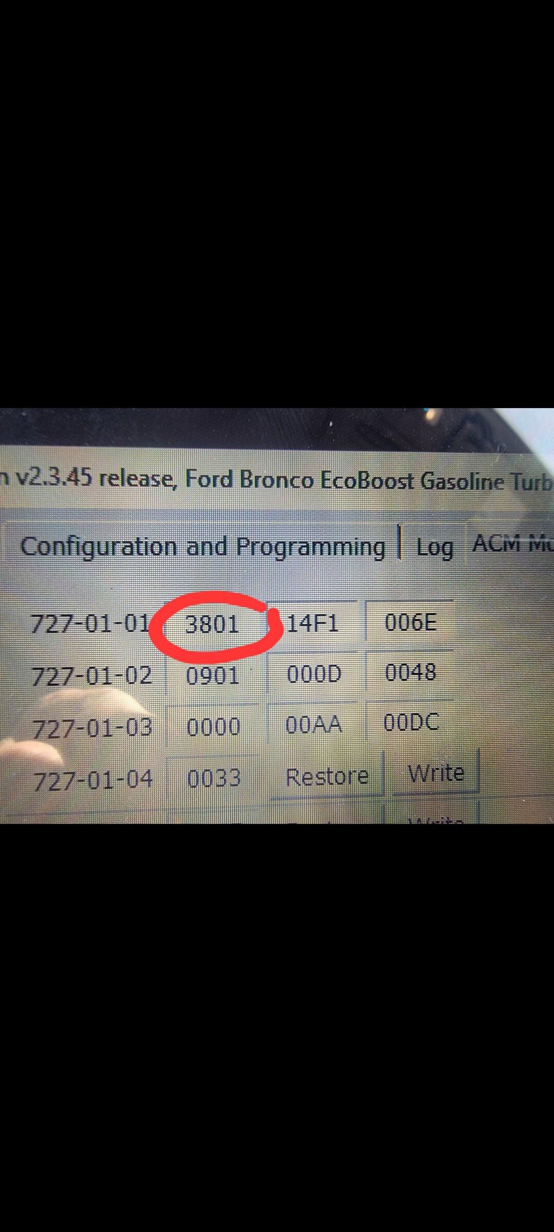

Hi guys 1st time here. Yeah the speaker is shiet on the Broncos. So I did some messing around with the Forscan and manage to open up some stuff with the speakers. Now if your not sure or comfortable messing with the Forscan i suggest not to do it.
So if you look under ACM module there is a setting on the 1st line. Gonna try to attach a pic. The 1st box is what you want to change. It will be the 3 and 4 character.. On my Badlands original settings is 382B i changed it to 3801.. hope this helps.. this worked for me..

No.. evertyhing stayed normal for me.
Line 1 and i only changed line 1. Should look like.
727-01-01 3801 14F1 006E..
My original build for my Badland setting was
727-01-01 382B 14F1 006E
Here is a link to reference most of the ACM module settings. Good luck peeps!!
https://naviupgrade.com/asbuilt-programming-database/

I did mess with the line 2 settings and it went all haywire.. moved it back to factory. Then i found that link with all the ACM codes. I stuck with line 1 only.. this seems to do most of your speaker modifications. If you break it down i get what its doing but it gets complicated if you dont understand it. Shitty way to pass it on the consumers though.
