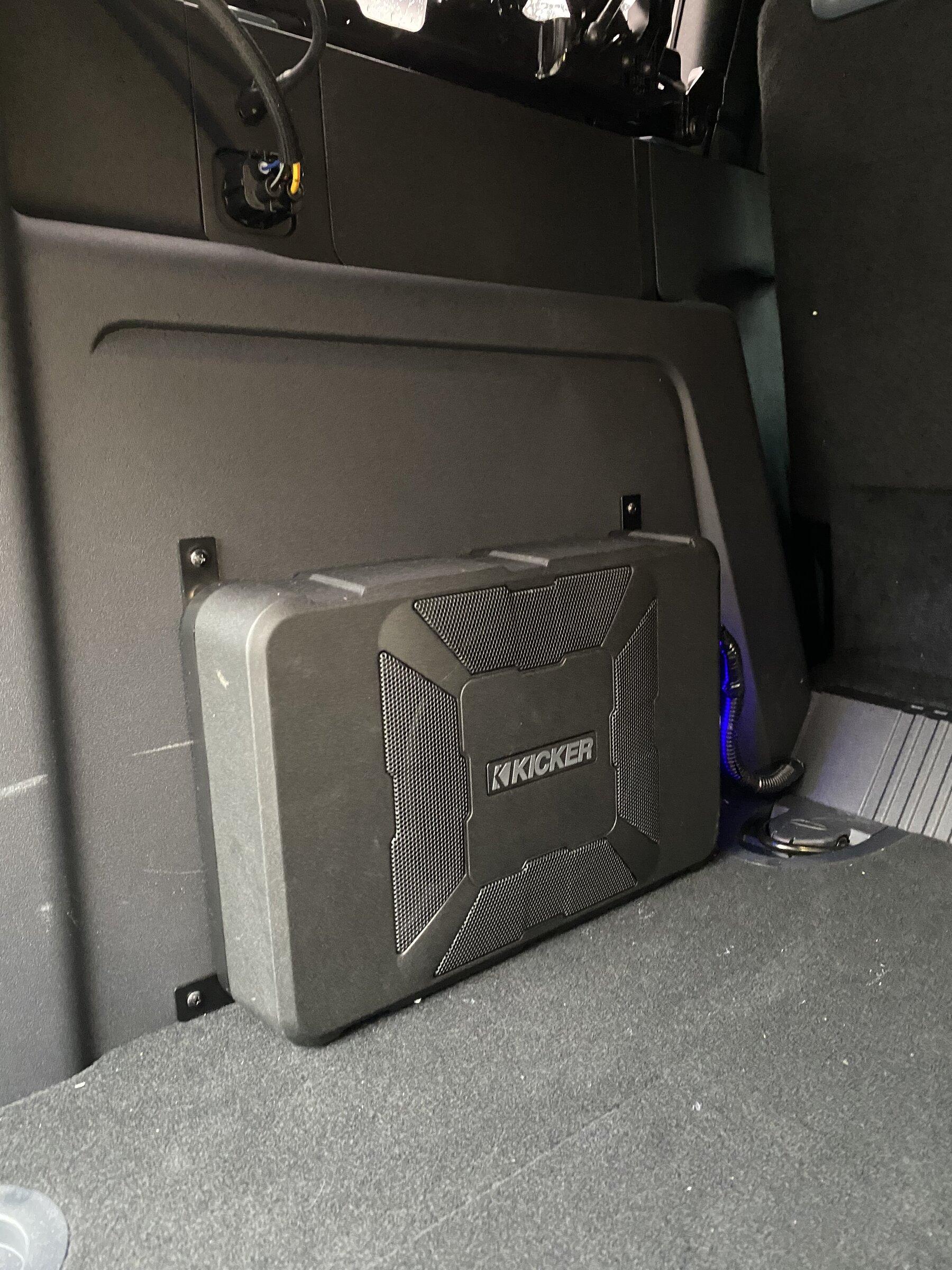

This is what I did. I've not found a dealer yet who claims to understand how to flash the rear speakers. The system sounded fine without the sub woofer , but the sub really rounded out the sound.

Curious where you mounted the subwoofer? I’m assuming under the seat
