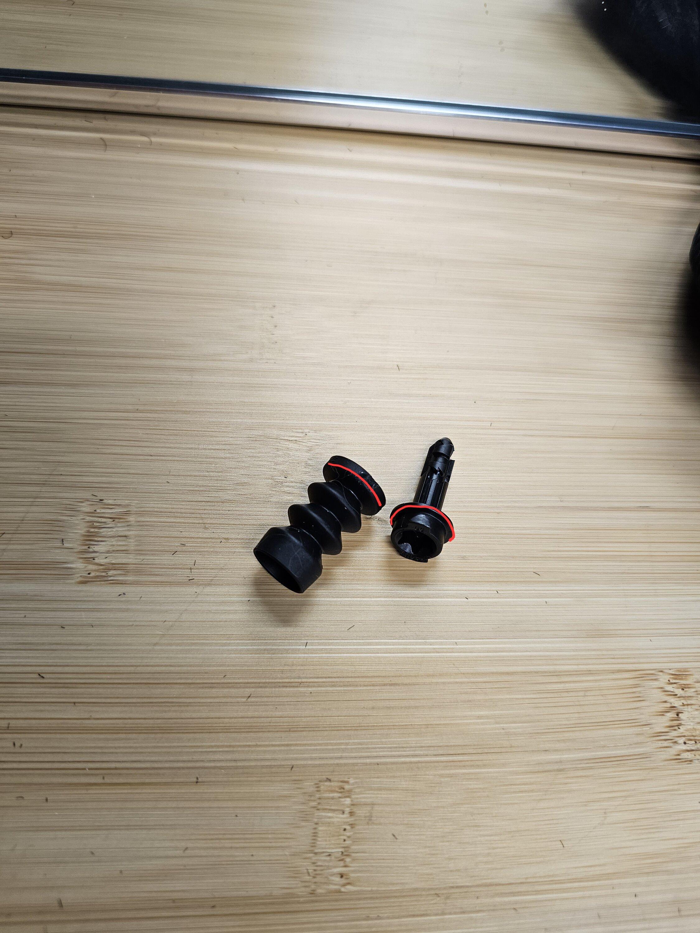

Are you talking about the pin with the rubber boot around it on the left in this pic?
https://hooniverse.com/wp-content/uploads/2022/03/bronco-key-pas-fuel-cap.jpg
I don't have the PN, but mine fell out the other day too but stayed inside the fuel door area. In case you need help putting it back on, the lip on the rubber boot goes onto the lip on the pin (shown in red), and then you put them into the fuel door and twist until it locks. Pliers can help twist it if you can't get a good grip.
Let me know if you have any questions.

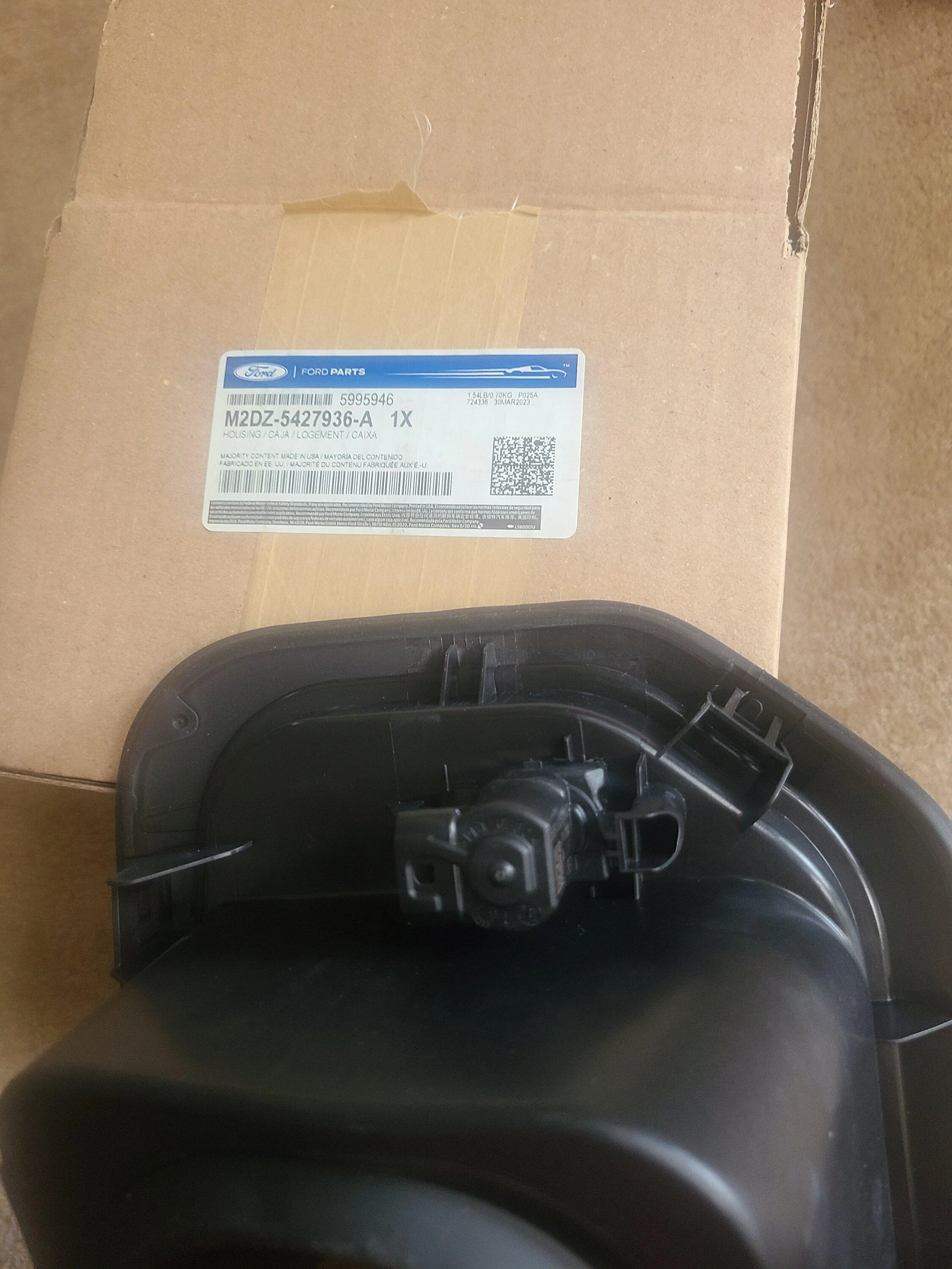

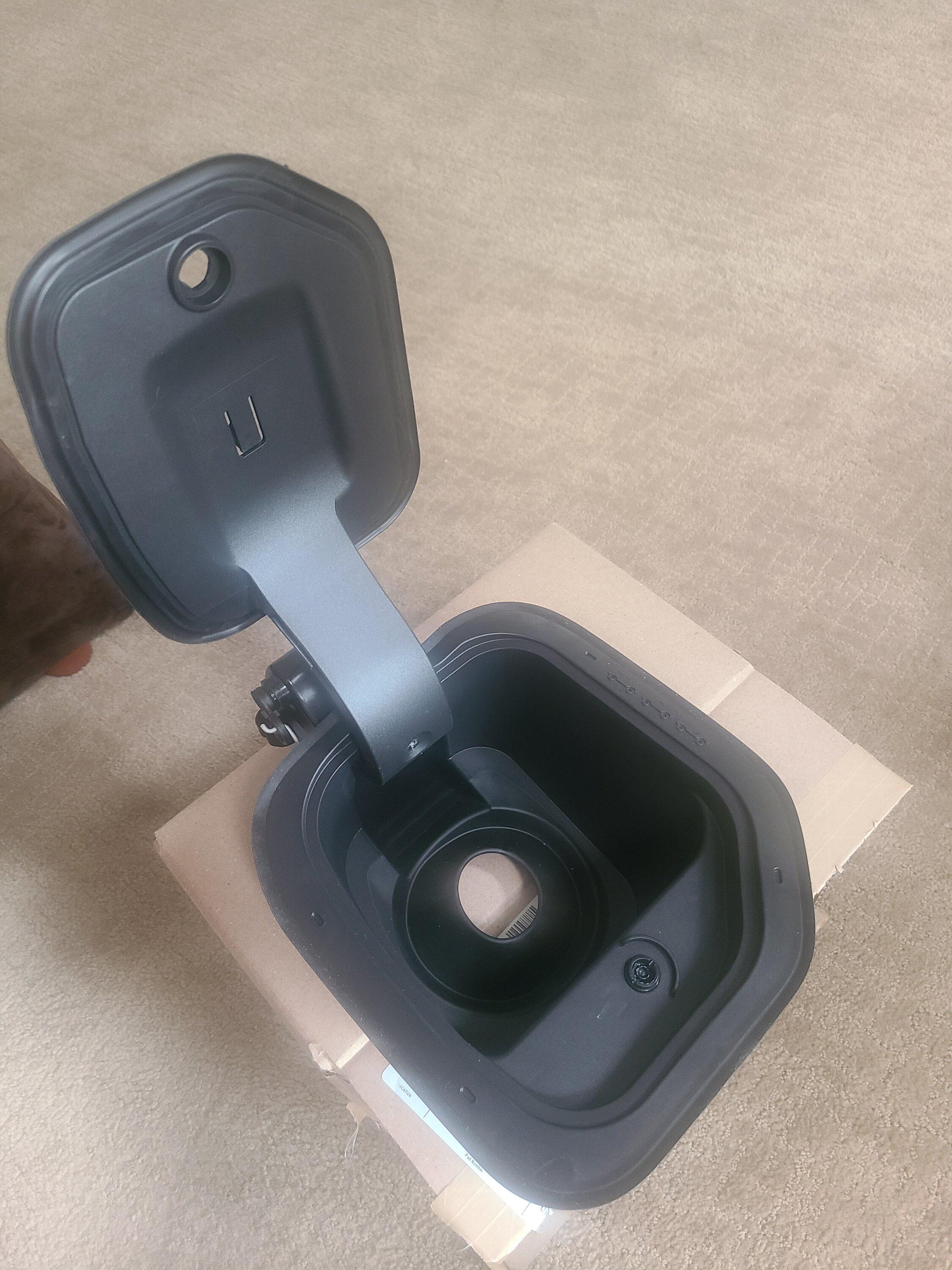

Update:
At the present time in order to get the pin you have to buy the whole fuel door housing, pictured in green above in BigHoof's reply.
I found it online for $80 at an online Ford parts store
PN# M2DZ-5427936-A
It does come with the inside latch mechanism which at least gives me a spare of one of those for whatever that's worth.
There is a vendor who is working on a replacement pin but it's not available yet:
https://www.megaohmmotorsports.com/
Hopefully he'll get it rolled out soon
Cheers 🥂
