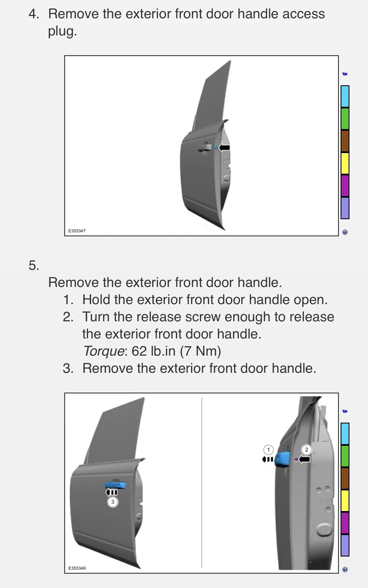

The 2023 is identical to all other broncos. There is a screw that needs to be turned out until the door handle will release from the latch. Once it does, the handle will slide out of the door.
To go back in, you need to slide the front of the handle into the door, then push the back of the handle in towards the door, into the latch while at the same time retightening the screw.
Depending how far out or in the screw is, the door handle may not want to go back into the latch. This picture probably won’t help much, but maybe it’ll give you an idea of what I mean. This is the removal, basically just do the opposite to install.
