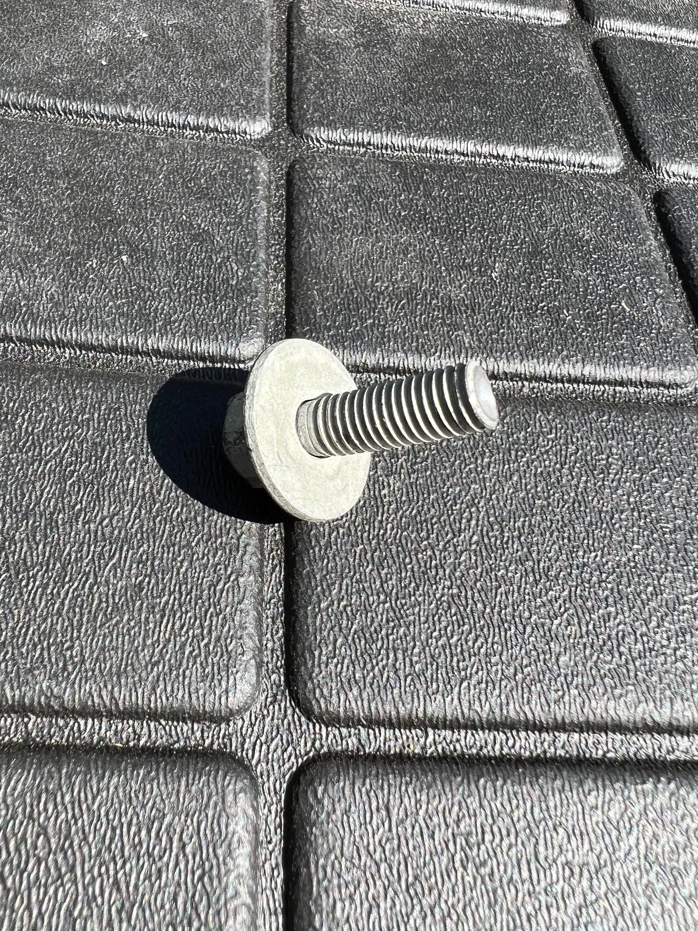

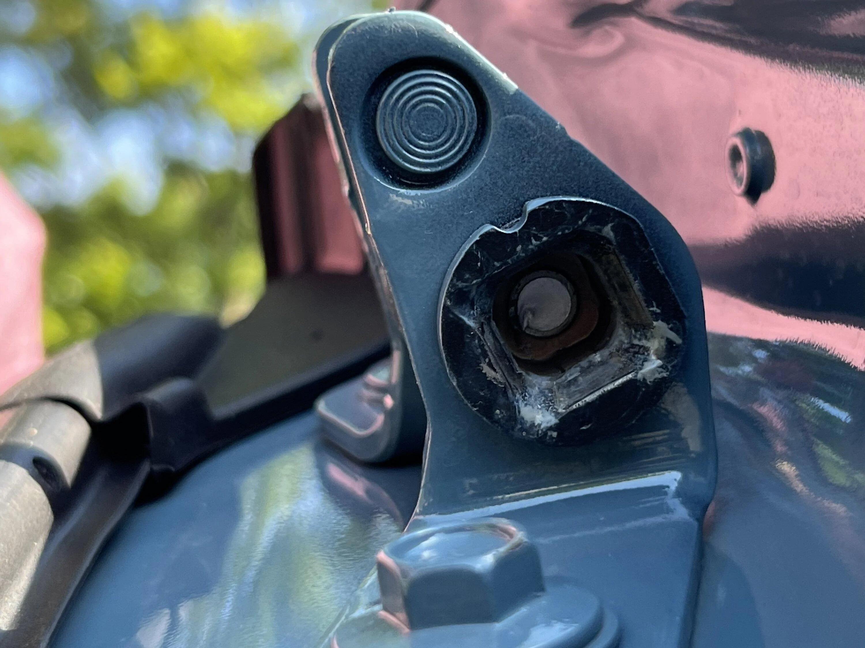

Zinc coating ang galvanized are the same thing, but there is hot dipped and electrochemical.
Gtrekker
Gary
Dec 22, 2020
58
1,509
1,999
NJ
The factory bolts are not galvanized. It's actually an Epoxy coating such as Magni-565. Galvanized/Zinc plating is a very poor corrosion inhibitor.
Sounds like a good spot for N5000 antisieze.
