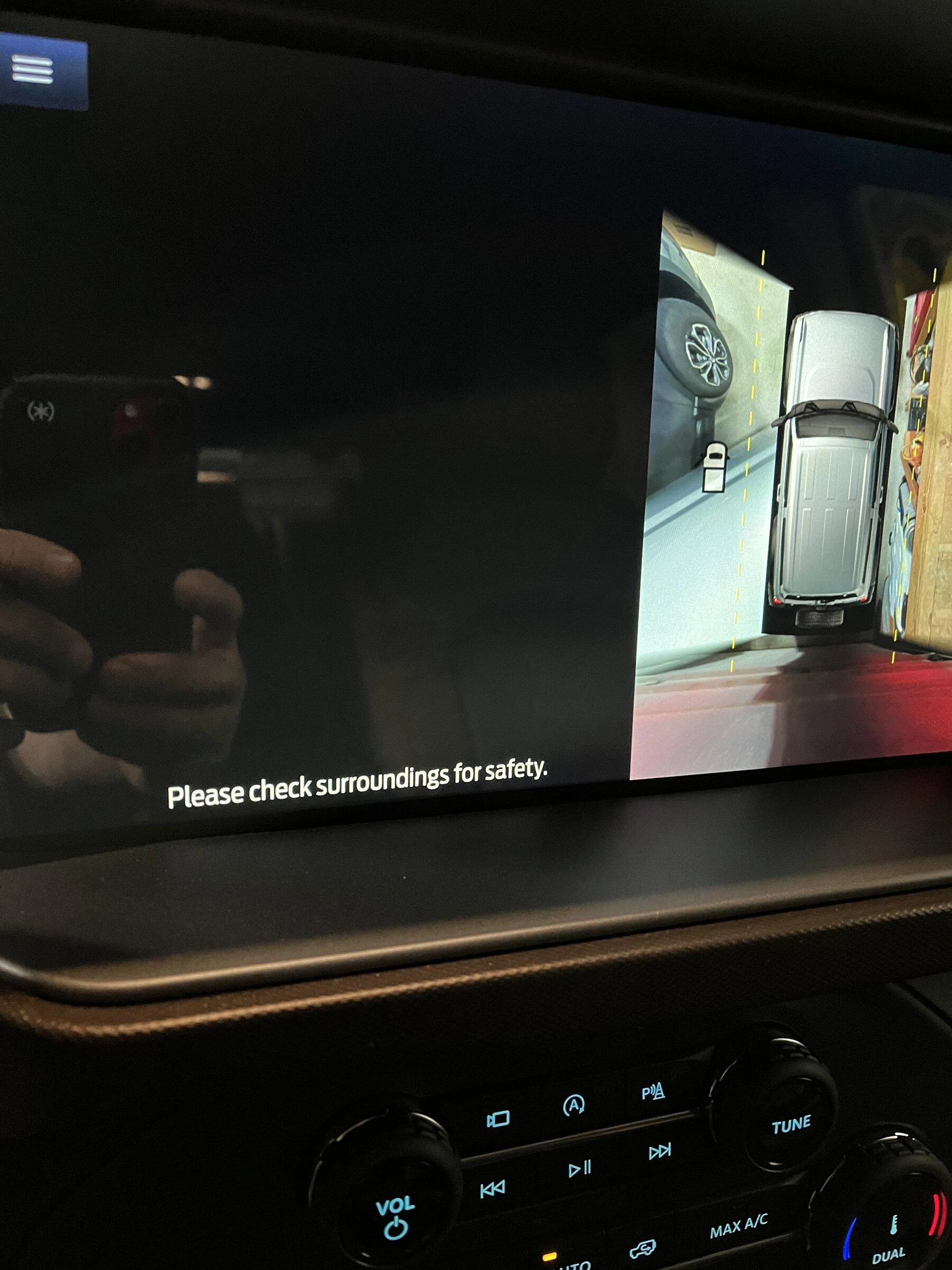

Thanks. I tried a reset. Will try the battery. Not sure I can get to the harness without taking a lot apart. Will call the dealer if battery doesn’t fix it. All the other cameras are fine and no warnings. Just black front screen.
I had the same issue with my 2022 Badlands. It was showing a 31 code - non communication with the module. The front camera is bad and needs to be replaced. It is a common problem with the Bronco's and the F series pickups.
They will replace and recalibrate the 360 cameras. Less than an hour total.
