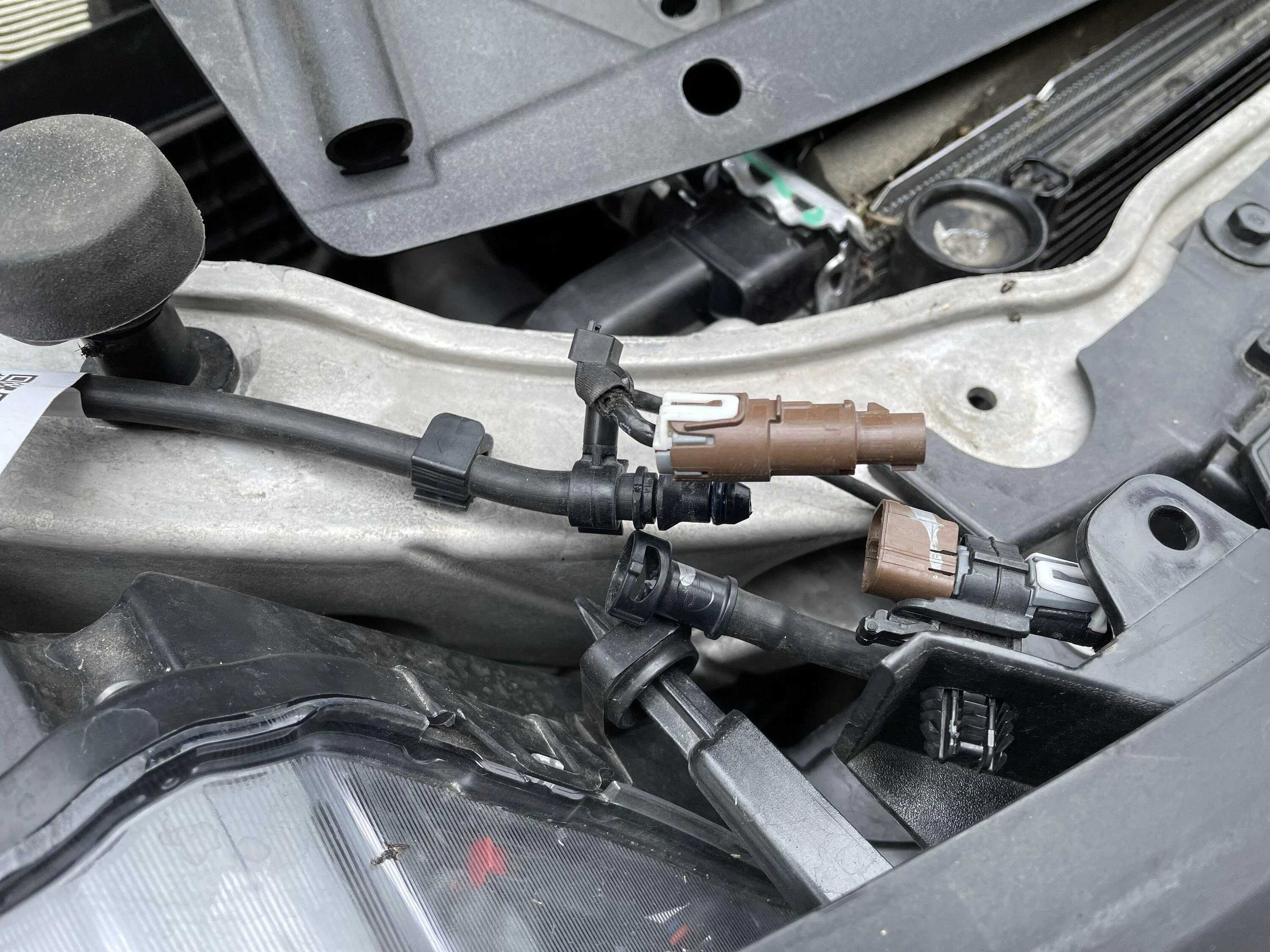

So the connection to the camera is on the passenger side at the top of the grill. The brown connector, it also has a fluid line for spraying the lens.
if you had any work done on the front end, check this
Is there any way to check to see if that brown connection is bad? I tried to put aftermarket lights on my girls bronco but they ended up being faulty when I put the original lights back in the camera won't work now I checked the brown connection and it's still connected
