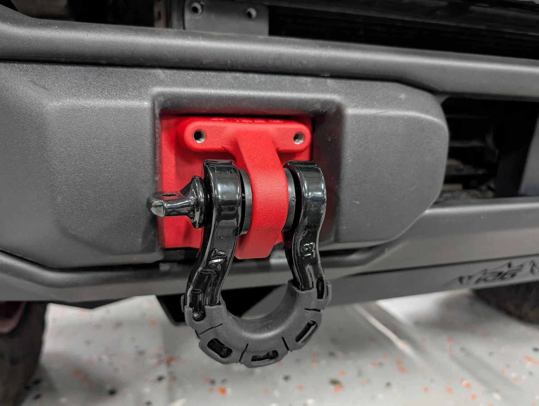

The ones I've looked at make you lose the recovery D rings and would like to keep those
If you have D-rings on your bumper, it's a metal 'capable' bumper, not plastic. In that case, we will be offering recovery points for that bumper that will replace the D-rings, but allow a spot for more standard shackles. They would work perfect for flat towing as they were tested and withstood over 4X the vehicles weight. We will be releasing the product starting at Super Celebration towards the end of April. They are 400 series stainless steel and will be available in black, red, orange and blue.

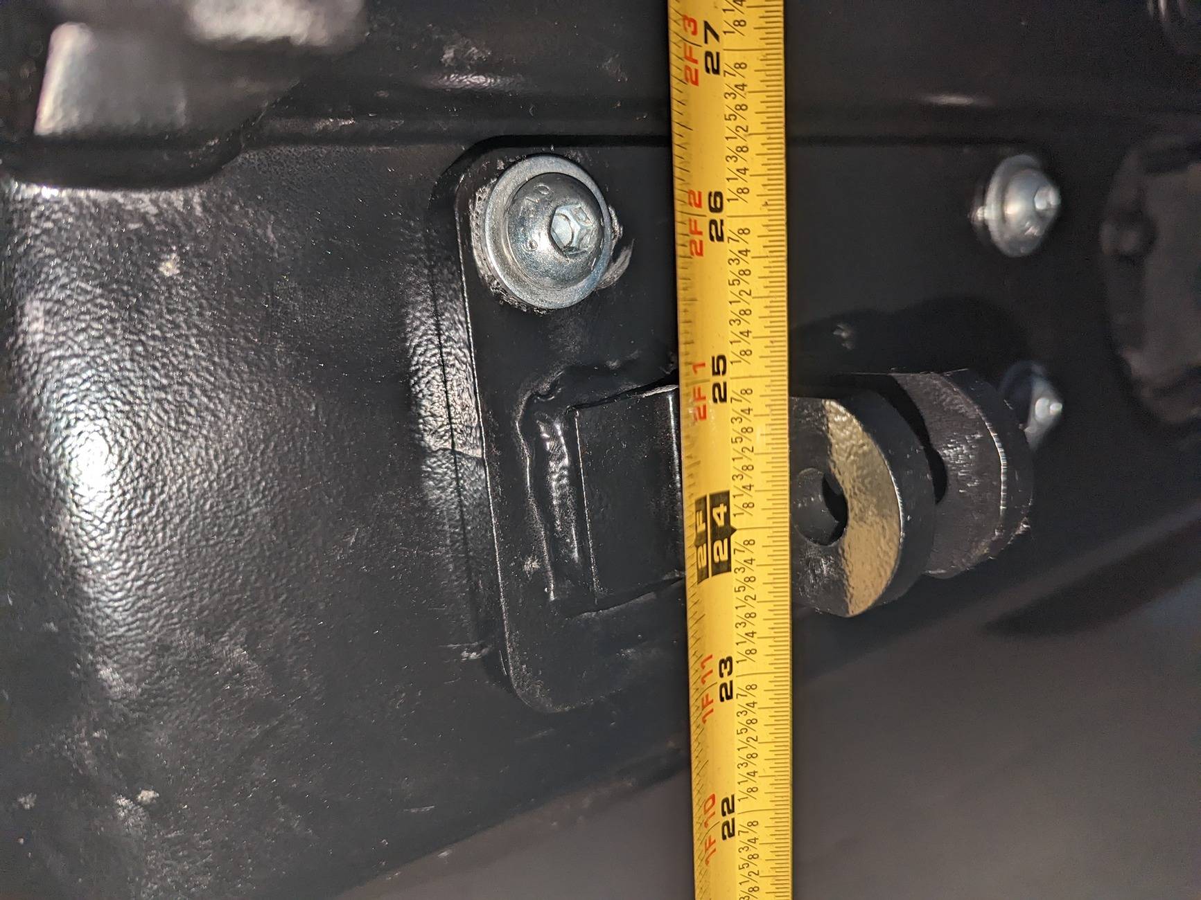

Most after market bumpers have a ring mount for shackles which could be used for flat towing depending on how much you trust them. I have a Black Horse (also sold as Barricade) that has shackle mounts. Then you just need tow bar to shackle mount adapters.
I got my Blue Ox bases before my bumper so I lost my tow loops, When I got the bumper I kept the Blue Ox bases and used Shackles on the bumper. An advantage to me is the Blue Ox bases are lower than the shackle mounts so it lines up with my Motorhome hitch better.

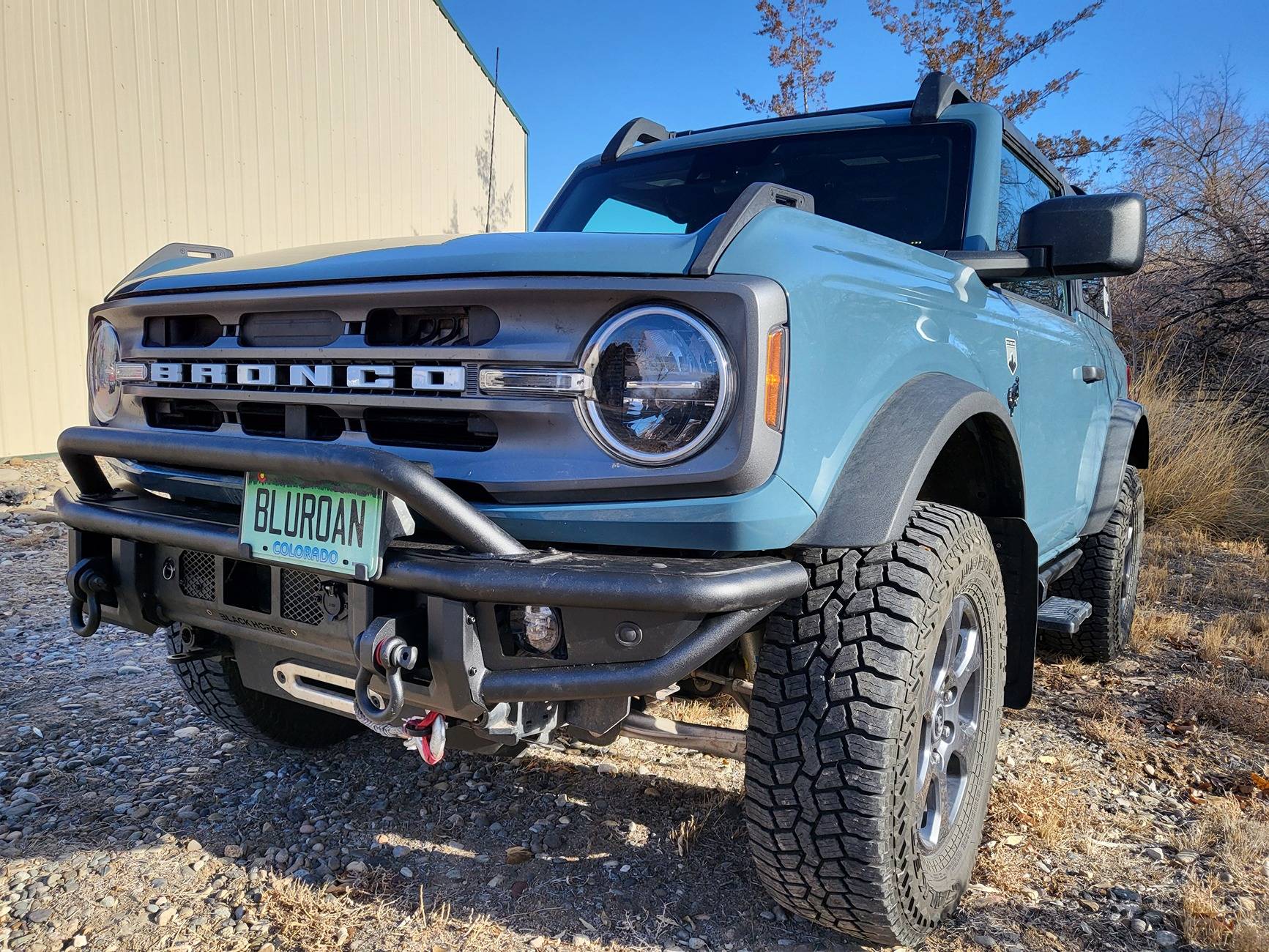

Thanks for the info do you have a pic of the bronco before you changed the bumper with the tow points?
dgorsett
Apr 3, 2019
5,048
10,105
colorado
F250, Mustang, Explorer
Sor
Ford Bronco Front bumper made for flat towing? 20220104_155202
ry being late to reply. Here is my set up before new bumper. Blue Ox bases with standard plastic bumper. New photos are Black Horse bumper, still with the same Blue Ox bases.

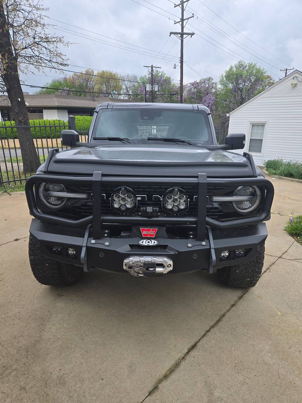

LOD off road is setup for flat towing. I have the bumper installed but haven't completed my setup.
