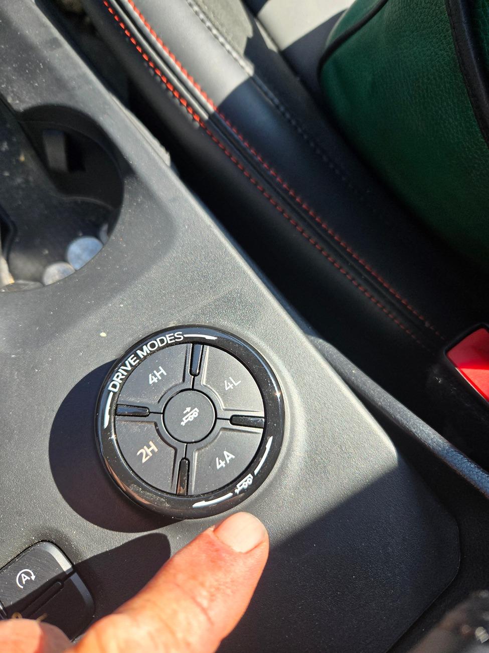

Yes it's possible but there are missing switches and modules to make it work correctly 100% for example the goat mode switch changes to a trailer steering switch like the F-150s in our Ranger Raptor...
So basically you use the goat mode like a mini steering wheel to steer your trailer as you back up

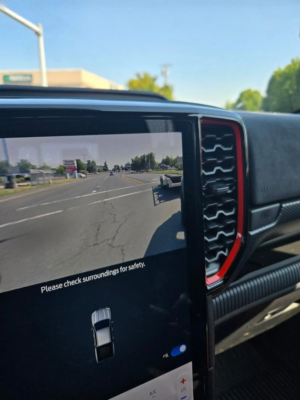

I believe they are all interconnected and connected to the camera functions as well. For example when you turn the blinker on you get a screen that shows the side of the trailer ...pretty nice I like this part the best.
