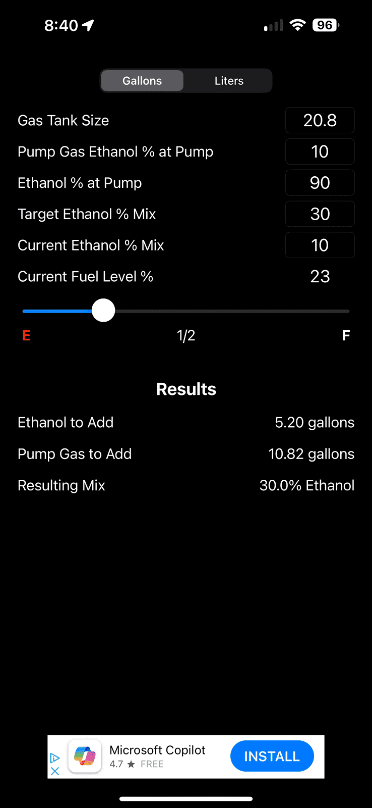

I use the e85Cal app and HP Tuners to see what the tank percentage is at and calculate the E content from there. It’s dead nuts accurate. For going to e30 this is what I’m going to use. Also depends on tank percentage.
And even the stock tune will add fuel to offset for the stoich change it’s going to see. E30 stoich is 13.0 and e10 pump gas is 14.08. The stock tune and fuel trims are more than capable of adding fuel to offset.
Ford Bronco Ford Performance Tune with E85? IMG_7934
Oh nice, very cool!
