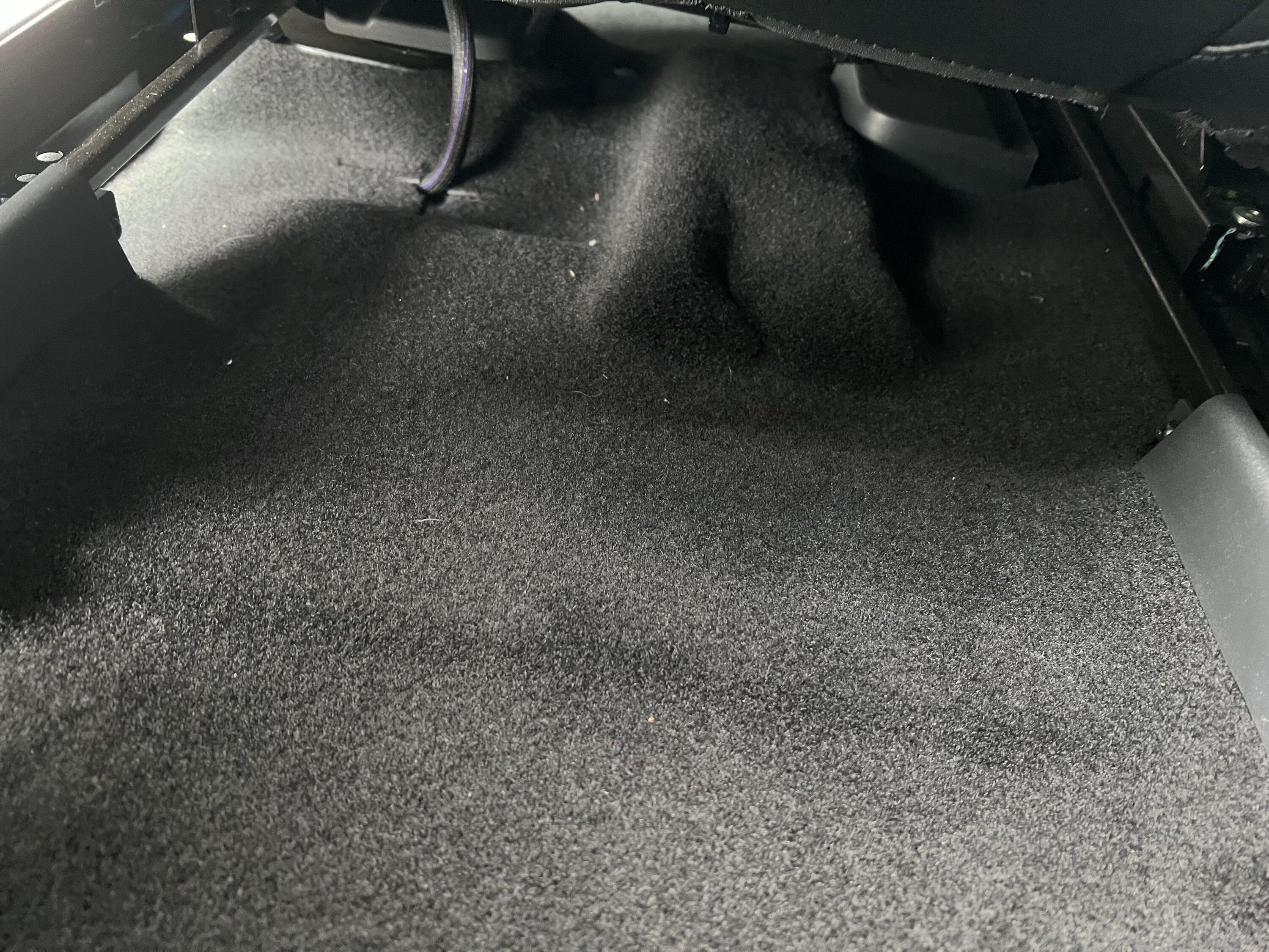

After reading this thread I checked the heat in my 2 door BL sas lux. I felt a little warmth coming out under the dash but nothing under the seat. I took a closer look and see the vent but it’s totally covered in carpet. Do the two doors even have heat for the back seat?

No rear vents at all in the 2-door afaik. Ford has a cap over the two vents to the rear in the 2-door model. Part #18K358

Wow ! Kids will be bummed.
I wonder if cutting a hole in the carpet and vent cap would get some heat to the back seats?

Maybe but you'd need to confirm all the intermediate pieces of trim exist, and I doubt Ford would supply unused pieces.
