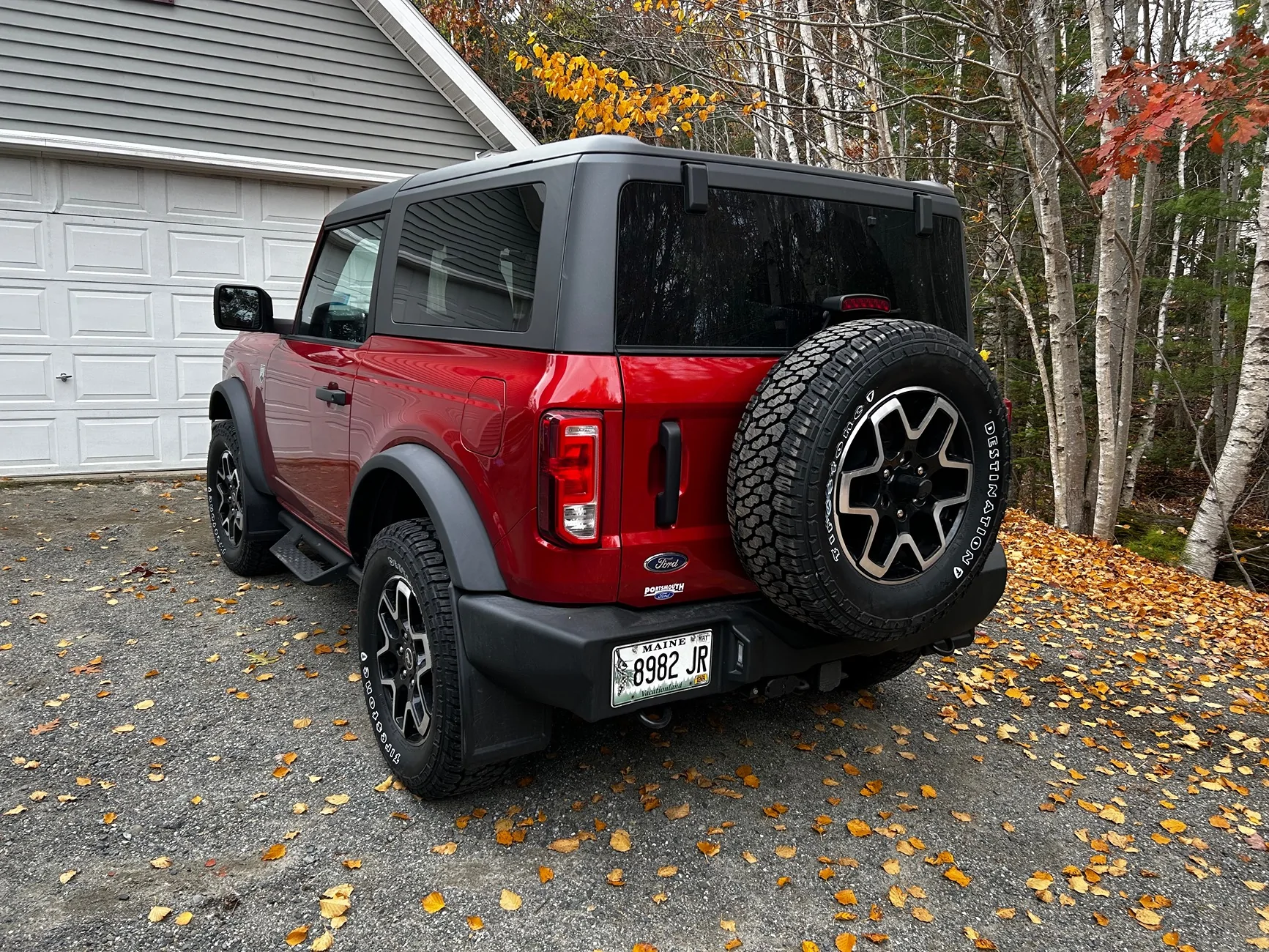

Whelp after a trip to Boston, 500 miles round trip, I decided to use the free 90 day test drive upgrade and ditch the Duelers. Even though I was going to just live with them, they were smooth about 70% of the time, but the trip to Boston was smooth down, but shook back, 110 miles, Smooth again for 80 miles and then I stopped to do an oil change (#1) at my sons house. It shook all the way home from warm tires and then 4 hours cooling in his gravel driveway and shaking all the way home. This stretch of road is super smooth and newly paved. So, I made the switch to the Firestone Destination XT. Why not? If I was going to have shaking, I might as well have an LT tire with aggressive tread. They do look great, resonably quiet and smooth at highway speeds. A little shaky around town with speeds 30-40 but I am sure a lot of mass on those wheels, I like them. They are nearly .25” wider tread width than the Dueler AT Ascents
