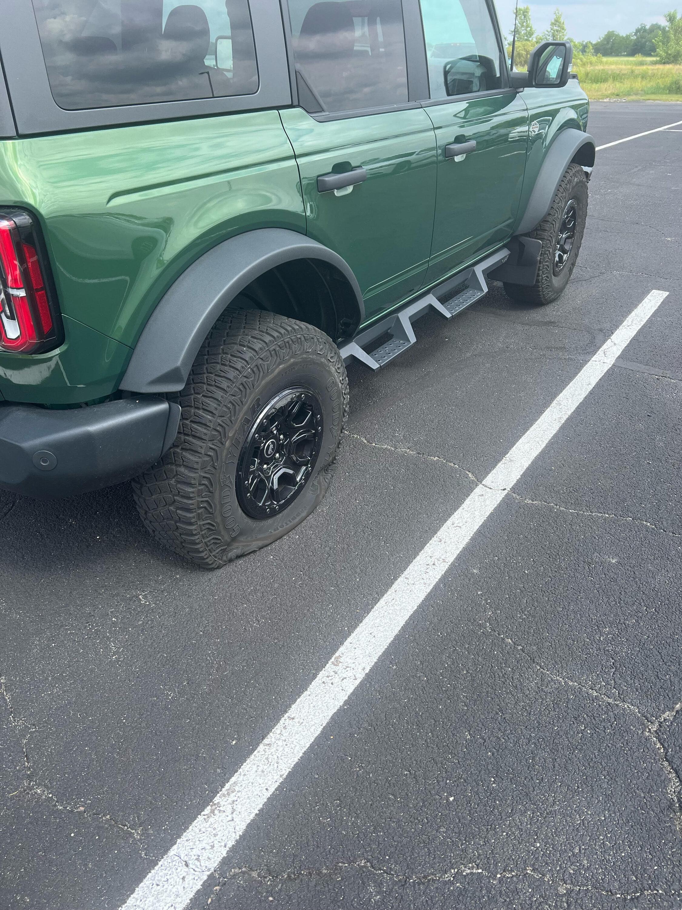

Monday at work I walked out to find my passenger side rear tire completely deflated on my 2022 Wildtrak. I have just shy of 22,000 miles on my Bronco and have been doing 5 tire rotation at every oil change since i got it back in January of 2022. I was able to take it into Ford and with my EasyCare Selcet+ coverage was able to get it replaced very easily.
My question for those of you who have more knowledge on the subject than i do is, how do i handle the new tire as far as my tire rotation goes? The service tech that I talked to recommended me that I go to a 4 tire rotation and then simply replace those 4 tires later on when they're worn out. I'd much rather maintain my 5 tire rotation in order to get more life out of the set I have, but is adding a brand new tire into the mix going to cause me more issues than its worth??

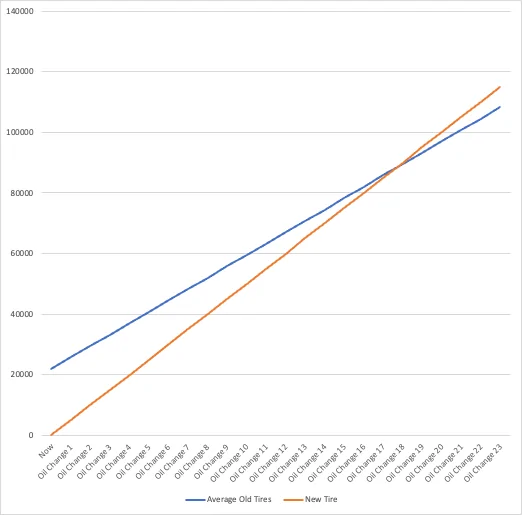

I'll throw in some math to backup my answer just cause I'm bored as heck at work, and if I use Excel it still looks like I'm working:
5000x + 0 = (15000x/4) + 22000
Solve for X...
x = 17.6
It'll take ~18 oil changes before the tires match again. And by that point the tires will all have ~87,000 miles on them. Given the lifespan of these tires are to 50,000 miles max, maybe 60,000 miles if you push it... it just doesn't make sense. By the time you make the tires match it'll be beyond their lifespan anyway.

And this doesn't even account for the fact that you'll have a goofy mismatch-feeling ride for the next 30,000 miles until the tires wear to roughly the same level.

going above and beyond for the people, RagnarKon, i love it! Thank you!!
