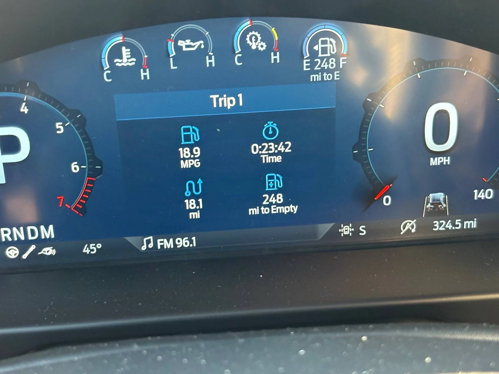

My wife has a crv and gets 31mpg. So I guess that’s why in into mpg more than I should be
did more testing.
at 56 mph I got 18.9 mpg
At 60 mpg I get 17.6 mpg
crazy 4 mph drops it 1.3 mpg
if your car is 30 mpg. Yes 1.3 is no biggy
a18 mpg car that’s like a 7% decrease over 4 mph
My message to ford. Design a 11 speed trans with an extra over drive to get 1500 rpm at 75 mph. Every state is 70/75 mph. Why not base mpg around it. Or maybe we get jimmy carter back and force speed limits back to 55 mph

Your mpg will be based on various factors, some of which you can control such as driving the speed limit, using start/stop and cruise control and driving conservatively. Other factors beyond your control include topography and environment such as driving into a head wind. Your vehicle is new so give it some time. My driving habits and topography yielded 17.9 mpg over the first 7000 miles on my Raptor. Of course most of that was flat country highways at 55 to 60 mph.

These EcoBoost engines love to spin. A lower gear with higher RPMs will likely yield better fuel economy than a higher gear with lower RPMs. It is all about keeping it out of boost.
If you are going to go down the rabbit hole, then watch your boost gauge.

C’mon man you should know this by now, it’s a brick that you are driving.
For Jeeps & Broncos calculation goes spg smiles per gallons not mpg.
Even Ford can’t do anything about fuel economy that’s why they created baby bronco with 29mpg for mpg conscious consumer.

Mine's not a Raptor, but I average 17.5 - 18 mpg at 80. on the open road with the 2.7.
I did get 12 mpg on one highway trip, but that was pulling a 2500 lb. box trailer at 80.
Also keep in mind that mileage will tend to improve (slightly) after you get a few thousand miles on the clock.
A Bronco is not very aerodynamic. You will never see the same mileage as a sleeker vehicle no matter what engine they put in one.

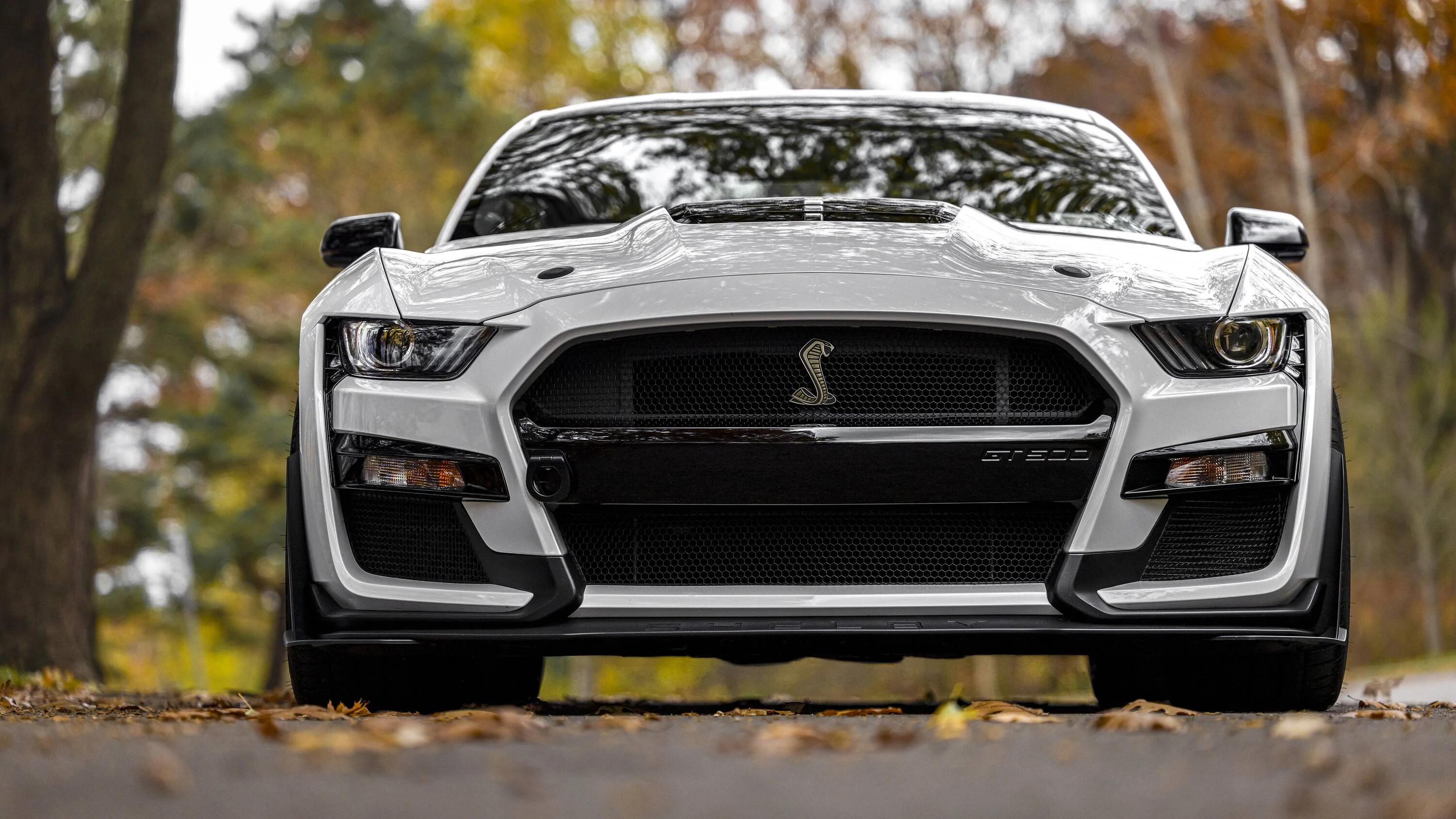

Gt500 gets 24mpg on long trips
My GT500 comes in at 12.5mpg on trips and I've done half a dozen ~1,200 mile, straight through drives with it. I hauled ass throughout. I have no clue how you could possibly get 24mpg.

Gt500 at 65 mph is at 1500 rpm in 6th gear
It’s rated at 24 highway also I believe.
it was able to avoid the gas guzzler tax while the hellcat didn’t
