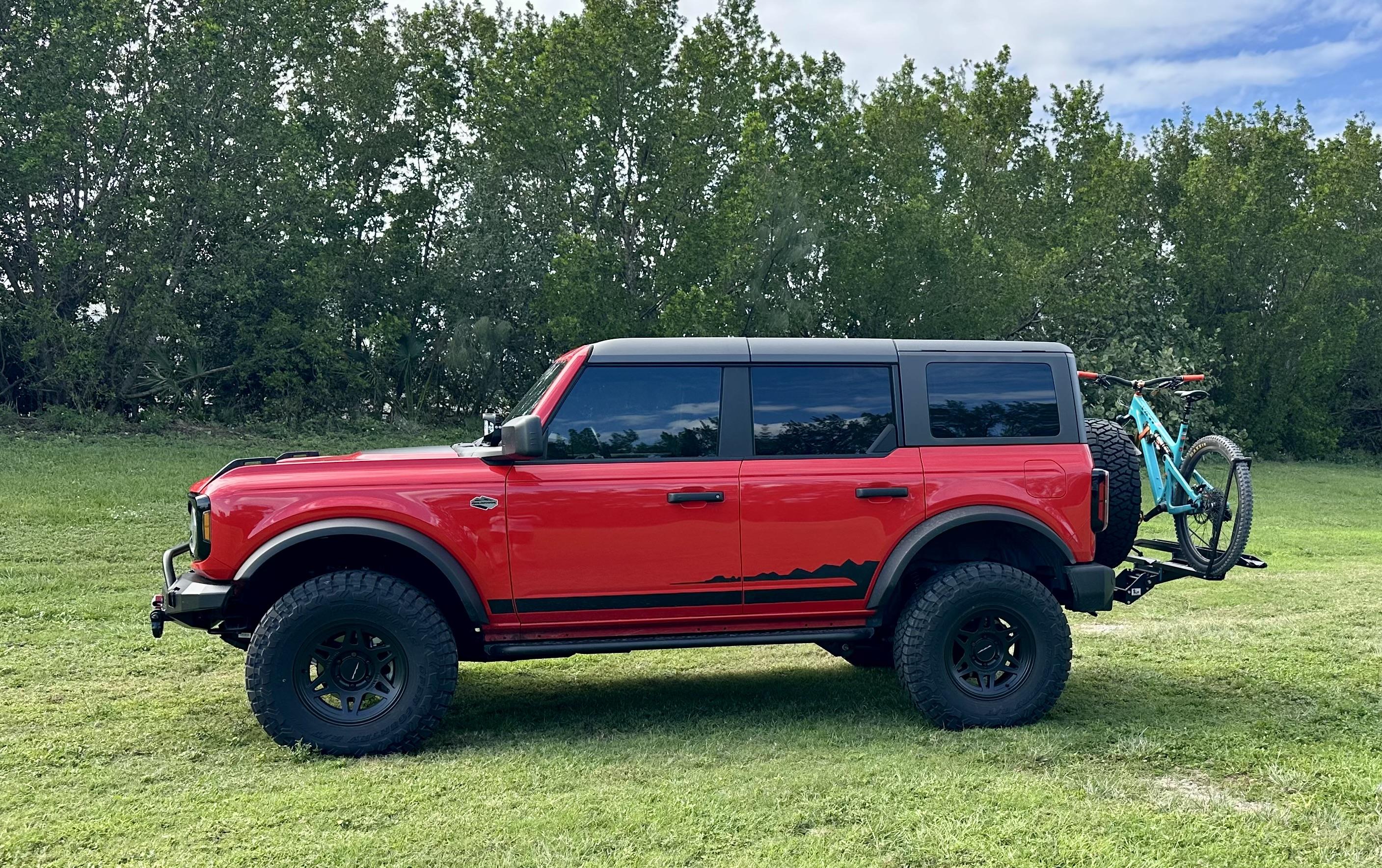

My full Dobinsons setup (springs and shocks). The shock bodies are adjustable for height. Rides great and restored my ride height and then some.
Ford Bronco Finally Found HD Rear Springs That Work IMG_6814
Graham1911
Tommy
Apr 22, 2022
279
673
Prosper, TX
2022 Ford Bronco
Great to hear. I was curious about the ride quality of the shocks.
