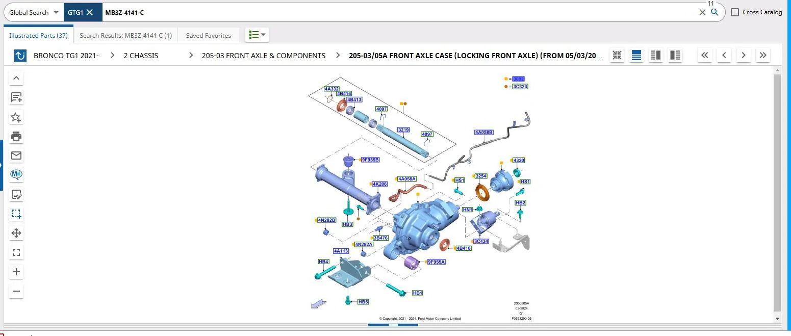

Ford just doesn't have their stock photo people on top of things so the one from our parts site, Revolution, I believe uses Motors for their images. The one below is from Microcat and the FDU comes with all of the items with the orange square next to them.
No idea what the difference is beside price and that Ford Performance is selling. Not sure what the warranty is on the FP but buying the "Ford" part, you get a 2yr/unlimited mileage warranty like all Ford parts. $1,500 is the list price, 6G members get a better deal BUT the shipping would eat up any savings due to weight.
