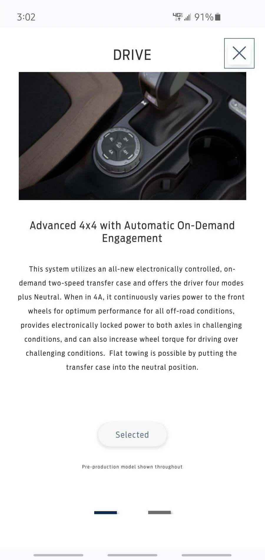

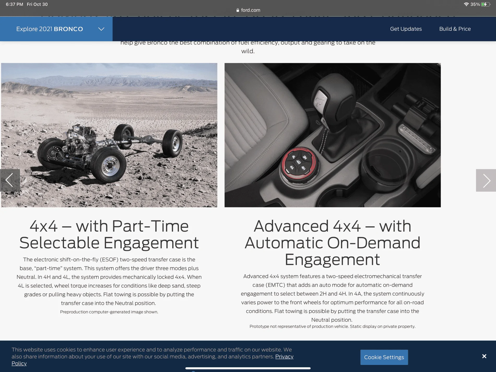

When I did my BD build (2.7/Auto) there was a $795 difference between Part Time 4X4 and the Advanced Auto TC. The reason I was looking close is I need to flat tow and it looks like only the Part-time can do that, which SUCKS!!
UPDATED: I was right. Read the image to the right. You can use the Advanced!!! Thank God!!
I do not think that is correct. Where did you see that ? That should not make any difference when you flat tow.. Please correct me if I am wrong. I also need to flat tow and plan on getting a BL
*Corrected* There was no scroll indicator on my screen and I didn't see the last line on the advance which stated it was towable, all good :)
