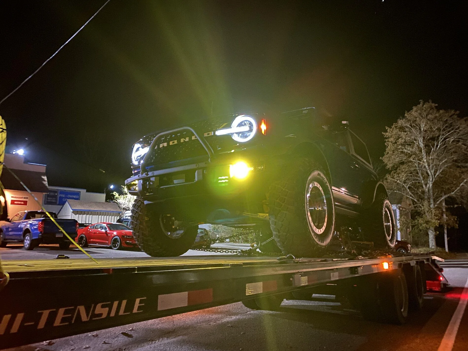

Can confirm they work with the switch I used! Lights up on the dash as well correctly!
The one thing I for some reason expected, but was not a feature of the switch, was for the fog symbol to "illuminate". Instead you see it on the screen (as long as you enabled that). Was like the expectation of the PRNDM being lit next to the shifter...

Beautiful work. Did you enable Forscan so your fog lights would work???
Yup, I did the changes mentioned earlier in the thread.

Ok. The slow kid is confused again.
I thought the existing wired up connectors on the Bronco are female connectors and IF one did not want to alter the factory wiring, one would have to make the wiring from the fogs have a male end.
One could do so either by reusing the weather plugs (with alteration) that exist to seal off the harness connectors
Or by buying some of the correct male connectors with pigtails.
the connectors i posted would be the mail connectors that plug into the wiring harness ends that are for the fog lights
Thank you that clarification. Definitely don't look "male" but hey its a different world than the one I grew up in!
these connectors have the metal pins that insert into the other connector.. thats usually definition of male... lol.. inserting something into something else.. :)
Sorry which switch did you get? I have the same rig. Only looking for the front fog...is it the M2DZ-11654-DA?

This part looks a little bigger than what exists in my First Edition. Is it the correct size? Would you happen to have a picture of what the unit looks like installed?
Yup that’s it, direct swap with the original unit.
