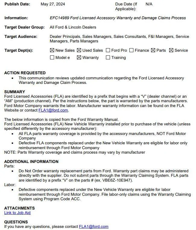

Have your dealer look up EFC14989. Its the warranty claim process for a Ford Licensed Accessory.
I'll call them today! Thanks!
I don't know if the Ford reps are still on this forum, but why aren't service reps trained on this process? Rhetorical.
