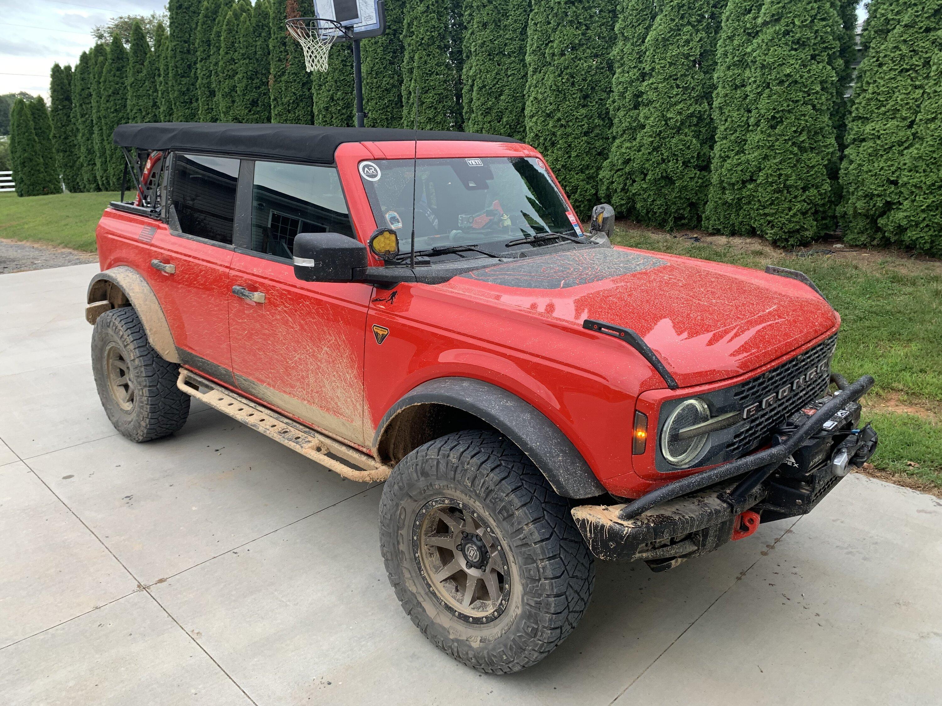

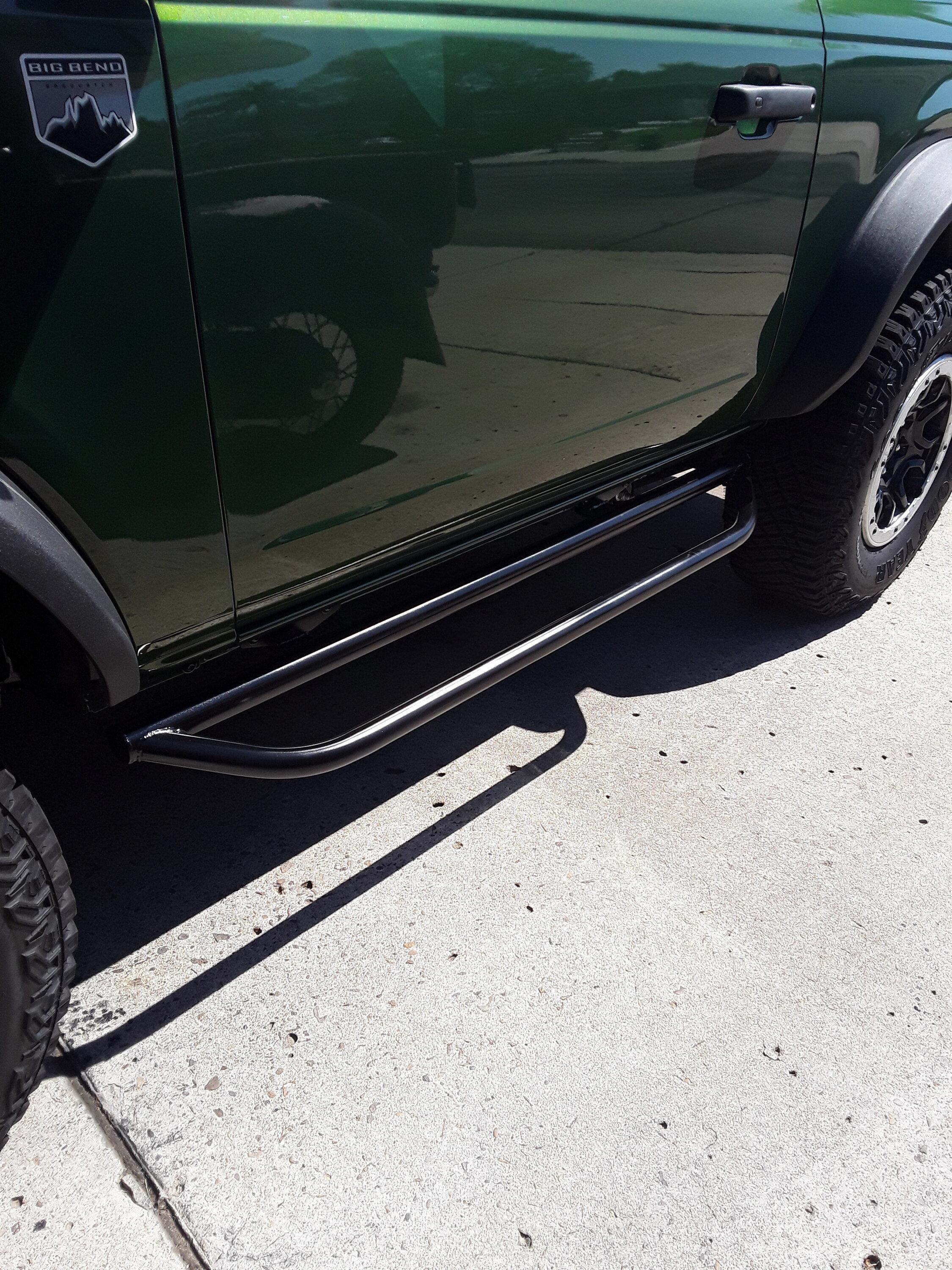

Let's see the crawler. 😁
BTW looks like they just bend up some tube and welded it to the OEM rock sliders. Kinda like what @Tricky Dick did with his.
I tried to post, not sure if it worked I’m not good at this stuff
If this works well for you as a step but looks this minimal PLEASE share details. I love the look.
it was a custom build.

The body mounts are actually pretty impressive. Like I said I’m not going to hammer it on the rocks. I have other toys for that
Nice!!! (y)(y) KOH 23 less than three weeks away. 😁

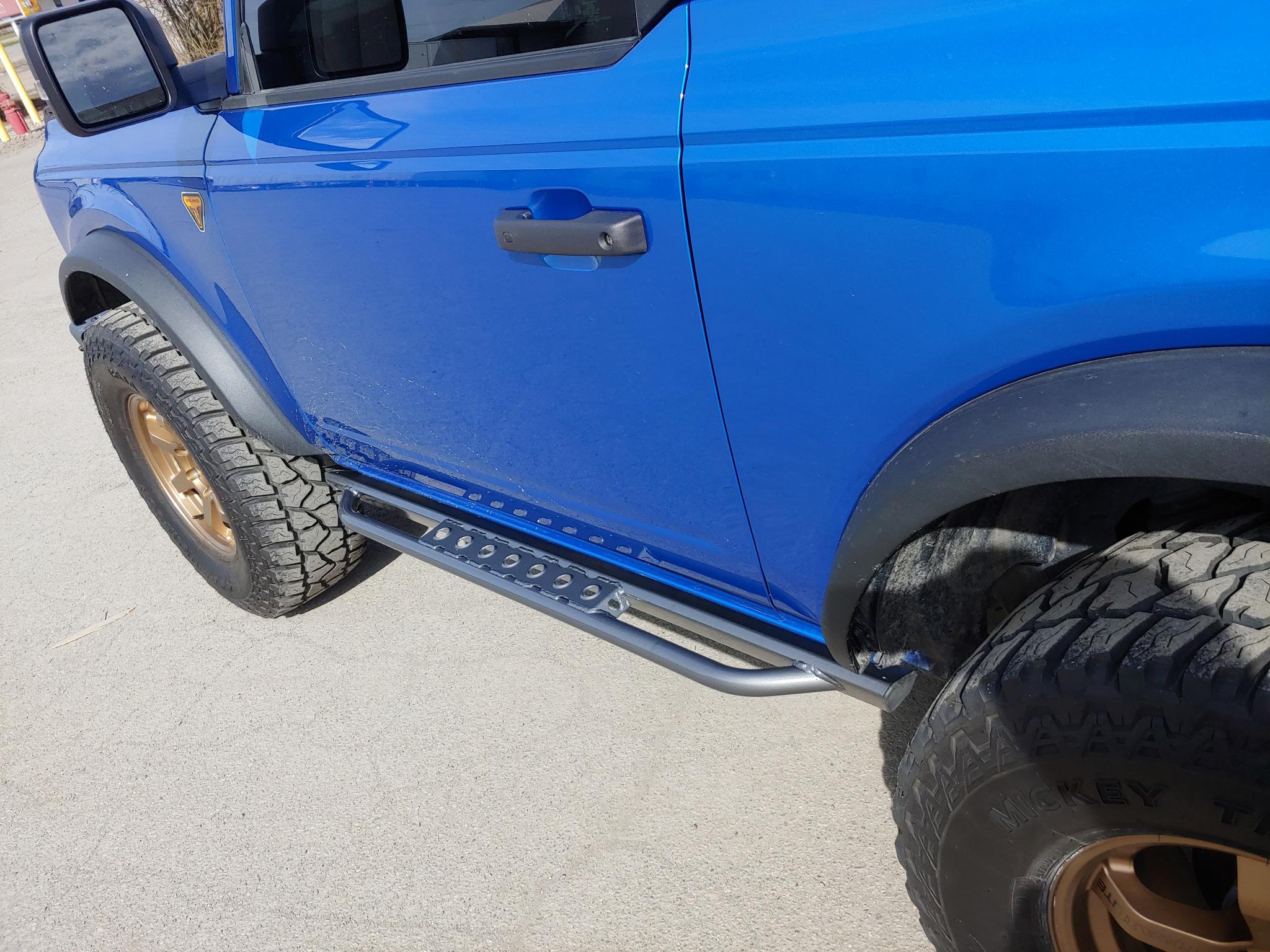

I did the same sometime in the last year or two. Been a while.
Held up fine.
Function as a "Step"? Mostly. Better than no step or ones that clamp on and hang down a lot.
Function as a slider? Yes. I've had the weight of the Bronco on them.
Function as a "pivot off O' that yonder tree?" Affirmative.
Function as a "Dangit, Bobby I slid off of that ledge and hit the slider on a rock."? Yessir.
YMMV. I do not trust them for high speed crashing, pivoting around Redwoods at 50mph, or anything else that may be or viewed as illegal in 39 states.
But for a slider/step/door-ding stopper-getter? A-ok.

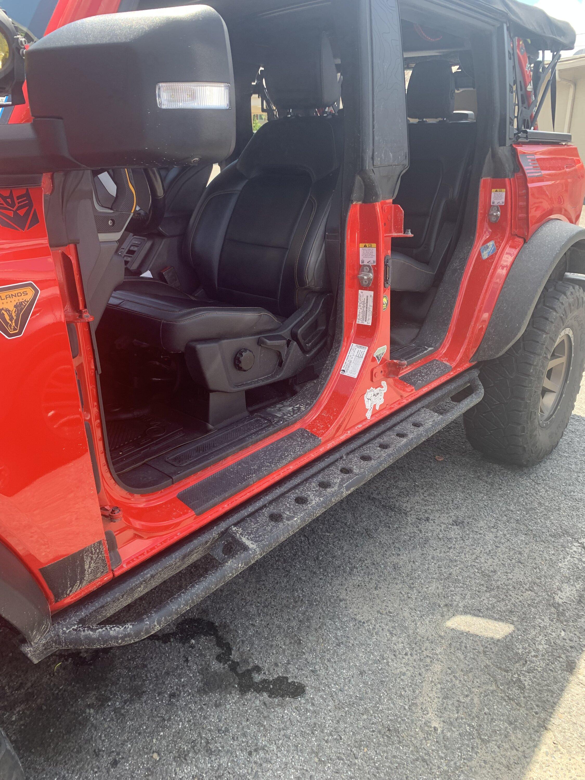

Great to know. Got any pics of how far you came out with the tube? I am probably going to copy Tricky Dicks setup like below:
Ford Bronco Fabricated own rock sliders 277437017_4951674794914507_842166361458727718_n
But obviously 2 steps vs 1 and maybe a single connector in the middle as well like @#1Broncogirl did. I have spare 3/16 sheet laying around so I just need a stick of tube and some dimple dies and I'm looking at a set of sliders for $300 all in. Things I am taking into consideration of course are I doubt Ford had engineered these mounts to deal with the extra leverage bumping this slider out will cause so I likely won't be pivoting off these often. But if it saves a rocker from a drop off I may not have seen or just makes me feel better about taking this truck into rockier stuff I think I'll be happy with it. Plus anytime I bust out the welder I am enjoying myself.
I pretty much did what Tricky did.
Mine are angled down ever so slightly.
Enough that you can tell it when stepping on it with slick shoes in mud.
In retrospect I should have angled up.
I bought a set of 4dr weld on tubes for a JK and made my own dimple die plates, welded everything on, epoxy primer and Raptor Liner.
pretty pleased so far. They’ve done their job and when they no longer do I’ll fab up something heavier duty.

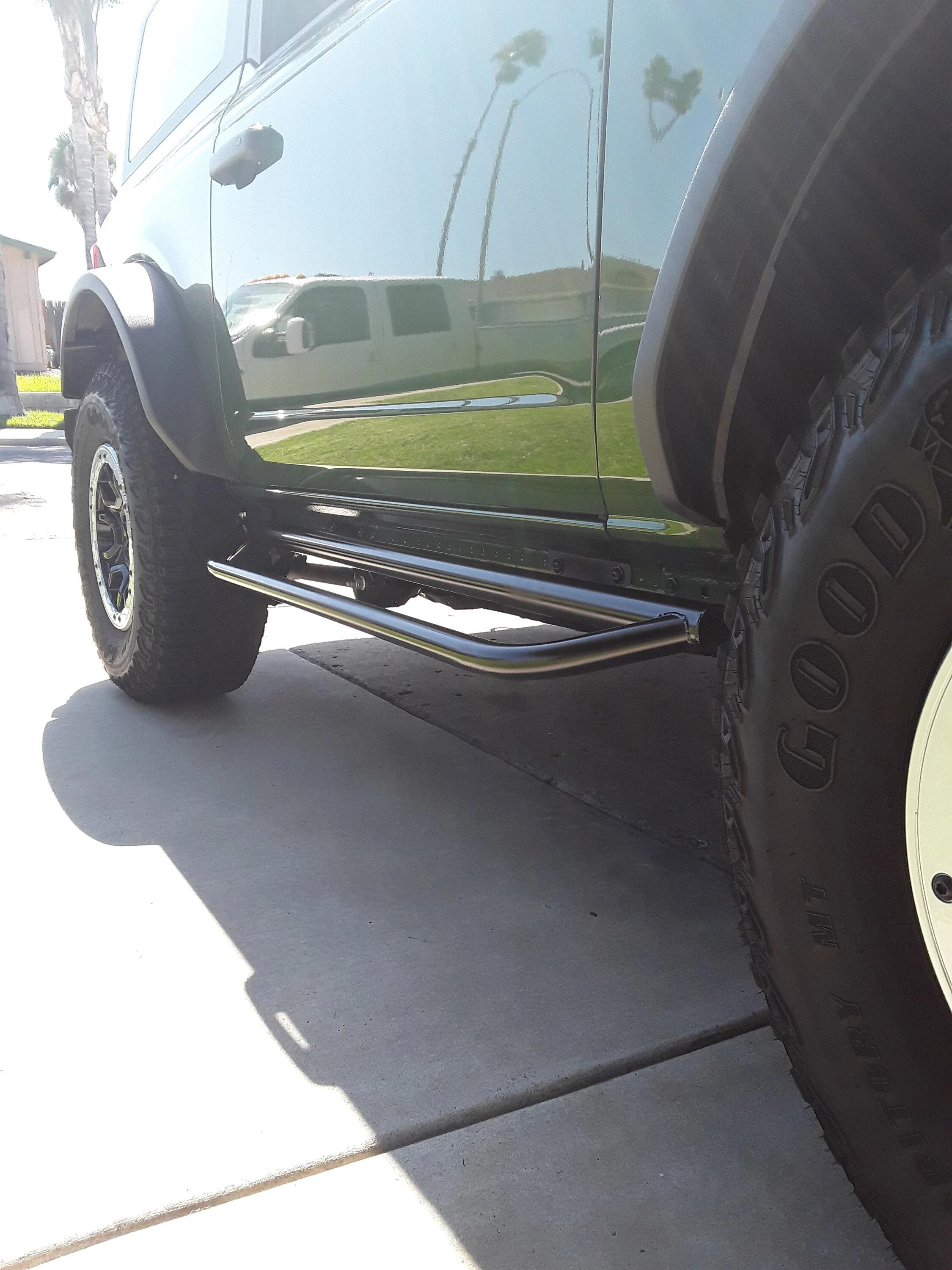

I mainly got them for the occasional rock, or tree trunk slip on the trail. And parking lot door ding-bats! And they make a good step
This was my same thinking when I made these up
