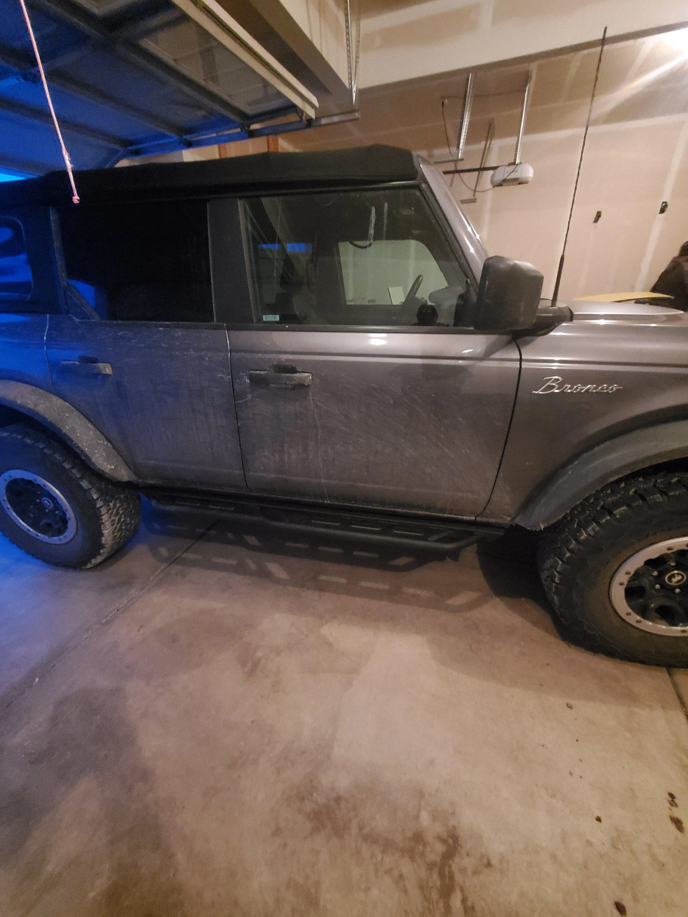

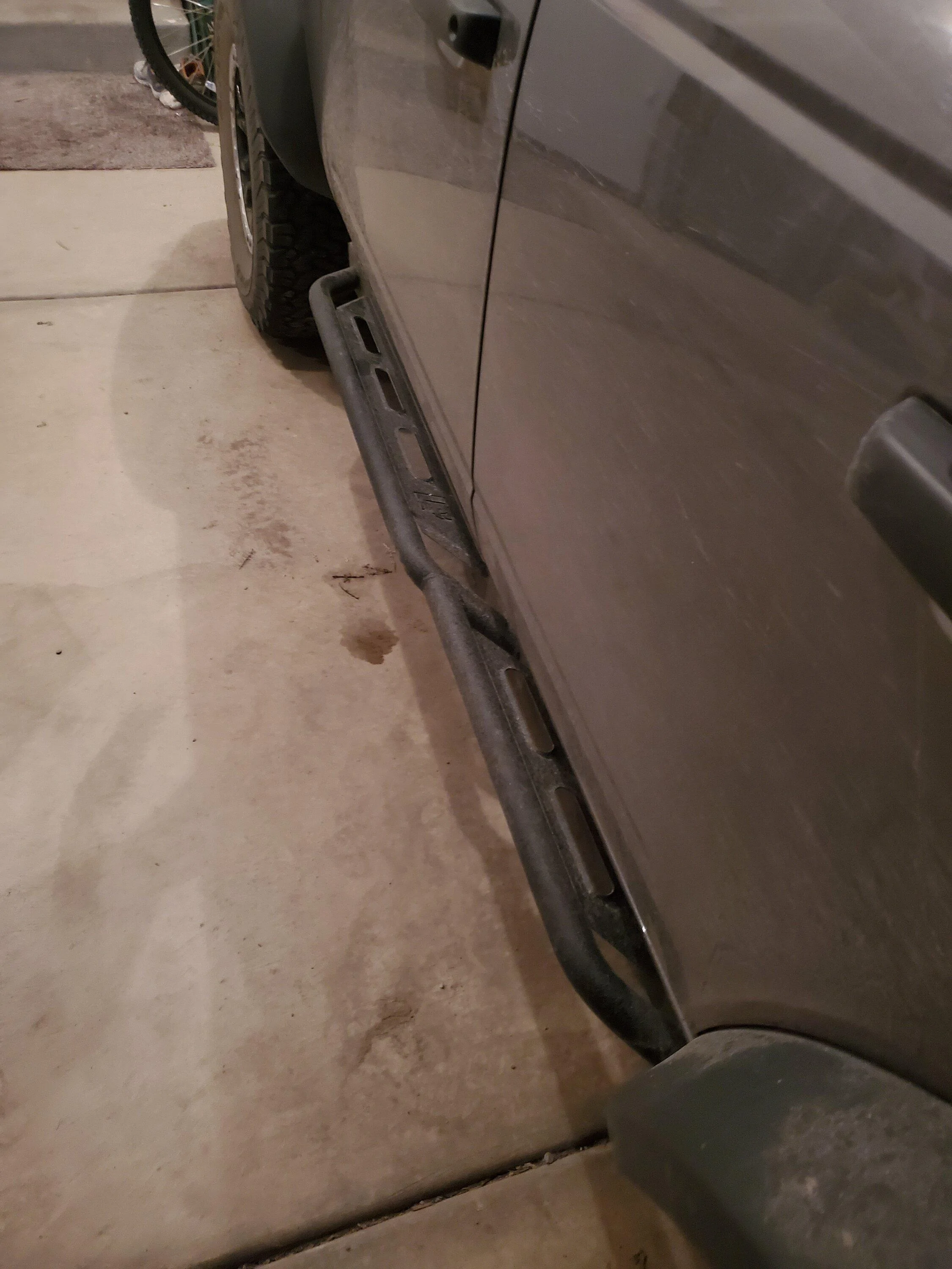

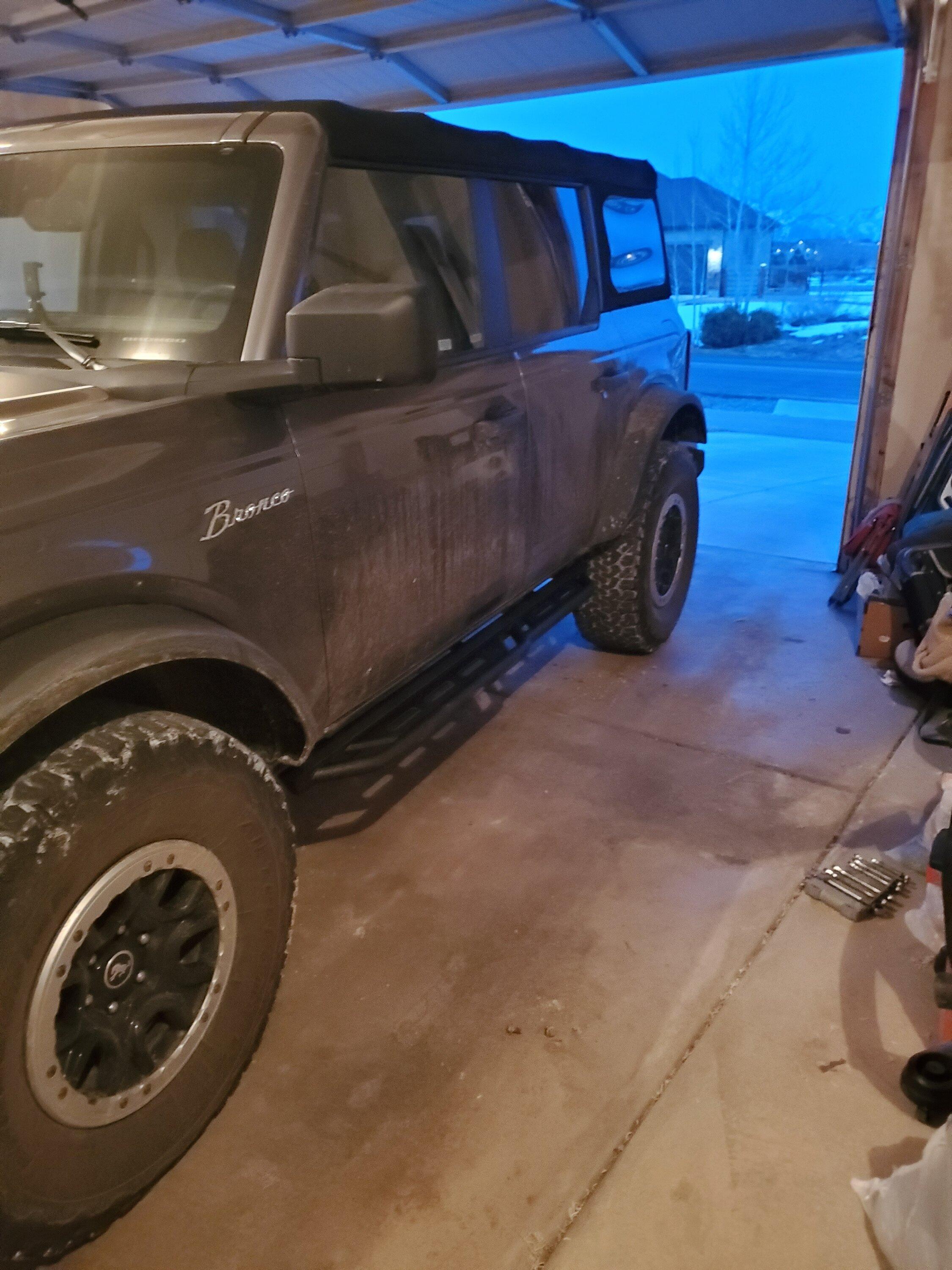

I decided to give these a try since they were affordable and I like the look of them. They were delivered yesterday and install was very easy and took around an hour. The bottom is 3/4" higher than the factory steps and my daughter was able to use them as a step still. It doesn't list how thick the metal is on Amazon so I'll see how they hold up to rocks.

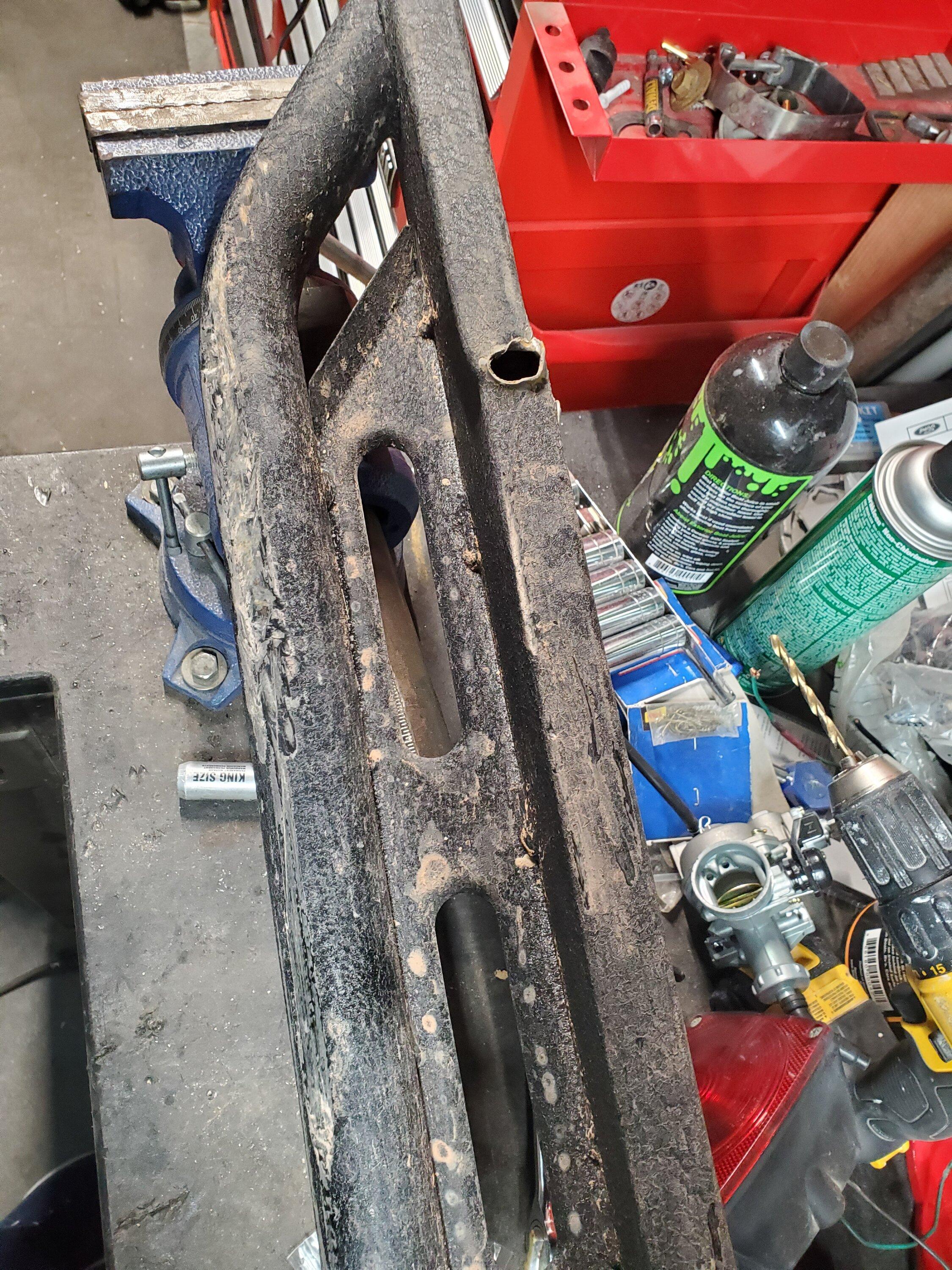

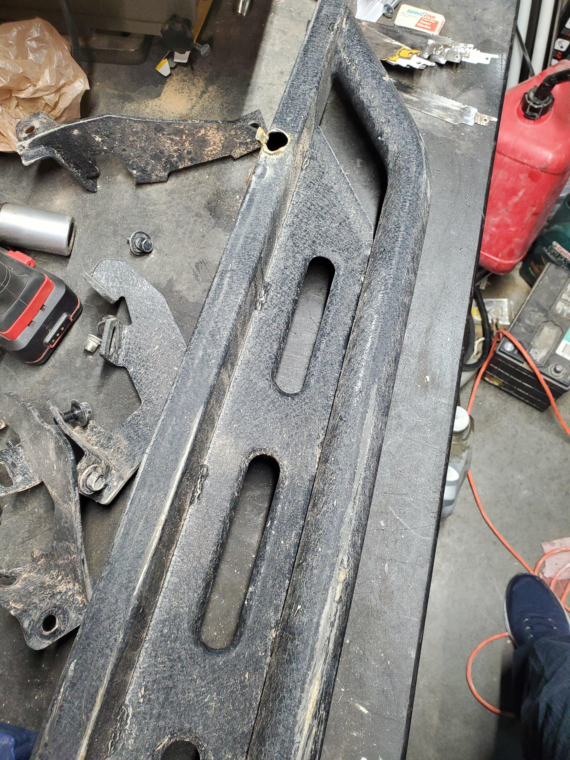

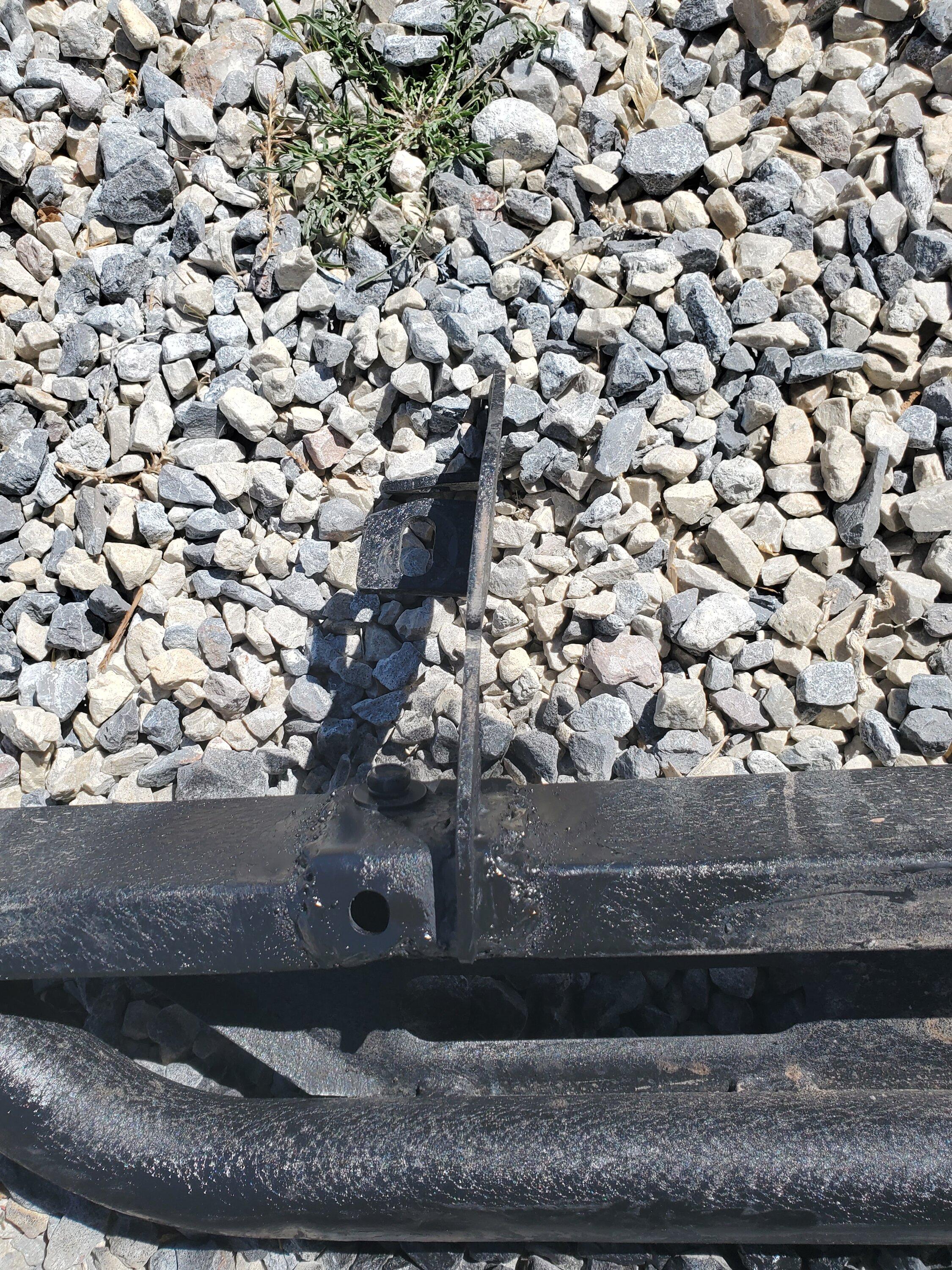

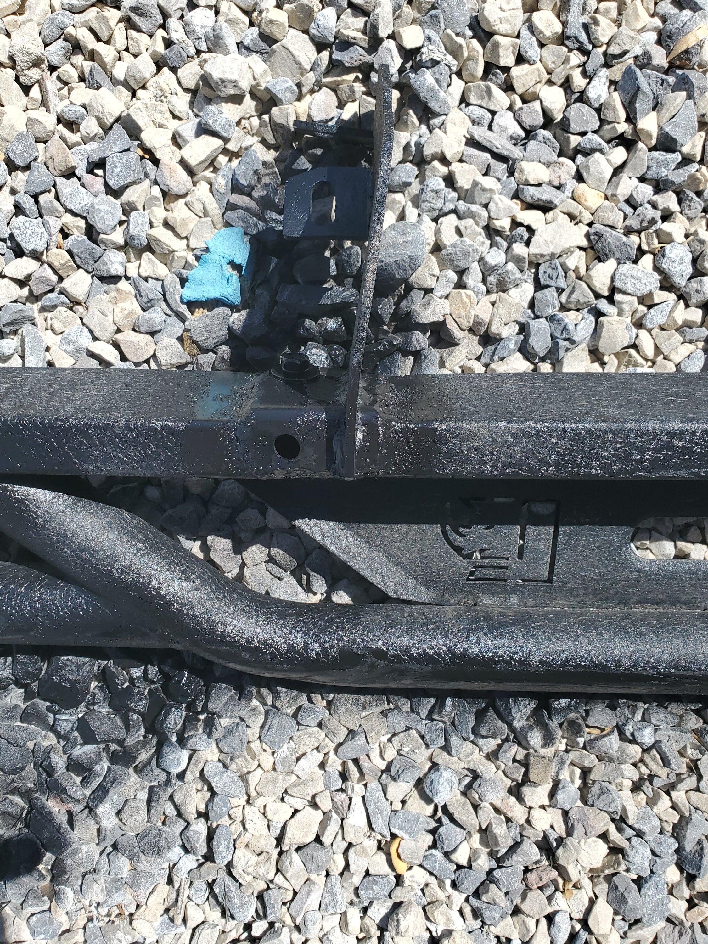

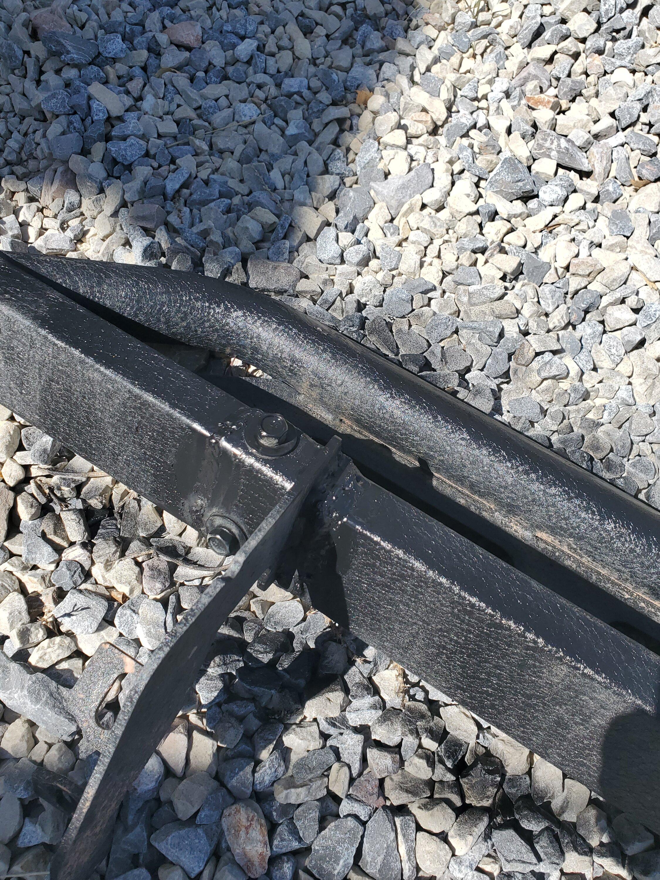

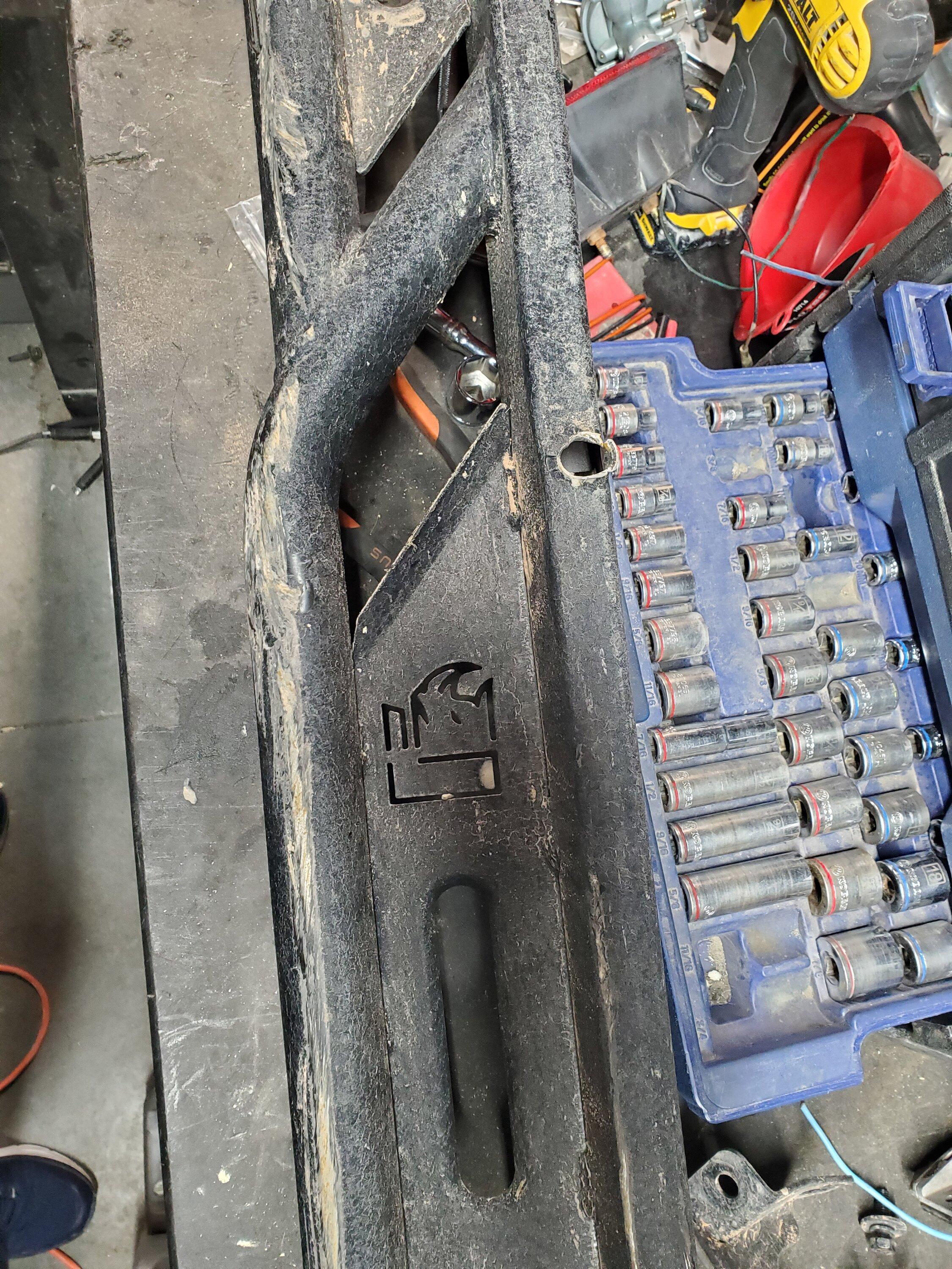

After unbolting the sliders the 1 that had all the weight on it ripped the nutzerts out of all 3 brackets (just the bottom 1) so I bent the brackets back in shape and tightened the remaining bolts and welded the brackets on the slider side and the metal was thick enough to weld to without burning through it (other than on the hottest setting which did burn through some). I think the brackets bent because the nutzerts came out which allowed them to move so hopefully this will work out for a while at least.
