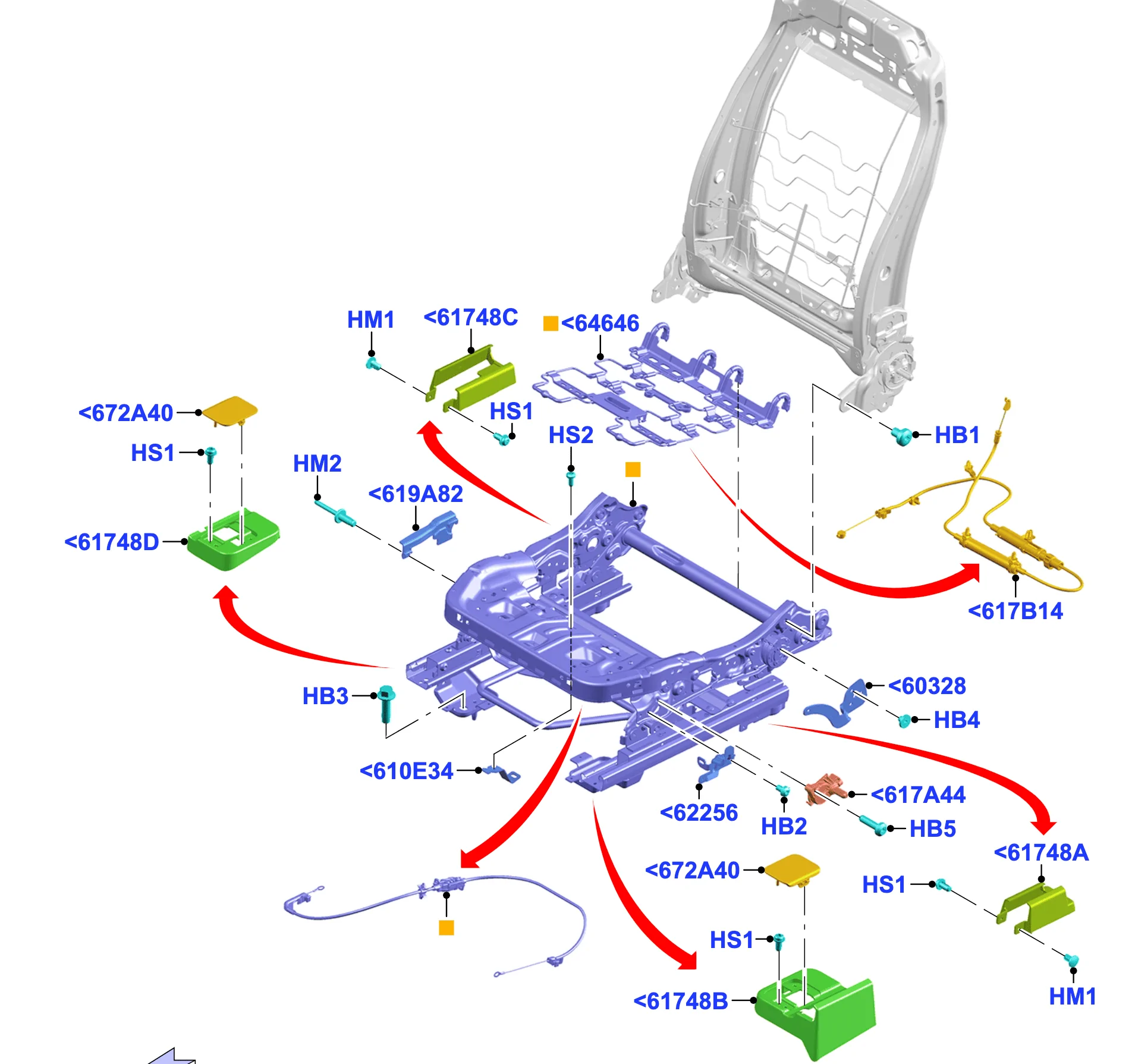

Long bolt looks like restraint system impact sensor retainer. Torx head bolt with thread lock secures the seat backs to the bases at the recline position, and the black push pin retains carpet/mats in various places to the floorboard or under the console.
The seat is interesting. A number of seemingly similar bolts like HB1 and HB3 in the diagram. Will dig deeper.

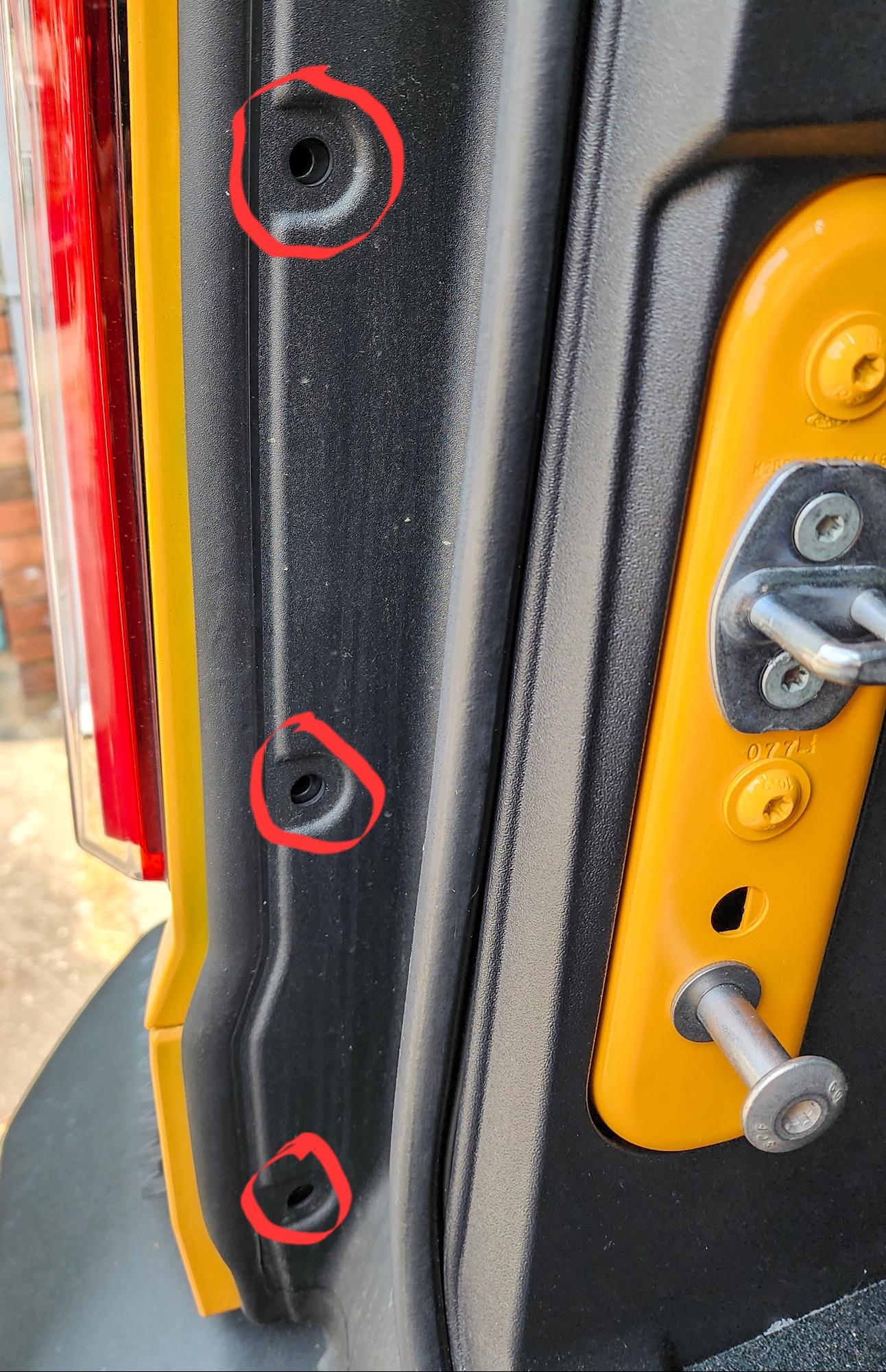

These take those funky little push pins with the Phillips head, you can probably find something better at Autozone, 4 per side

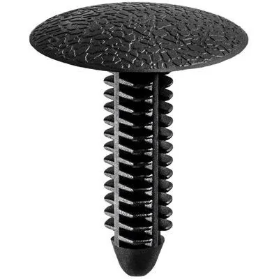

Black plastic one on upper right is a "trim fastener" used to fasten one plastic panel to another.
For example i just installed a "hush panel" under my glove box. This is a roughly rectangle piece of trim that hides the blower fan and other noise making parts. The factory didn't have hush panels that day -- so shipped without one.
I pushed the hush panel into place with two bottom guide slots and then used two of those black items to snap it into place.
Ford Trim Fastener
