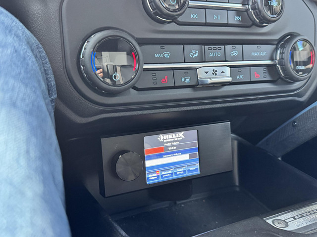

Appreciate the detailed response, your setup looks great too! I have the Helix Conductor mounted up front next to the USB port, which is connected directly to the Helix V Eight DSP. From what I understand, the Helix USB interface is installed directly into the V Eight and I will have to run a USB C cable from the cargo area to the front. If the audio quality is much better this way than with the Bluetooth module, I would rather do that. I just need to get a long USB C cable... would 12 feet be enough?

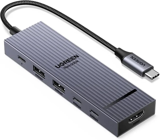

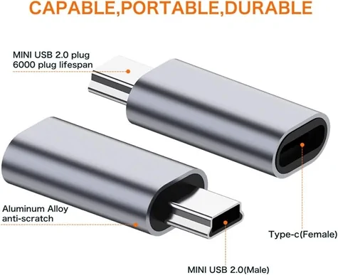

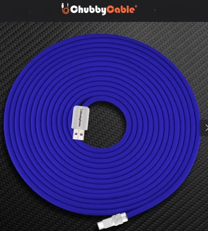

Ordered the Helix USB Interface yesterday from the audio shop and also got a mini-USB-to-USB-C adapter, a 20-foot USB-C cable from Chubby Cable, and a UGreen USB-C hub. I'm excited to hear the difference! The Bluetooth module is great too, and most people probably can't hear a difference in audio quality between Bluetooth and USB, but I want the satisfaction of knowing that I have the best connection possible. I added links and photos of the accessories I ordered... let me know what you think!
Adapter: https://www.amazon.com/dp/B07TLBTXXJ
Cable: https://chubbycable.com/products/ch...ds-longest-fast-charge?variant=42268610592954
USB Hub:
https://www.amazon.com/dp/B0D1XLNWP2
Ford Bronco Experience with Helix HEC BT HD? adapter
Ford Bronco Experience with Helix HEC BT HD? cabl
Ford Bronco Experience with Helix HEC BT HD? hu
