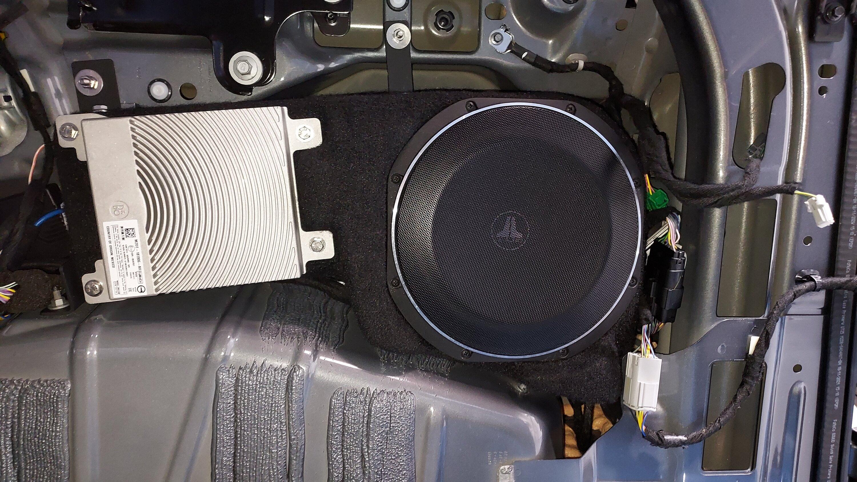

I actually don't know the answer to either just yet. I haven't begun the disassembly yet.
If it fits with whatever subwoofer option I go with, I will use the factory location. I'm keeping an eye on the JL Stealthbox, but god knows how long until that is available. I'd rather not cramp the cargo space with a tailgate enclosure.
Way cool! How does it compare in size to the factory amp? Are you planning on mounting it in the same location?

Agreed. Looks like the Stealthbox should accommodate the factory amp (and hopefully others), too.
