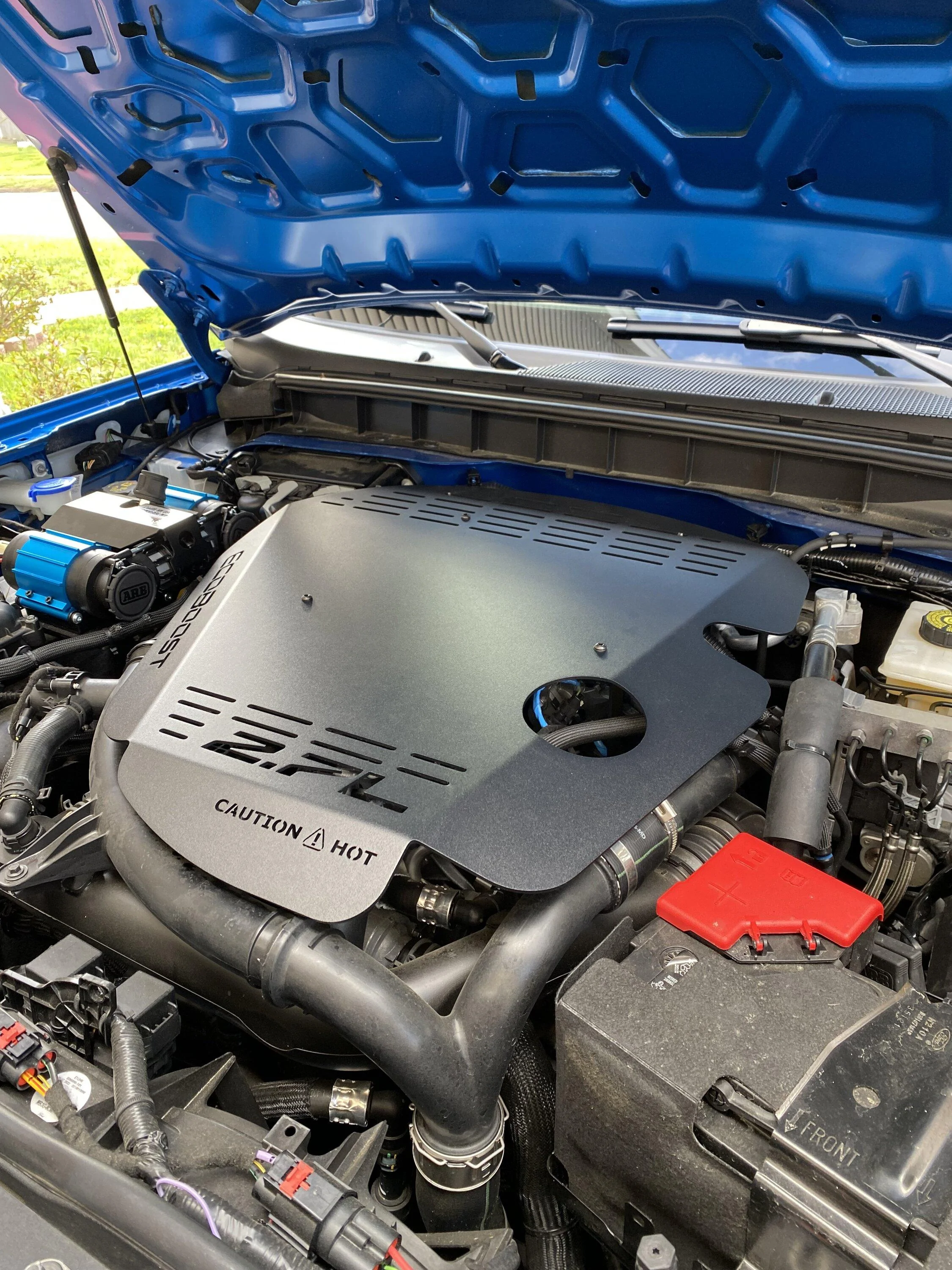

Mine was doing the same thing on my 2.7. I ended up trimming the front of it a bit to give it more clearance. Pic is before trimming. It was basically touching the pipe and would rattle like crazy and make a pretty obnoxious noise. It's been fine after trimming.
