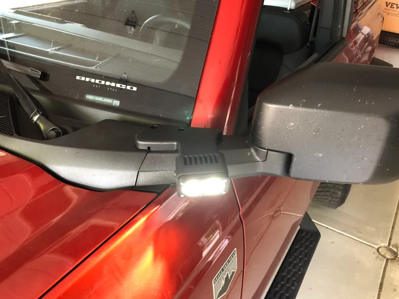

As a supplemental trail/dark road light, these are hard to beat. Proper low profile placement away from the hood, vertical adjustment, great light pattern. BluMak3D with Baja Design LED's. Bryan is a sponsor here if you look him up.

Those do look sharp and it's a super clean design! Looking for more forward lighting vs ditch lights however.

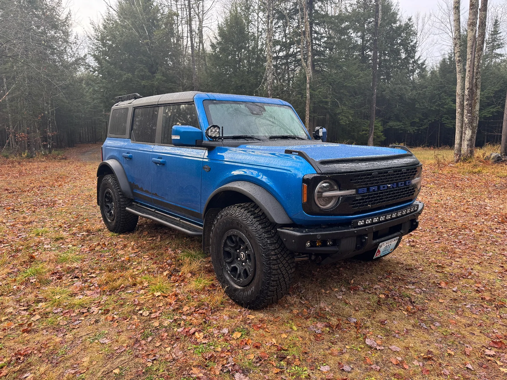

I have the M&R Pro lightbar on my bumper and love it. It provides great flood lighting. I have Baja Design LP4 Combo lights on my A-Pillar and they provide better side lighting. I also have the Bluemak3d ditch light mounts on the way that DALOLOA mentioned above for S2 Pro’s - I want to use those more for low speed driving for illuminating corners (independently controlled by side).
I guess I haven’t tried aiming my LP4’s straight ahead, but I’ve found the M&R Pro lightbar to have plenty of down range coverage for me. I more just use the A Pillars for adding to the sides of the light bar. Also, the LP4’s just look cool IMO 🤣

Appreciate your thoughts and I'm glad this setup is working well for you! Awesome looking ride BTW! I should probably just get my lightbar on first when it comes (went with the basic/slim one) and see if I truly need the a-pillar lights but it's hard to skip out on the black friday deals when they are here...and they just look cool too!

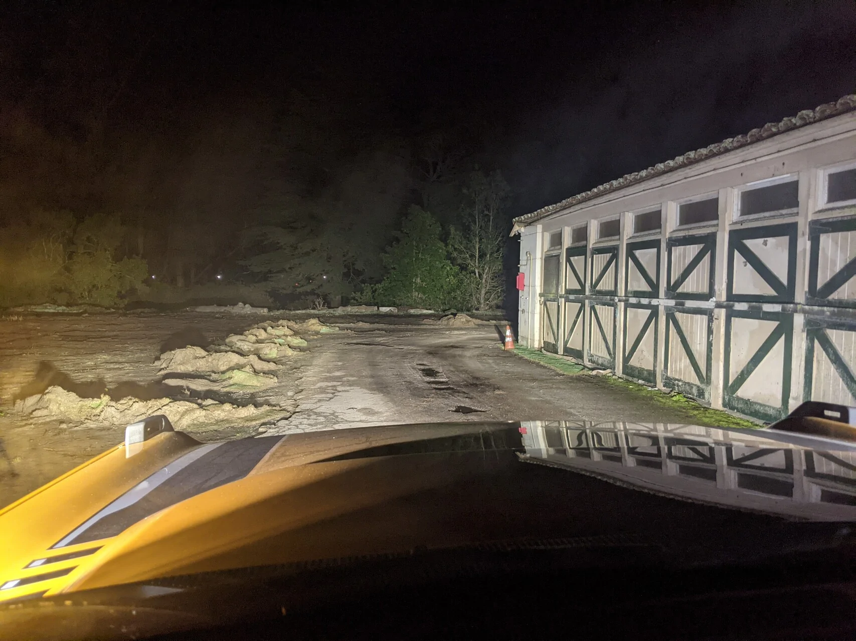

I have the BD S2 pro spot on mine....and here they are at night a bit of hood glare, but not bad, I find I get more annoying glare from any fogging on the windshield than I do the hood
Thanks for this and the hood glare doesn't look bad at all. Do you find that these S2 lights provide enough light to make a significant improvement over the headlights and high beams?
