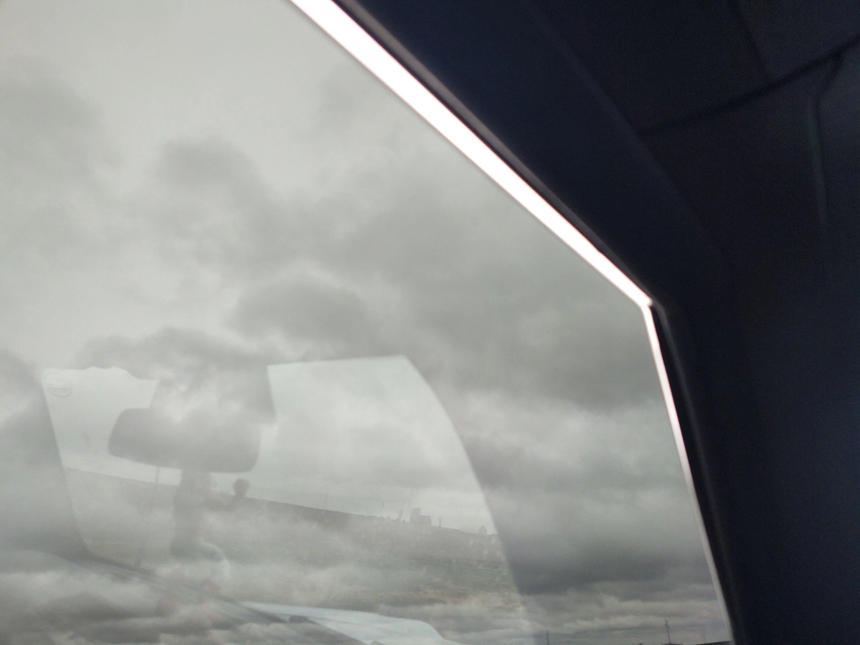

So I live in Nebraska, a wind hole where 20-30 mph winds are very common. Took the Bronco on its first road trip and ended up driving west on the interstate with a 20-30 mph cross wind coming directly out of the north.
Probably the most miserable drive I've ever had.
Driver window constantly popped open, pulling away a good quarter inch with wind noise so loud couldn't hear anything but. Stopped multiple times to reset window, kept happening. Ended up having to drive 2 hours with this nonsense. Thought the window was going to tear off with a few of the heavy gusts.
This is a game changer for me. I've had multiple frameless window vehicles and never experienced this. A few whistles during gusts but not the window pulling away and fluttering in the wind. Wind is not going anywhere but this Bronco sure will if this is the norm.
Has anyone had this happen? Is there a fix? Search only keeps bringing up the reset thing but that's not the issue. More like it needs to angle in more to catch the seal, or more up pressure at closing?
Here is a picture while driving.

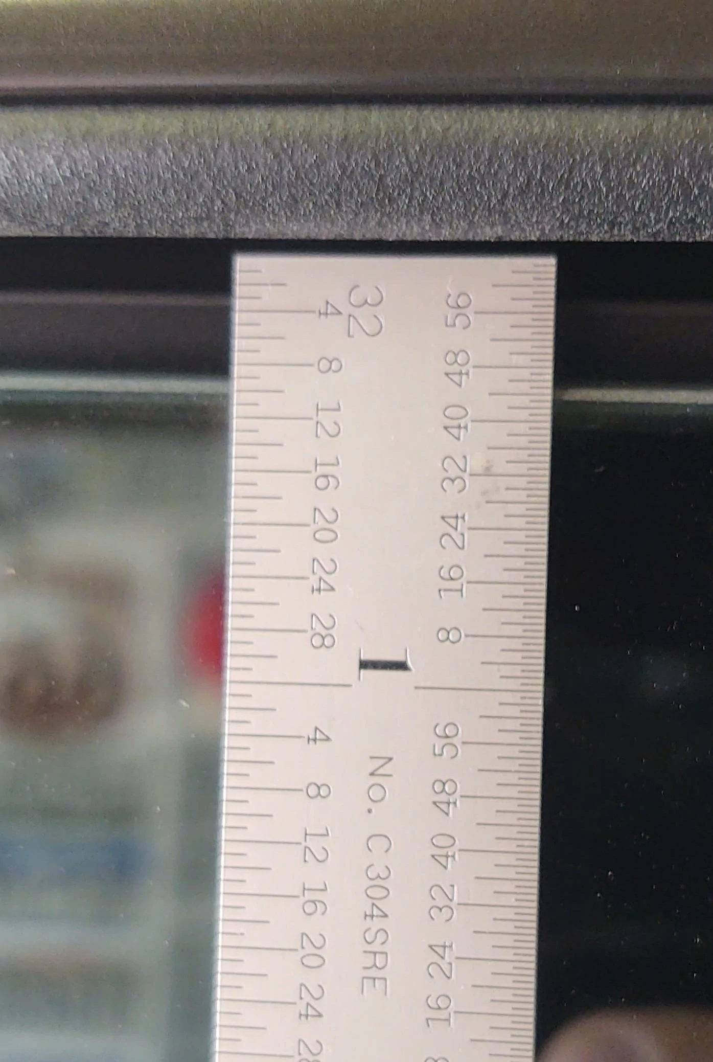

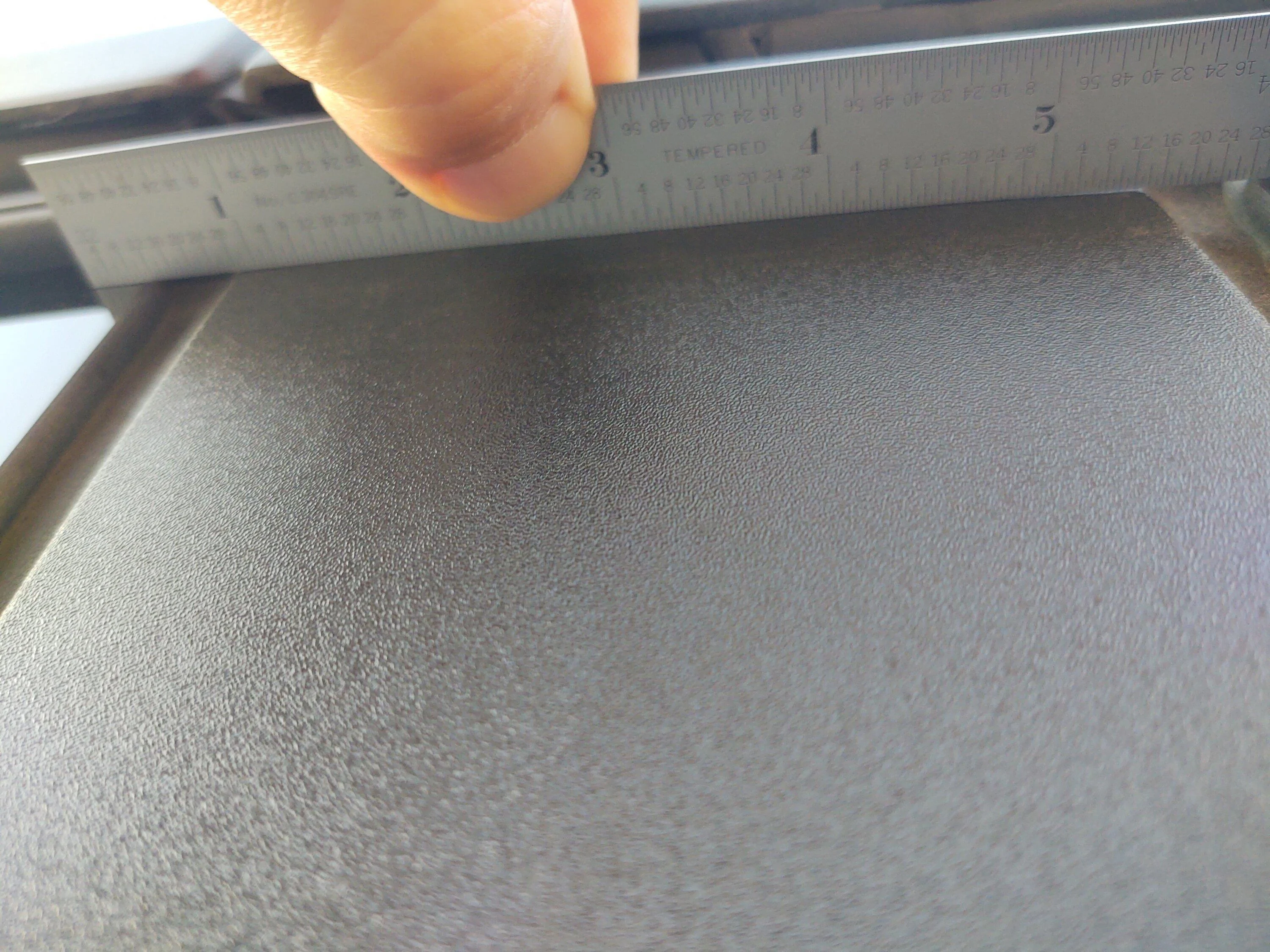

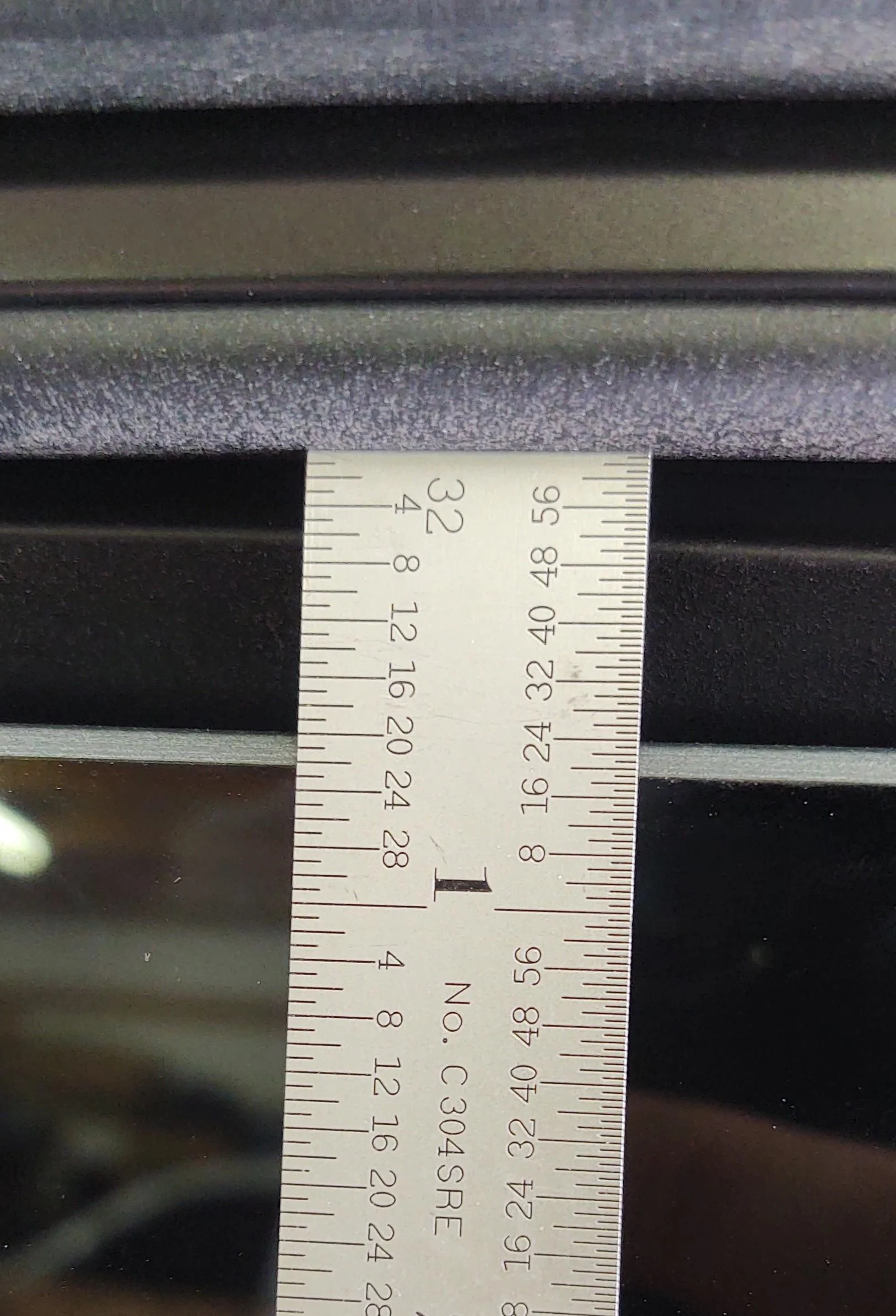

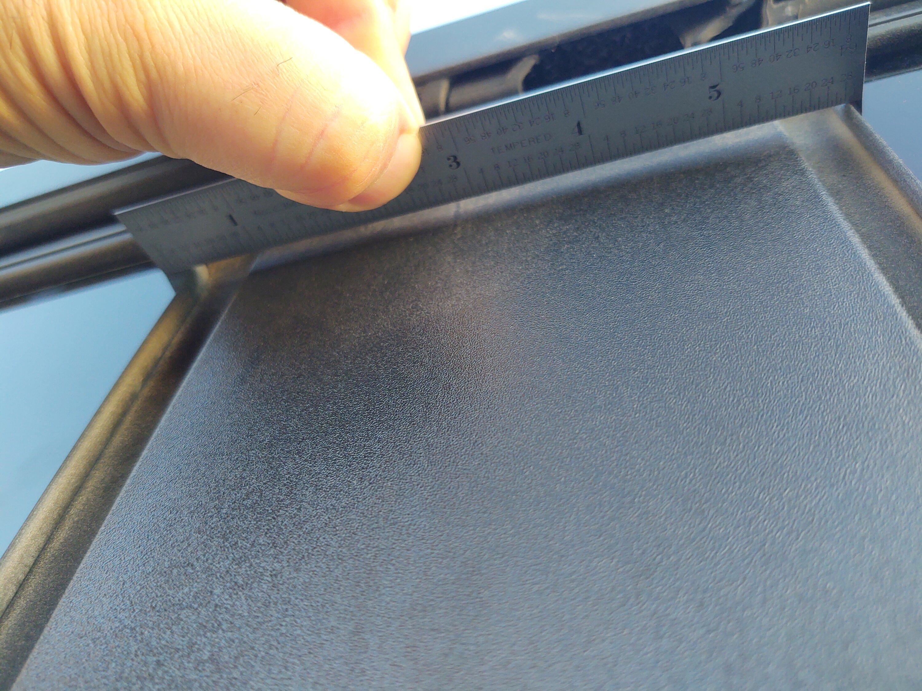

Looking a little closer check out the difference in the open door down position, door just cracked open but still latched.
Driver
Ford Bronco Driver window unsealing in wind IMG_20230416_171841160
Passenger
Ford Bronco Driver window unsealing in wind IMG_20230416_171907751
Then check out how the driver side windows are tilted a bit outward, a gap between the B pillar on the driver side Vs flush on passenger.
Driver
Ford Bronco Driver window unsealing in wind IMG_20230416_195737447
Passenger
Ford Bronco Driver window unsealing in wind IMG_20230416_195807212
So shows me the window on driver front needs adjusting upwards, plus both need tilted inward. This is a Ford problem, going to call for a dealer appointment. Supposedly the Mustang has had same style window? Surely Ford techs have to have seen this before right?
